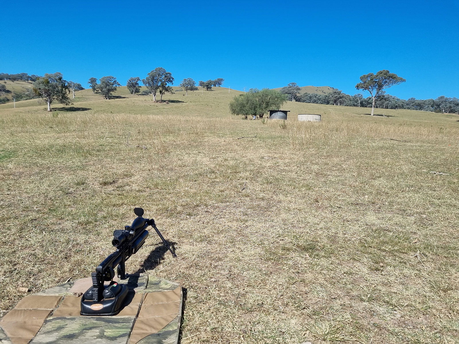

FX Has anyone been able to get their FX to shoot slugs MOA at 100 yards?

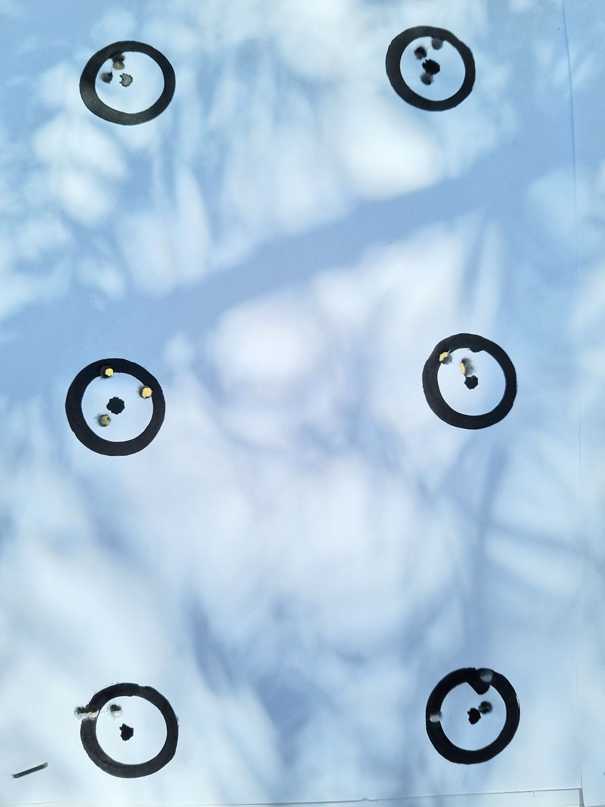

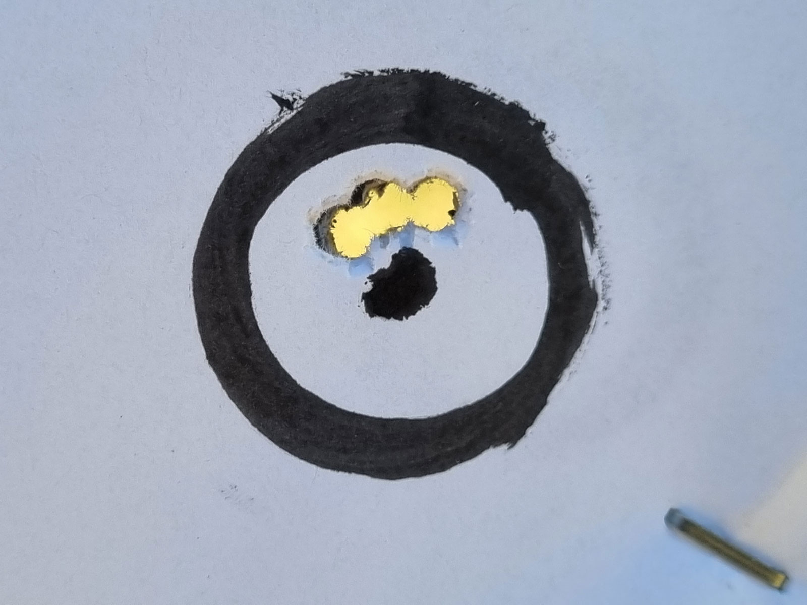

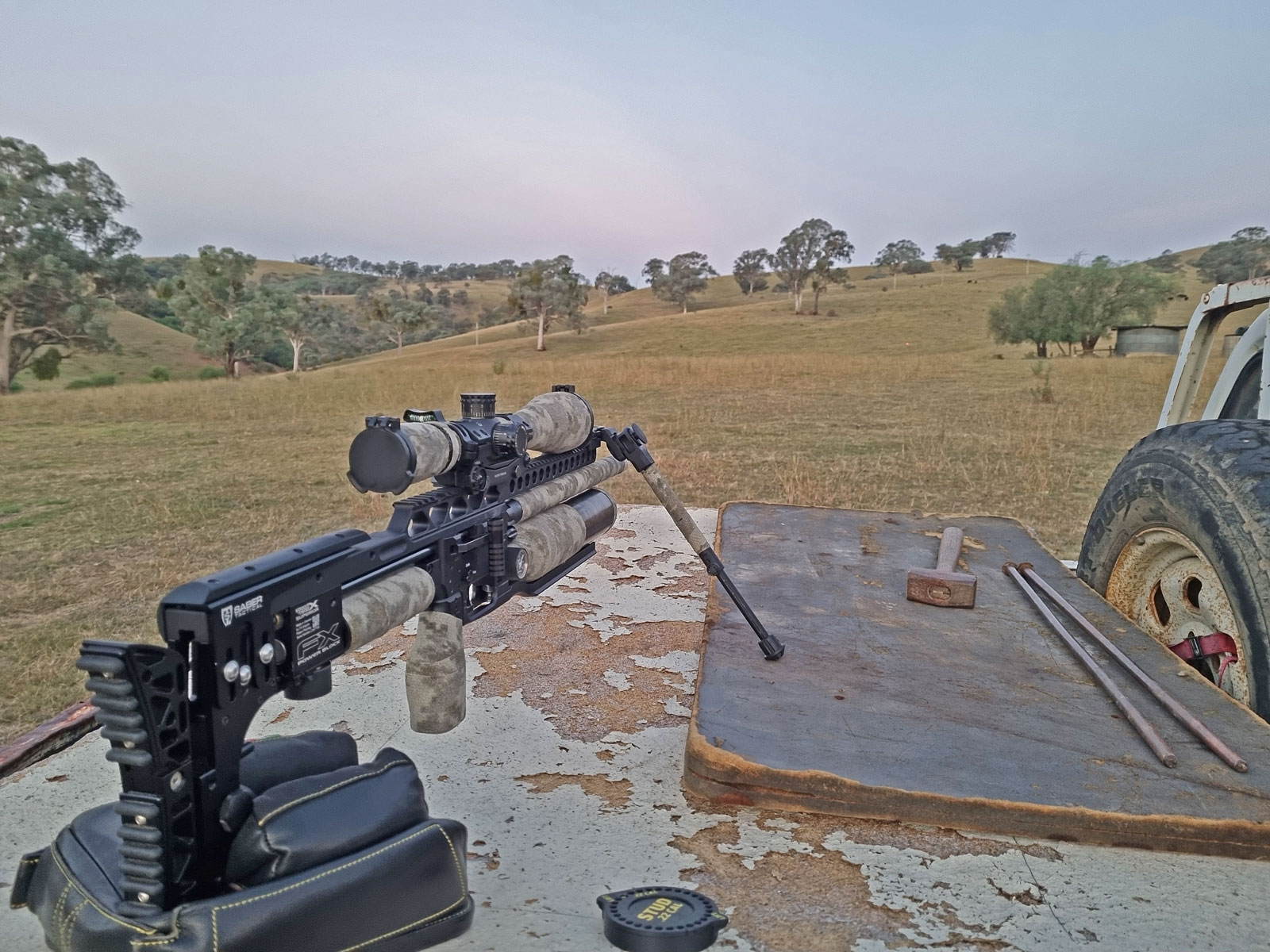

It can be done
This arvo...
110yds
Gentle undulating breeze..

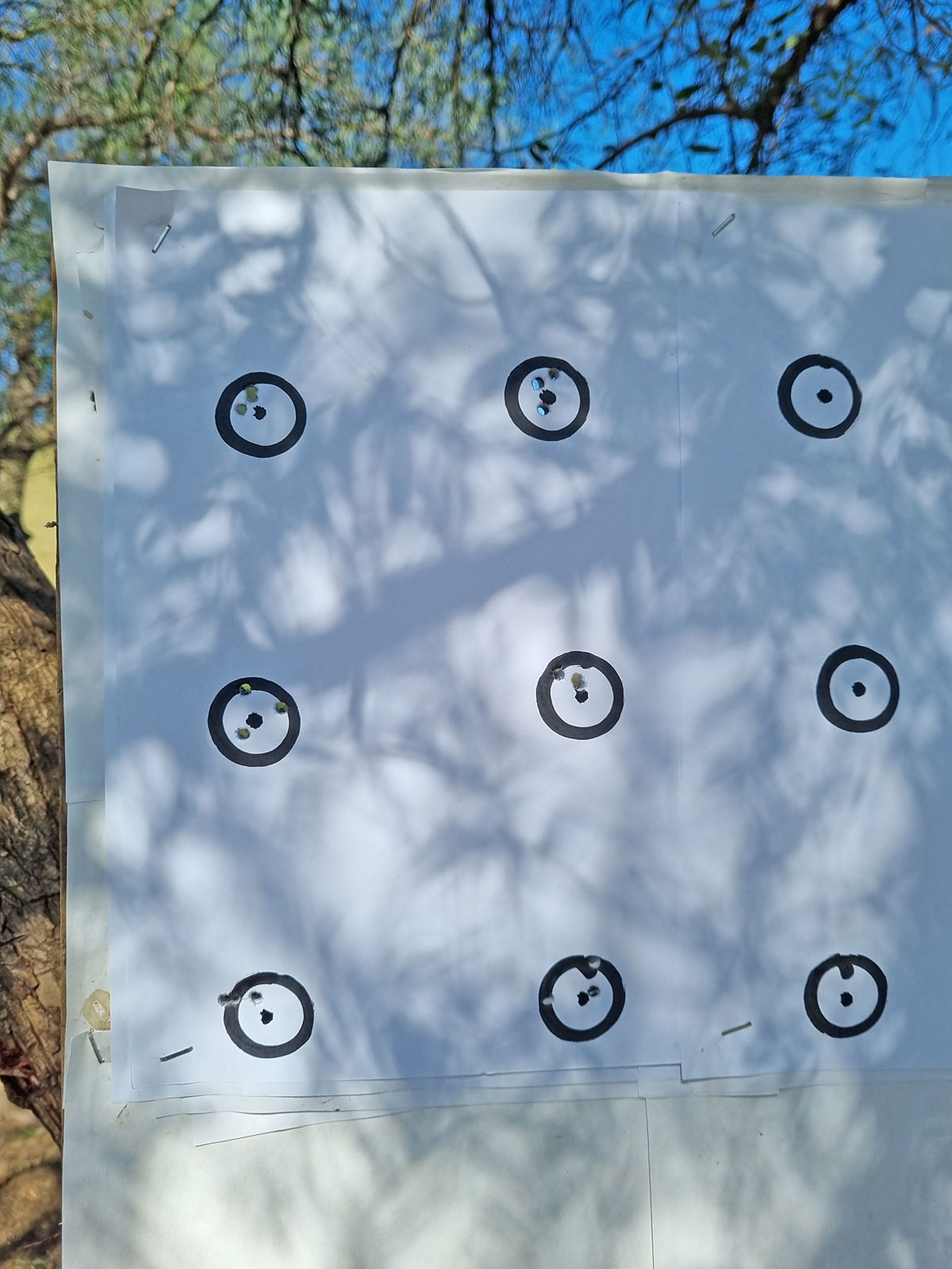

Main target ... 6 consecutive 3 shot groups..
.....and 2 exceptional groups.... 3 shot and 5 shot same 110yds distance...
Using NSA 27.5 218" Slugs @ 1060fps..

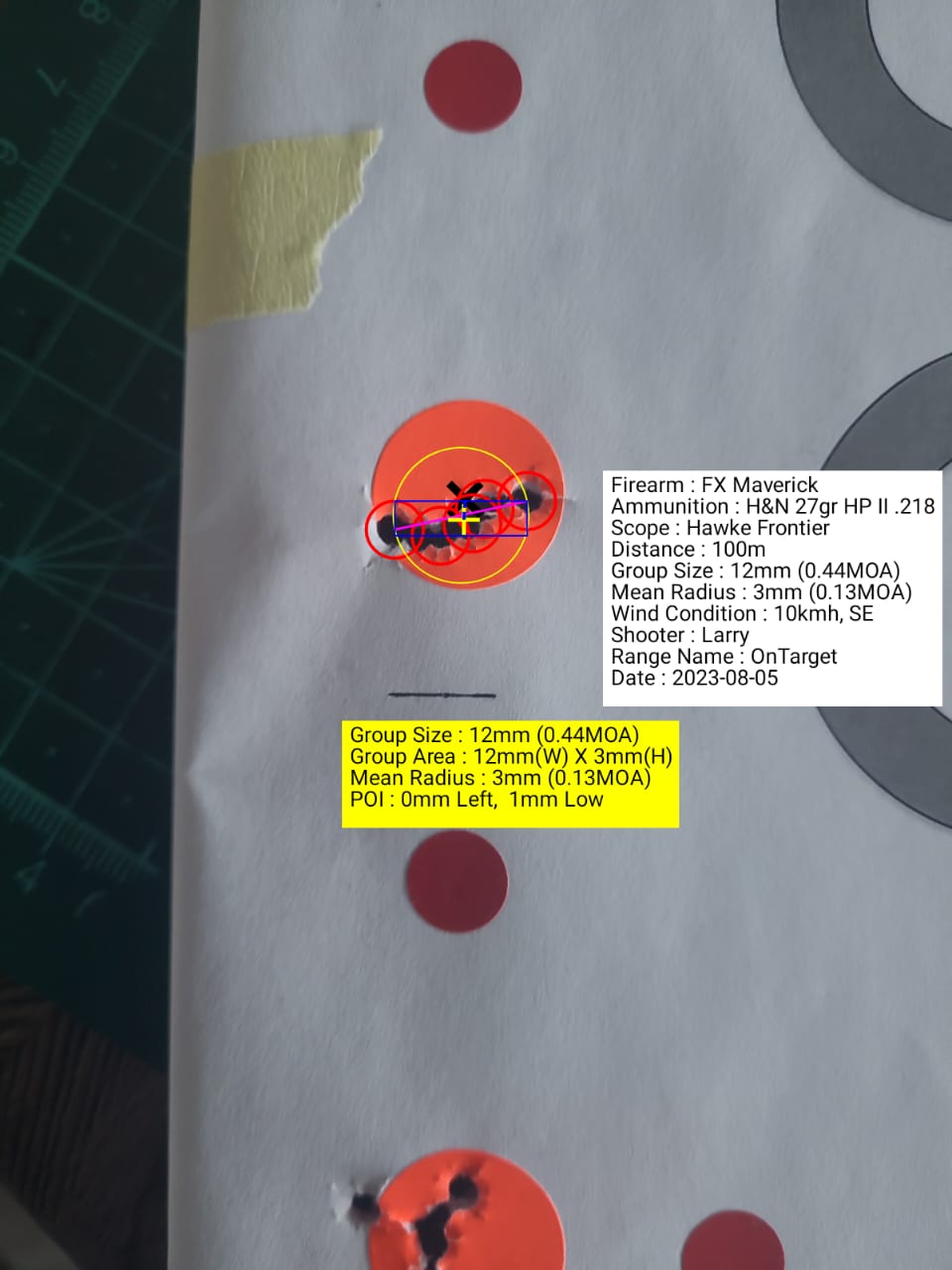

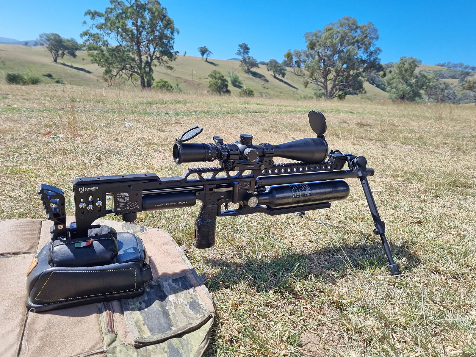

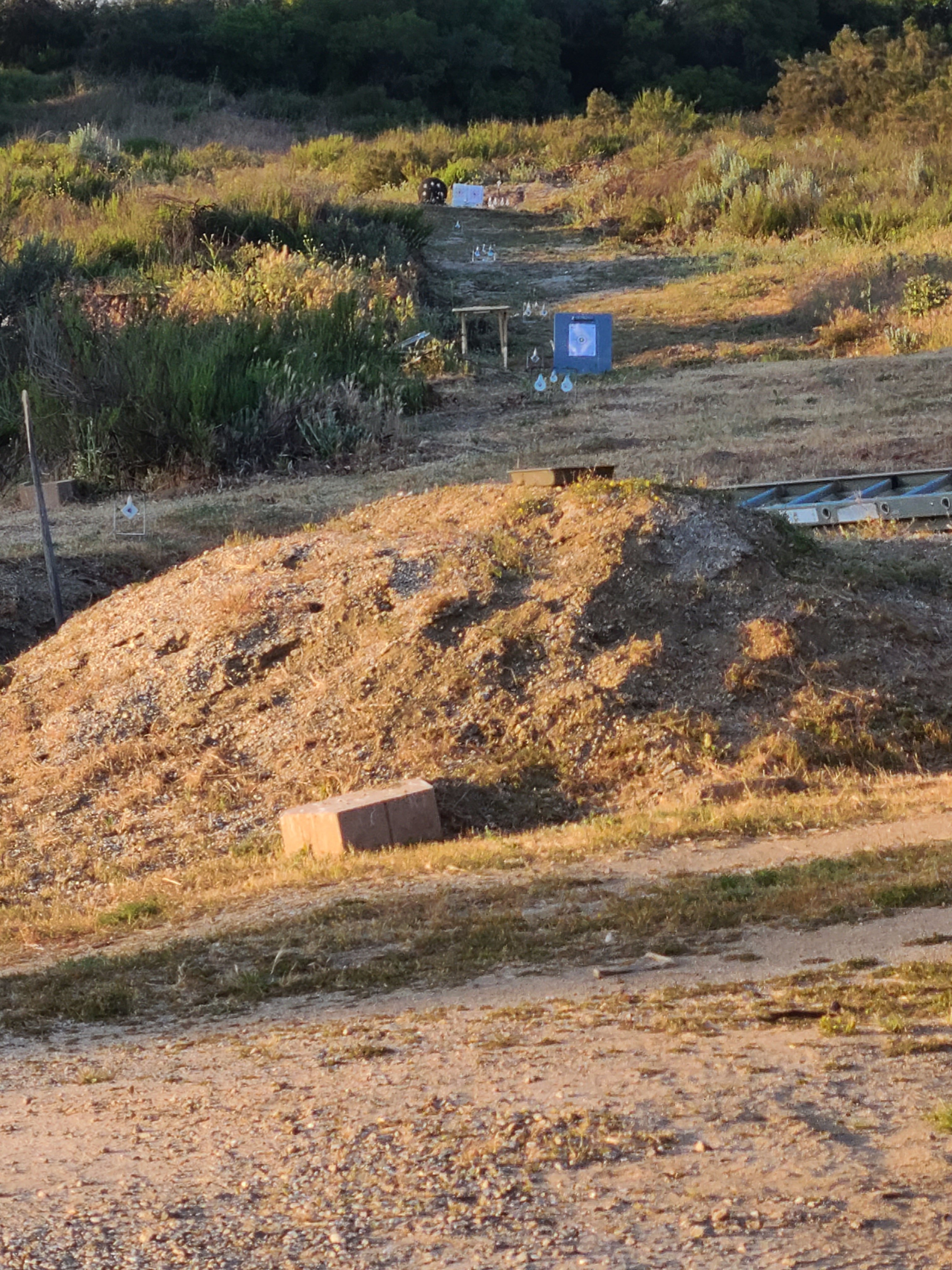

100m(109 yds)

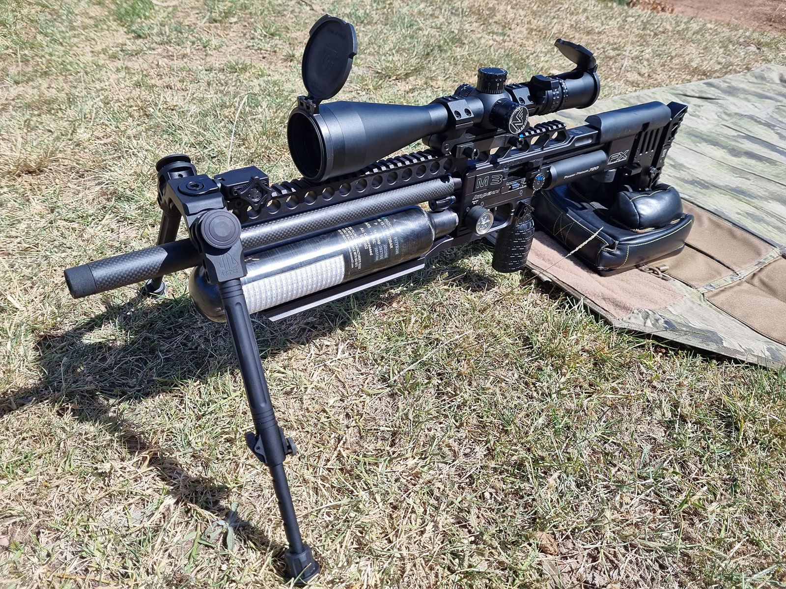

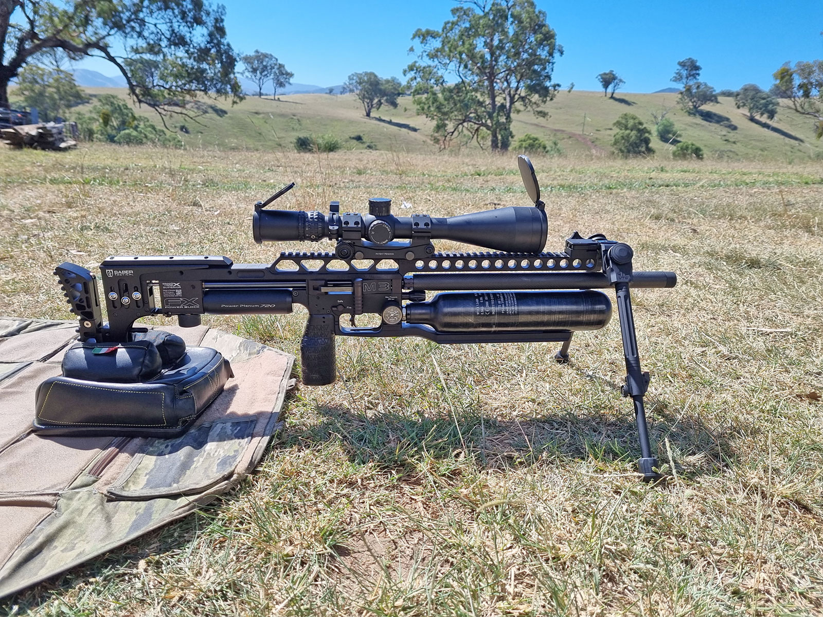

FX Maverick 700mm .22, DonnyFL Ronin silencer(best barrel harmonic tuner there is :)
H&N 27gr .218 HP2 Slug @ 995 - 1005fps
Best 5 shot group to date, but almost always about +-1 MOA under good environmental conditions and from bench, front of rifle on tripod and rear of rifle on Sabre Tactical Bench Monopod.

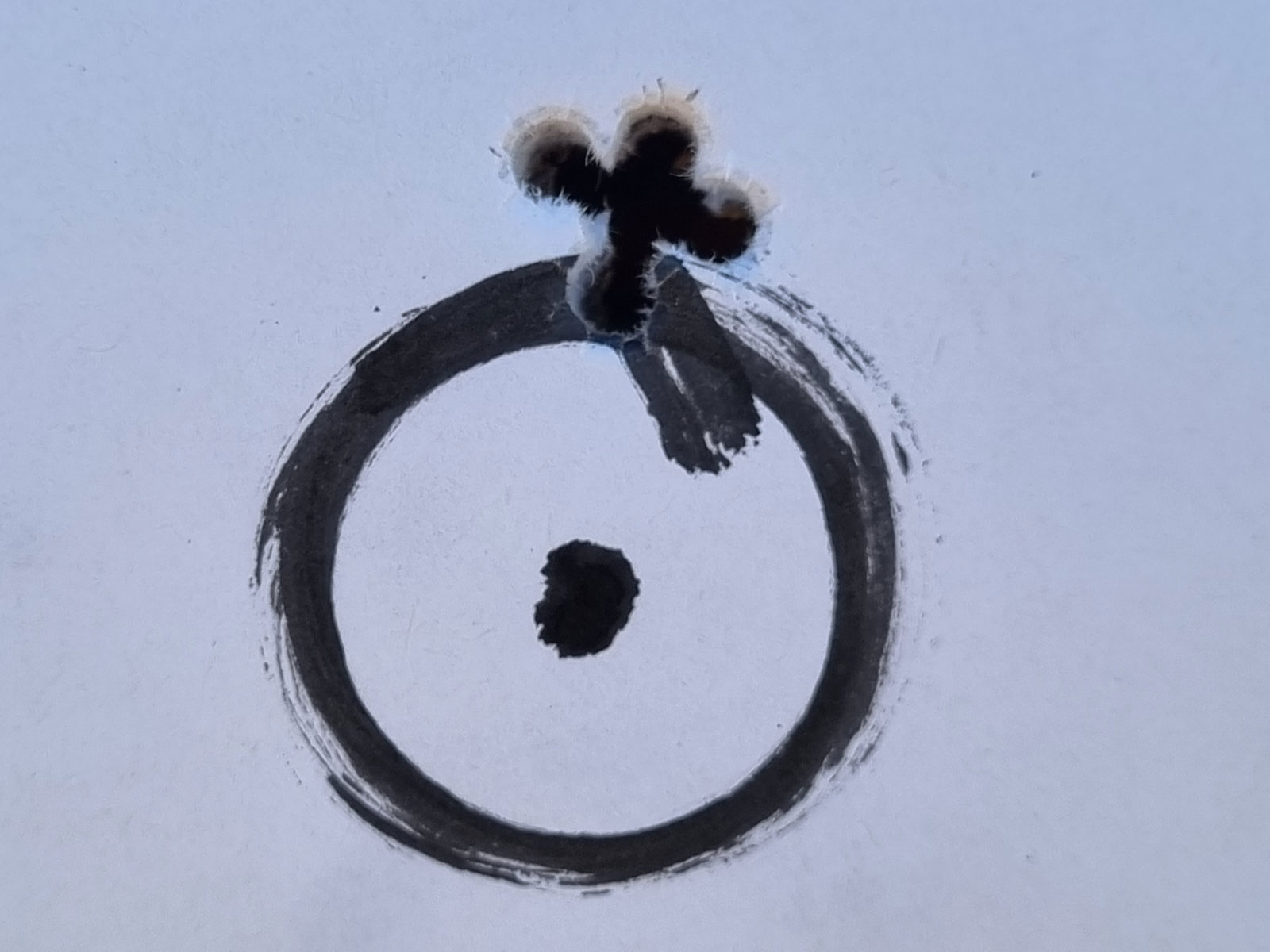

Group at bottom of pic(not measured) is definitely sub MOA @100m, sticker is 25mm diameter:
It can be done
This arvo...
110yds
Is the reason you don’t run a moderator due to better harmonics?

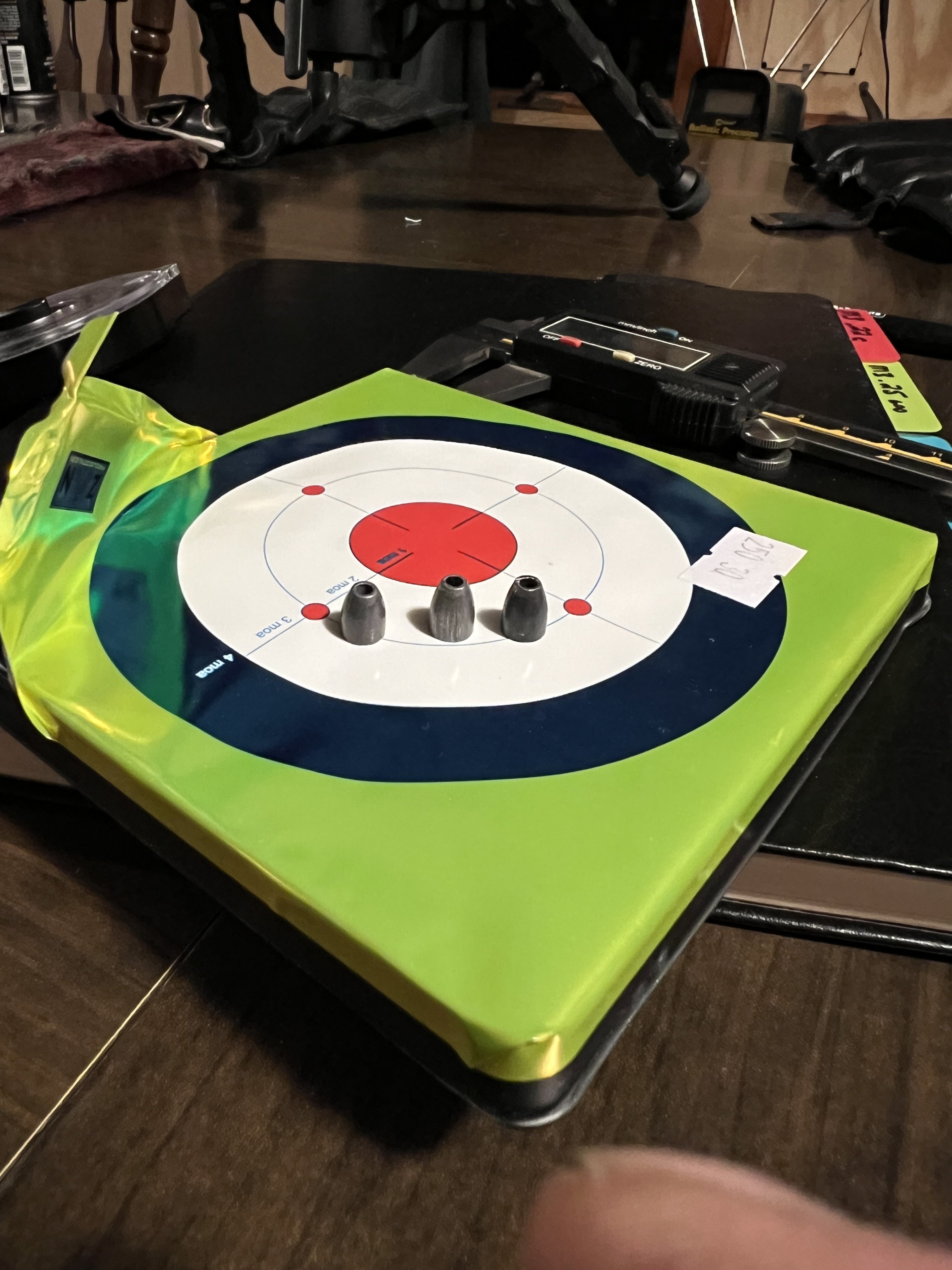

Ok, it just got even more interesting. Opened one of the latest packs of Zans that I received. Now we have new packaging and a third length. These are 7.94mm long. So my question to all the stellar slug shooters out there is, how serious or knowledgeable is a company like Zan if they think they can do this and customers can enjoy exceptionally consistent accuracy. I promise you that you can’t when you are not feeding your gun the exact same thing every shot. All of these Zans were bought within the last month. Three different freakin lengths in the same weight. And guys wonder why MOA is elusive.
Griffins are a little spendier, but the quality is worth it.
What liner Twist Rate? ;)
Std liner that comes with the 700mm version....
My whole Barrel liner, Barrel tube as well as custom machined spacers for the 2 carbon tubes a permantely bonded together...the whole "Barrel Assembly" is effectively one piece..
There is NO tension on any part of the barrel assembly.

Superior @ 1:24, I find this liner best overall, including and up to 30gr H&N HP 2 slugs, I don't shoot heavier than 30gr.
As a side note, I find the 27gr H&N slugs to have a higher BC than 30gr H&N slugs, measured purely by POI on target at distance compared to what Strelok would say I need. This with 40m zero and using factory BC values.

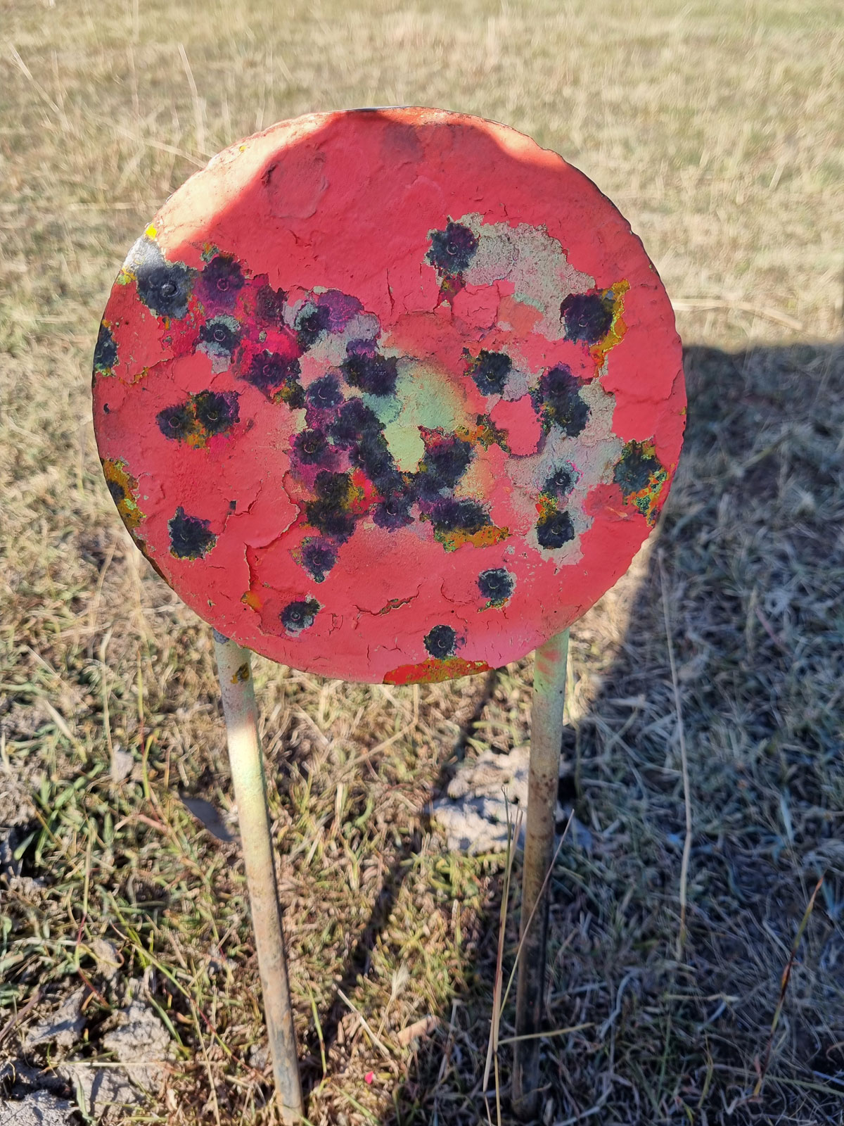

I tried SO MANY DIFFERENT SLUGS…ran thru many different types and yet I was never able to get MOA at 100 yards with repeatability (my most accurate being the FX Panthera, but with a self given score of 7/10 in terms of repeatable results at 100 yards).
Has anyone been able to do this with their FX and have it STAY a laser beam with slugs at 100 yards? If so, what slug, gun, tune, and barrel length?

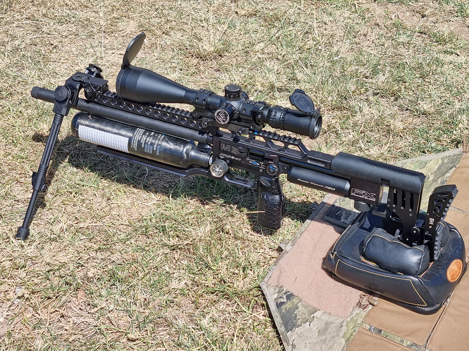

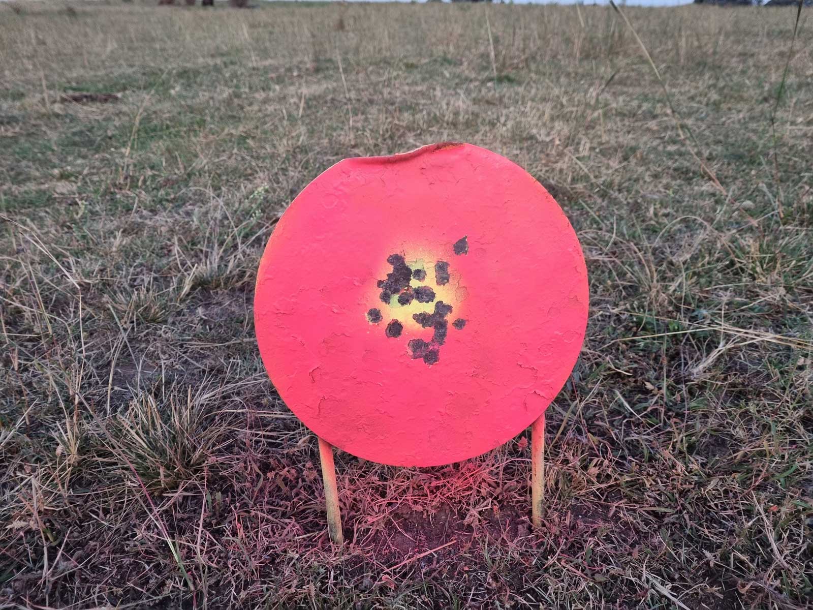

4 10 shots groups to 100 yards 0,92 MOA average with FX Impact M3 .22 800mm 1:16 barrel
2 10 shots groups to 150 yards 0,95 MOA average with FX Panthera .22 700mm 1:16 barrel

Sadly Steve, I’m almost getting used to it. The airgun industry is just a little sloppy with their tolerances and it causes issues for guys like me. With pellets, they can get away with it and have for years. With slugs I have shot so much unnecessary lead because something was a couple thousandths off. I wish I could be a “that’s good enough“ guy. I think the industry has us almost there if you put in some work or buy certain platforms and use what other guys discovered works best. Then just accept what the gun is capable of and make the most of it. There are better slug gun platforms than others but if their ergonomics don’t appeal to your use, then you have more work cut out for you. I could buy a Panthera and have a better starting slug platform, but I’m not interested in running around in the woods with a harpoon gun. It’s a hobby within a hobby and I try to not get too mad at things like this. I kinda expect them now.

100m(109 yds)
My Impact likes that same ammo. 600mm, superior liner, 960fps.
