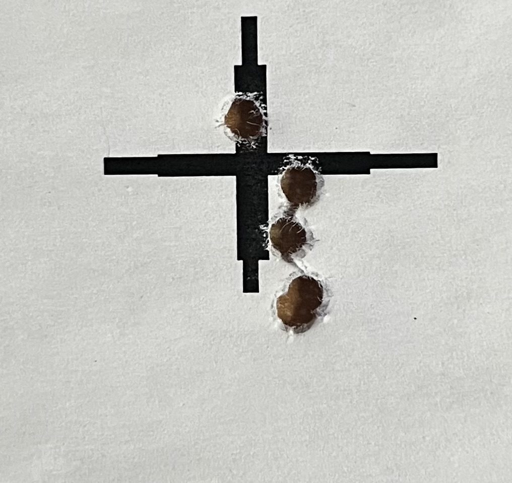

I have a good friend and one of the best shooters I know. Decided a short while ago to try .25 Altaros ATP Smooth. His shooting buddies convinced him to try 990, then other lower speeds above 950 fps. He emailed me and I stressed fast is not good with these. He lowered to 920 and said it got much better then he went down to my suggested 900 fps and shot the below 5 shot group at 100 yards with .25 Superior Slug 1:16 twist. Hard to beat that!

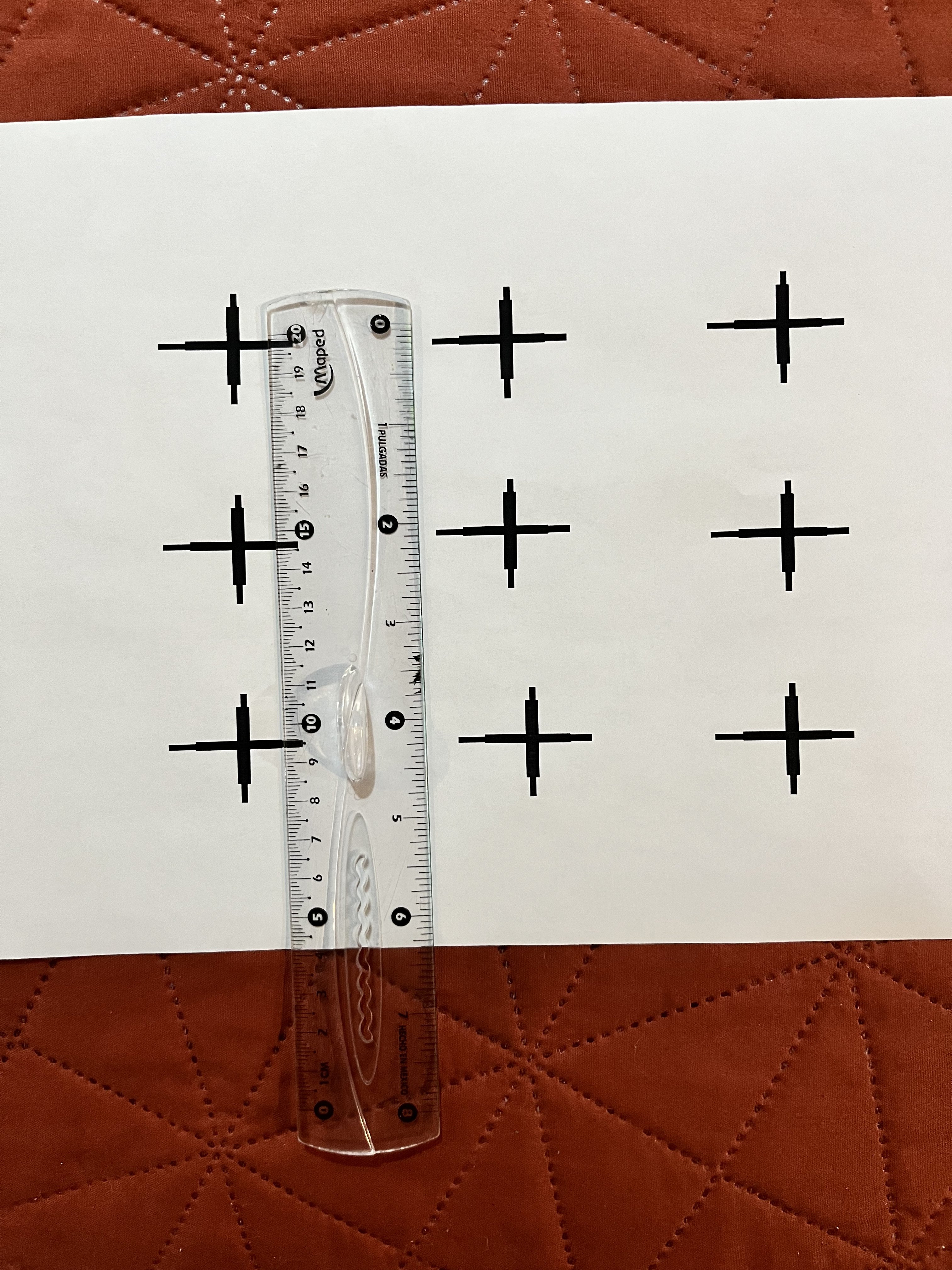

I have achieved. Here is a 1.46 group at 150yds.
M3 700mm .22 Std barrel, slug port, Brass hammer, 150/125 regs, 16 mac, 4.75 mic, -1/4 turn from max valve, 935 fps, H&N HP@ .217 30gr.

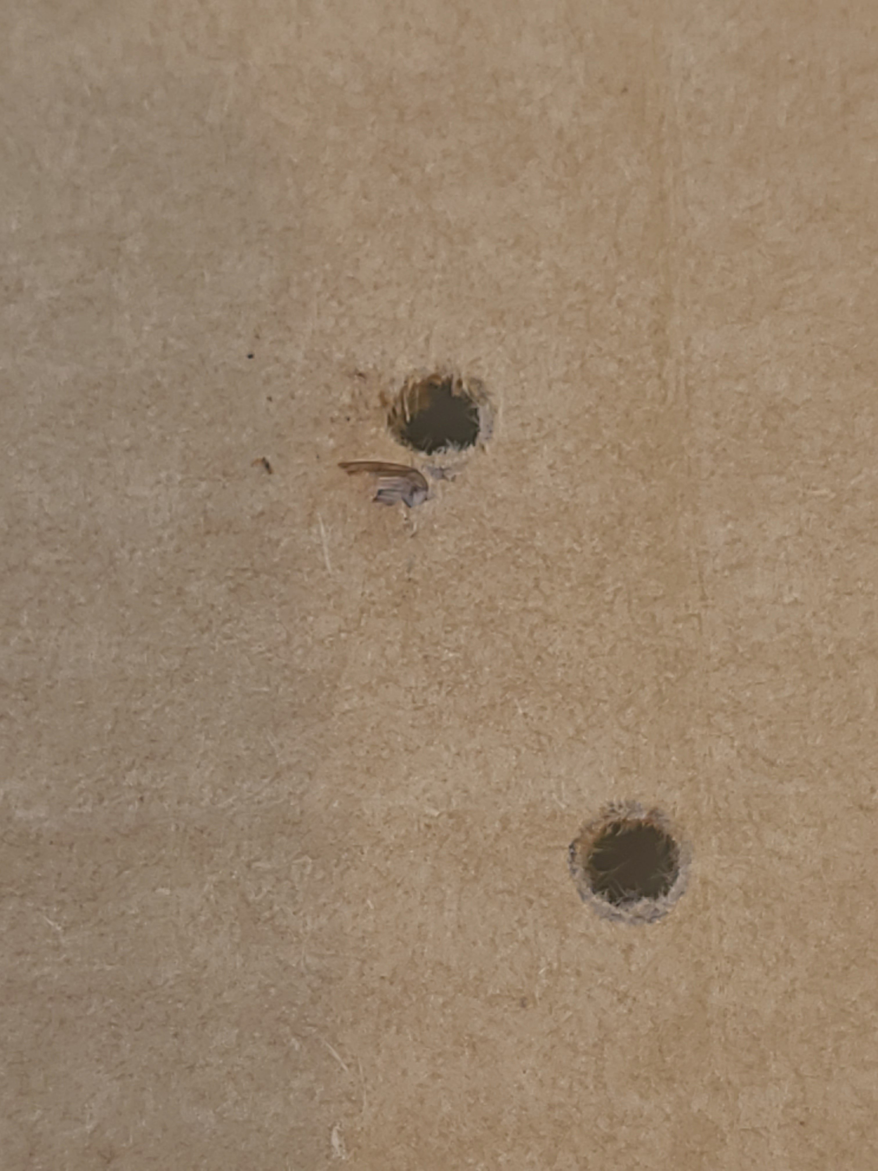

Pic 2 is just for fun, As suggested from another member, shooting flys:p, I got one at 50.(upper hole)
