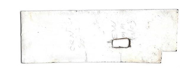

This is a template of the trigger block. I use it to show approximately where I make the slots for the flat steel used for the trigger iron adjustment. I just drilled 2 holes side by side then filed the slot out.
The notched corner is the locator notch for the trigger block. The small rectangle is where you make the slot for the flat steel used for the trigger iron adjustment screw.
The set screws come from the bottom (trigger side) up to hold the flat steel in place.
