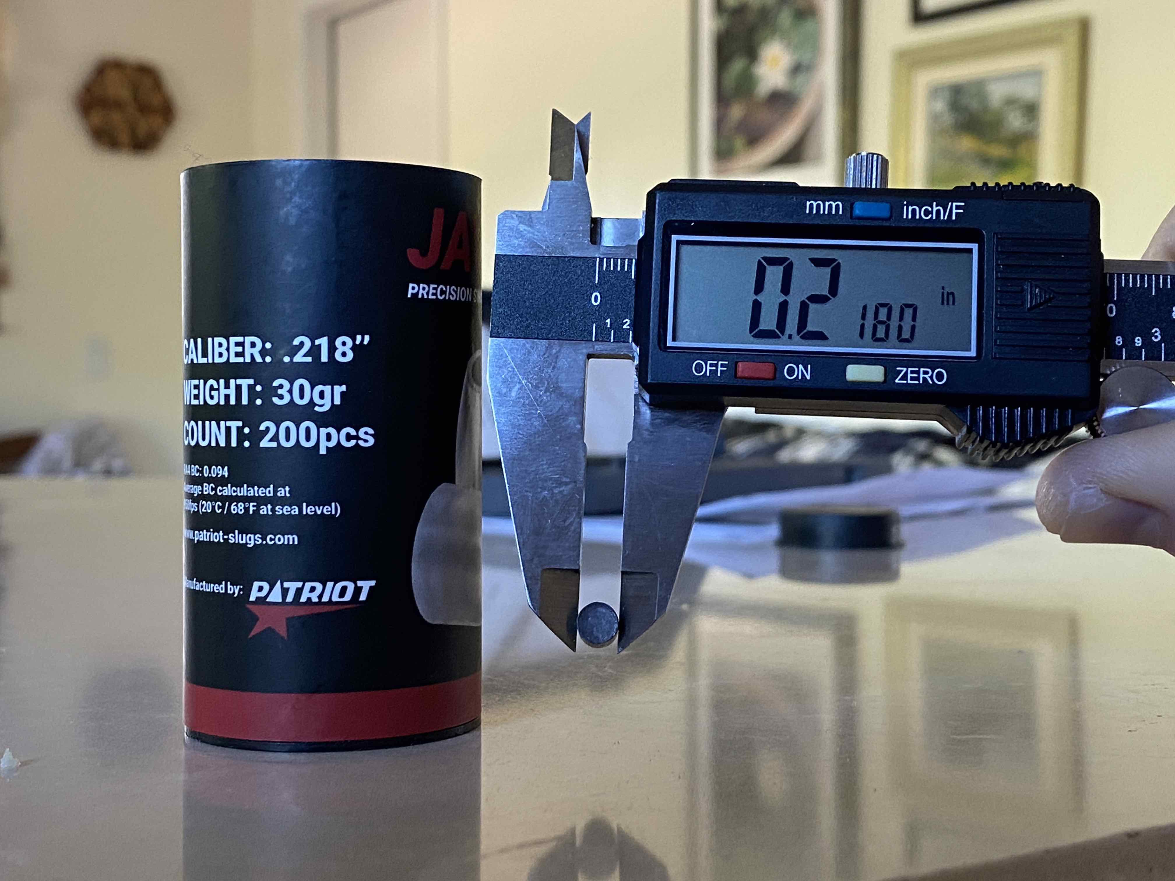

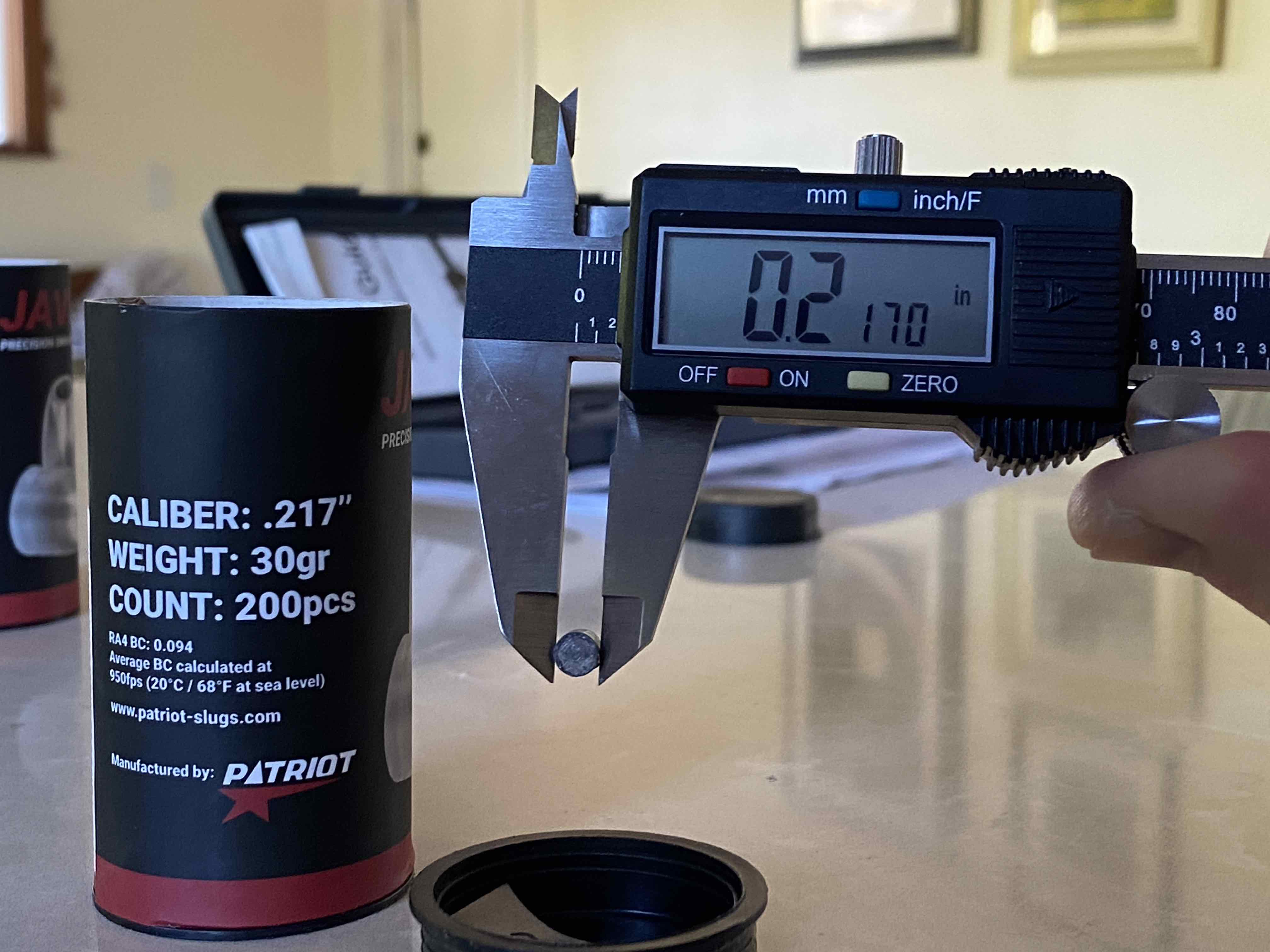

Do the slugs actually measure .001” larger?
David
David
I just measured ten of each and they were all the correct diameter.

UPDATE:
It seems that I may have gotten a container of .218s that was mislabeled .217s, or something else was off. Or maybe it was some sort of user error on my end. During the shoot this thread is based on, I finished off that container of .218s. Yesterday I opened a new container of .218s. Those are the ones that I measured with the calipers in the photo.
I shot the new container yesterday and immediately noticed a difference before I even fired: I needed to push harder on the lever to seat the slug into the barrel. All of the shots were 20-30fps slower, and the groups opened up considerably in comparison to the .217s. I'm guessing that the .218's decrease in speed is a result of the increased friction in the barrel. Some people have reported the .218s shoot faster than the .217s. Not sure why that would ever be the case, unless their barrel diameter is so large that air is escaping around the .217s?
I wish I hadn't shot the whole container of the previous .218s. Would have liked to have measured their diameters.
An anticlimactic ending to the "phenomenon".
