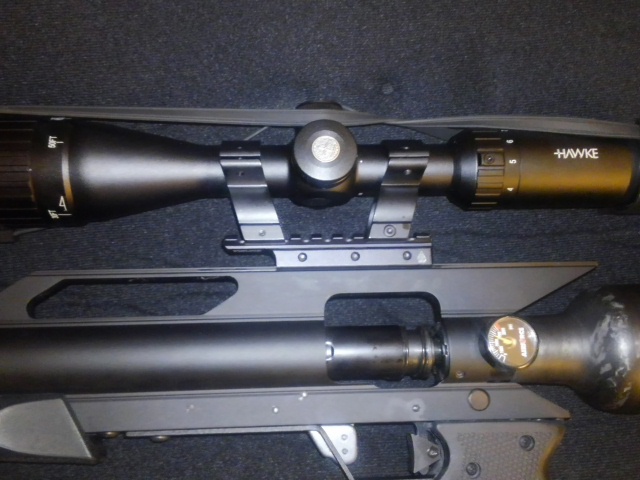

One thing I did notice is that for the scope to fall naturally at eye level for me, I had to buy a riser and get extra tall rings. I bought a riser that converted from 11mm to Weaver and then mounted a set of high rise Leupold rings. That did the trick and it now falls right at eye level.

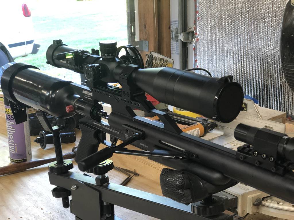

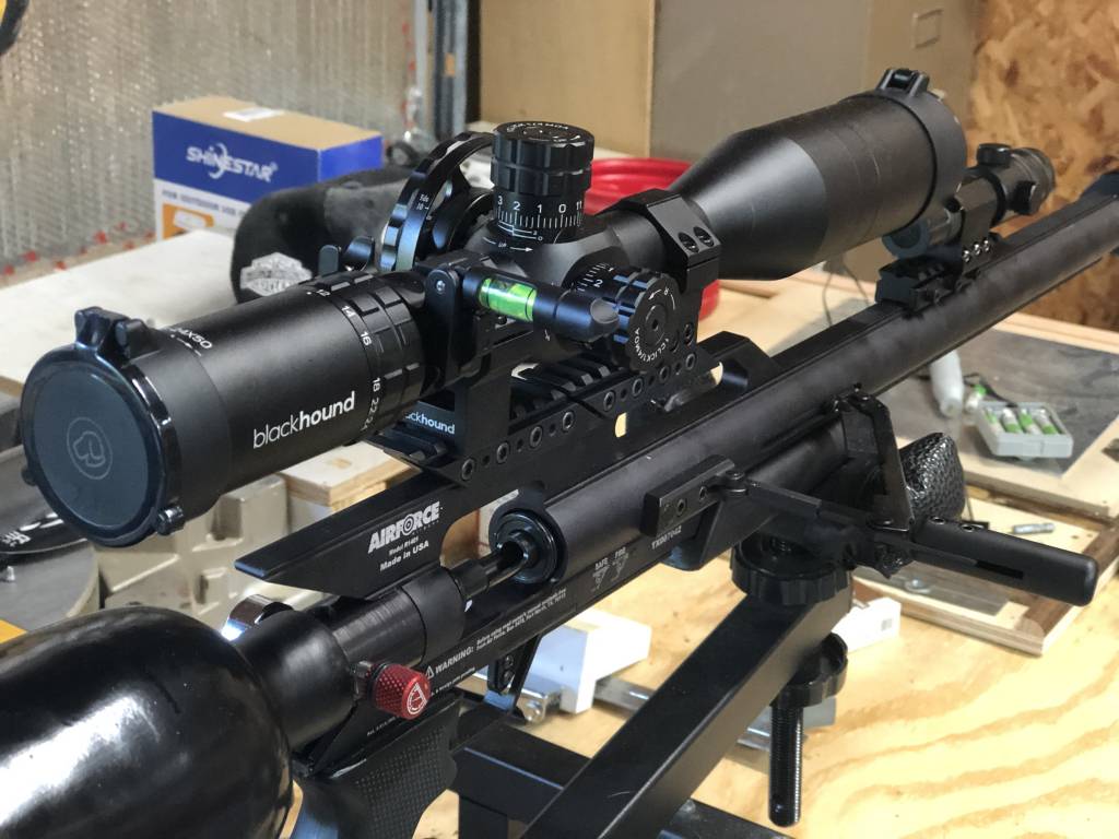

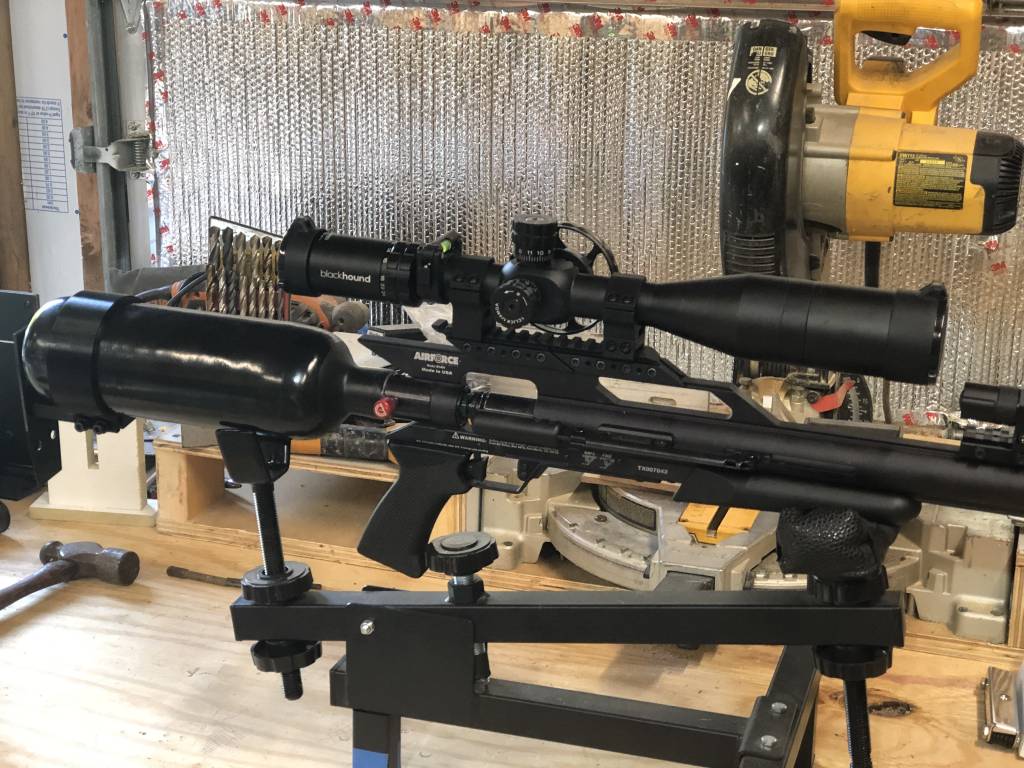

I got the scope from a guy on eBay (Blachound 6x24x50 MOA), the tank (4500 CF), and 2021 MOAV valve, Heavy hammer, and spring came from African Air Ordinance. Barska green dot laser, Amazon. Thanks
