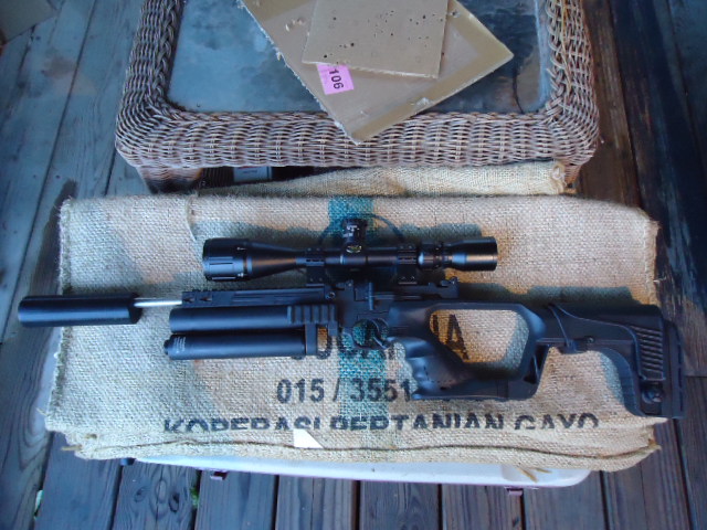

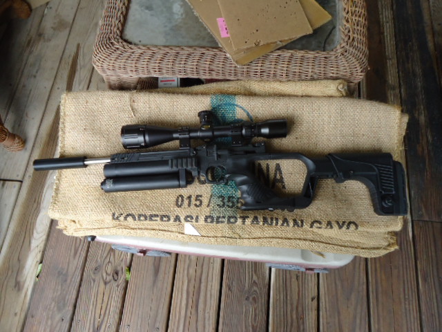

Hatsan Has anyone modded Hatsan Jet 2
I'm trying to replace the tube on my Jet1 with a longer one and install a regulator. Finding I have to get creative w the tube. I haven't solved it yet. I supsect a lot of people like you w a longer barrel would want a longer single refulated tube that can be swapped in the field.
I'm tryi g for a 300 bar tube and a 250 bar regulator. May have to rebuild the Jet1 tube with a longer cylinder, if it will dissasemble for me
Takes extra cash to just buy parts and experiment now days. I'm getting lazy the older I get. I like messing around with unregulated stuff.

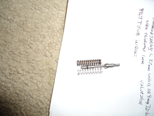

Changed out the valve spring for a weaker one. Can now hit the side of a barn!
