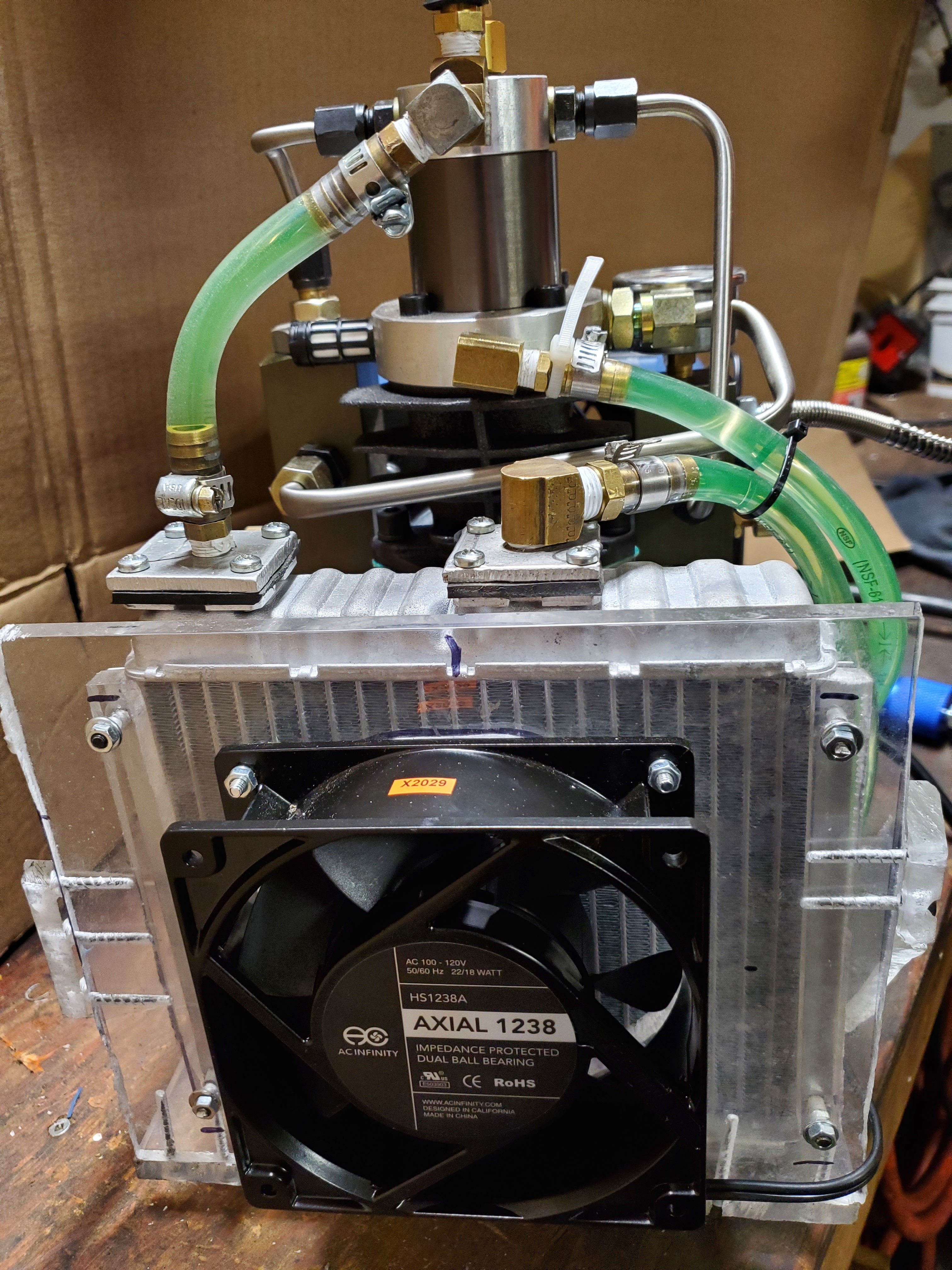

I made a closed loop cooling system for a YH, a couple of years ago, to allow me to use it at the range. It weighted close to 60 pounds, so it was OK portable, but wouldn't wish to pack it up too many stories.
The radiator I used was a Nissan Xterra heater core. If it is of value, I can offer what I used and how I did it.
I found that the closed loop cooling system was not sufficient for filling a 45-minute SCBA tank, but fine for rifles. Cooling from a water faucet was the best cooling solution that I found, for filling tanks.

Here it is mocked up which makes the parts easier to see.

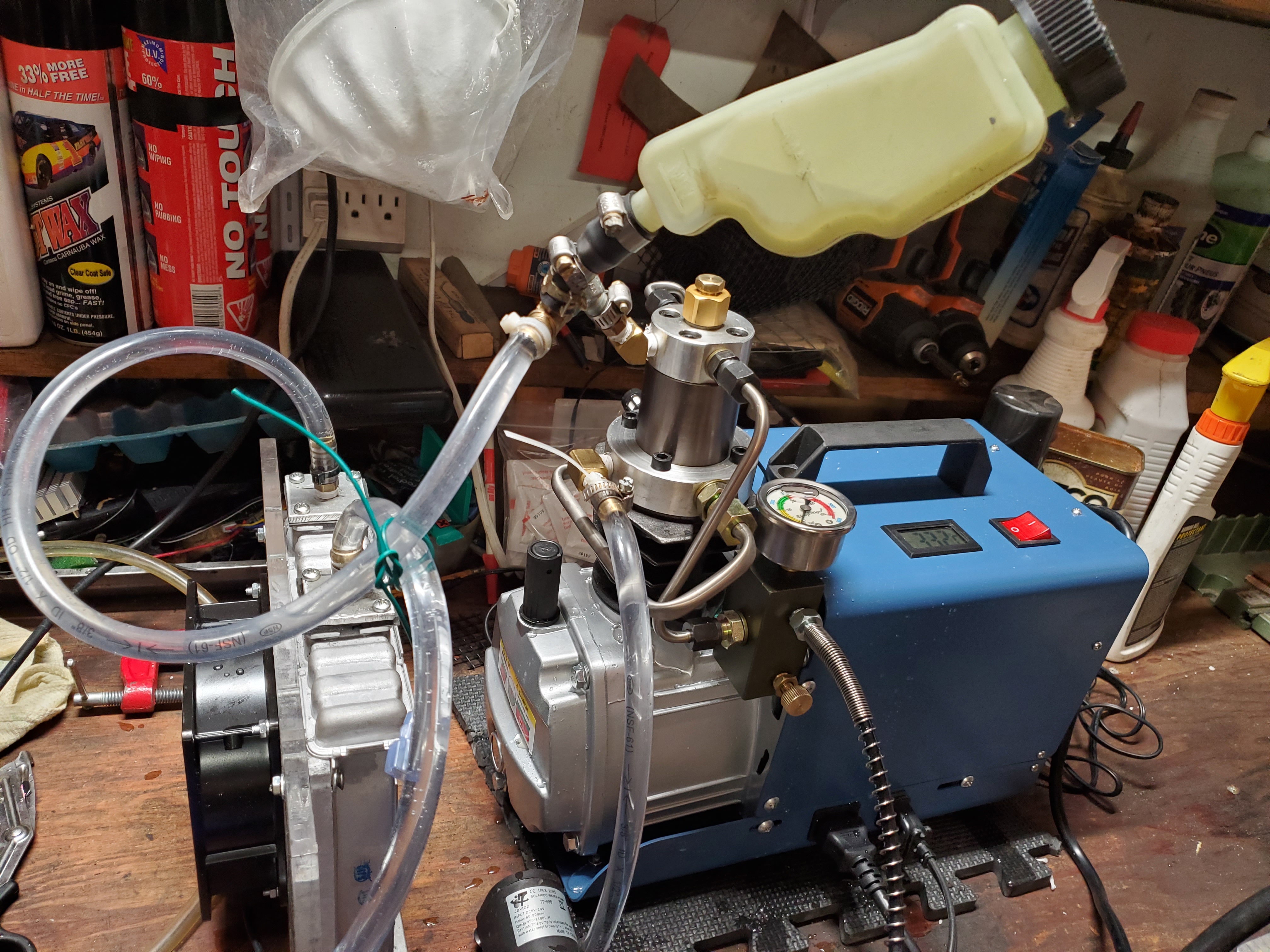

I made my own cooling mods that make a difference. no ice for me, to much added time. I haven't changed the 5 gal water since I wrote the article.
https://www.airgunnation.com/threads/2-more-yong-heng-compressor-mods-water-jacket-fan.996010/
I only need to run mine 15 max 20 minutes at a time and it never gets to 60c without a rest. I use the small filter that comes with it to stop oil and some/most water. That cotton filter gets changed every time i run it. Dried and reused. I bleed every 5 minutes or 10 in the winter when the humidity is below 20% in my basement. I have 2 towers in line 1st is a water separator 2nd is the desiccant, charcoal. i keep those pressurized for months at a time. To keep them pressurized i use a one-way fitting and a shut off valve. I only open the vent on the water separator a tiny bit to check for additional water.
