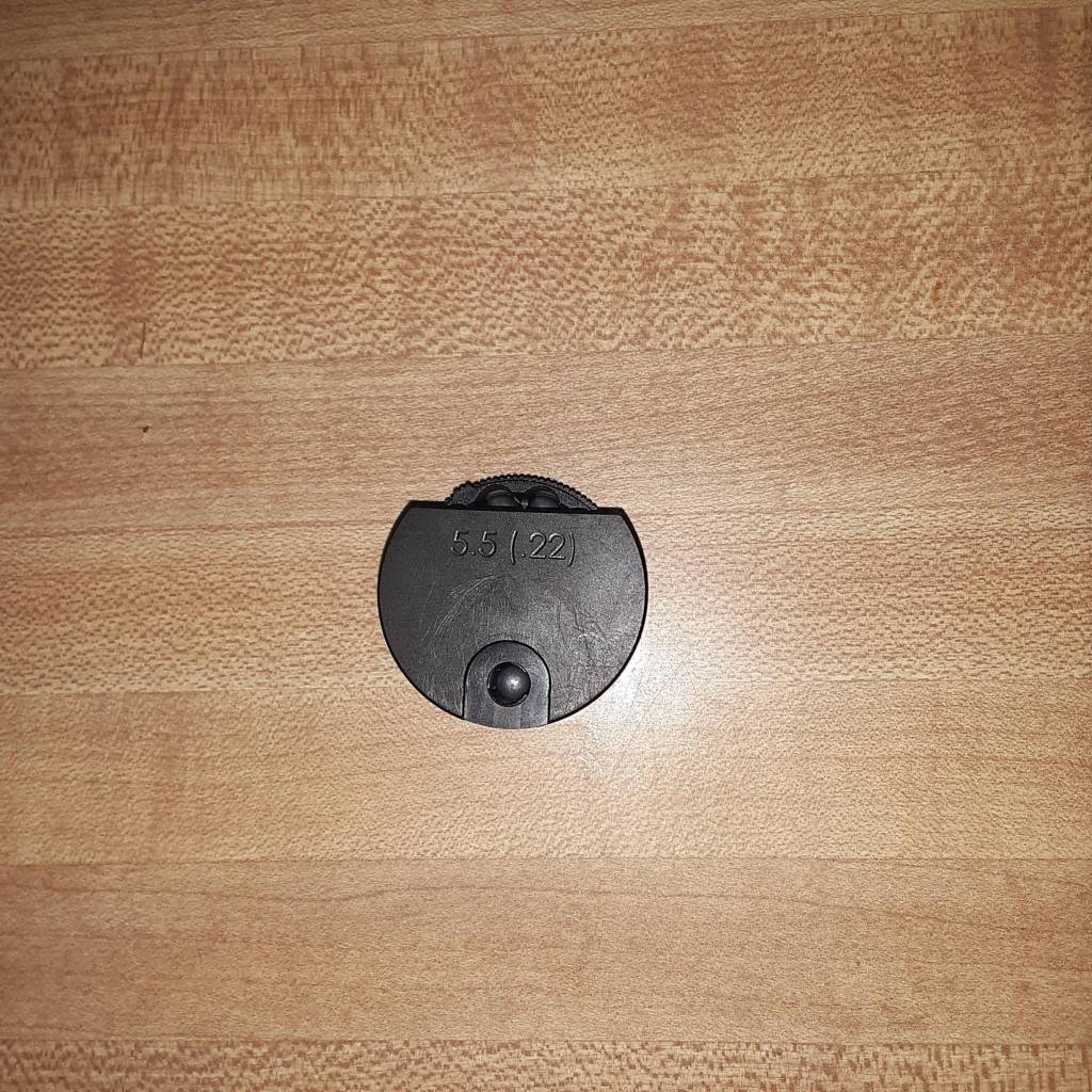

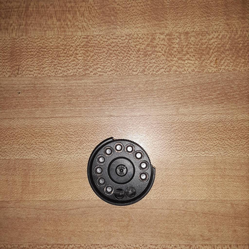

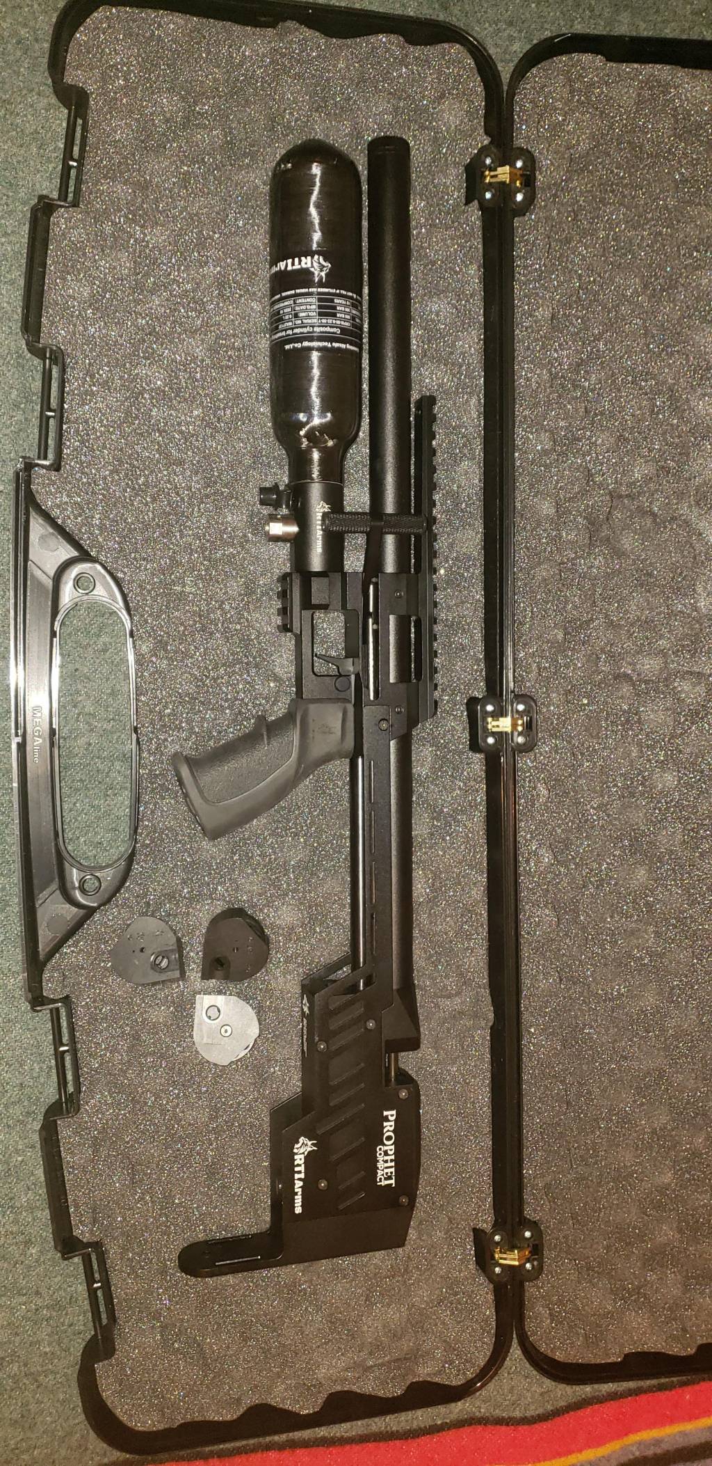

@MikeVV... that is good to know. Thank you for taking the time to compare the two. Here's mine from my Prophet. . I think mine is loose fitting and easily flips right to left. I've barely bumped it somehow from right to left (I'm a righty) and that makes for a very uncomfortable cheek rest..🤣
Looking forward to your review/thoughts on your compact
