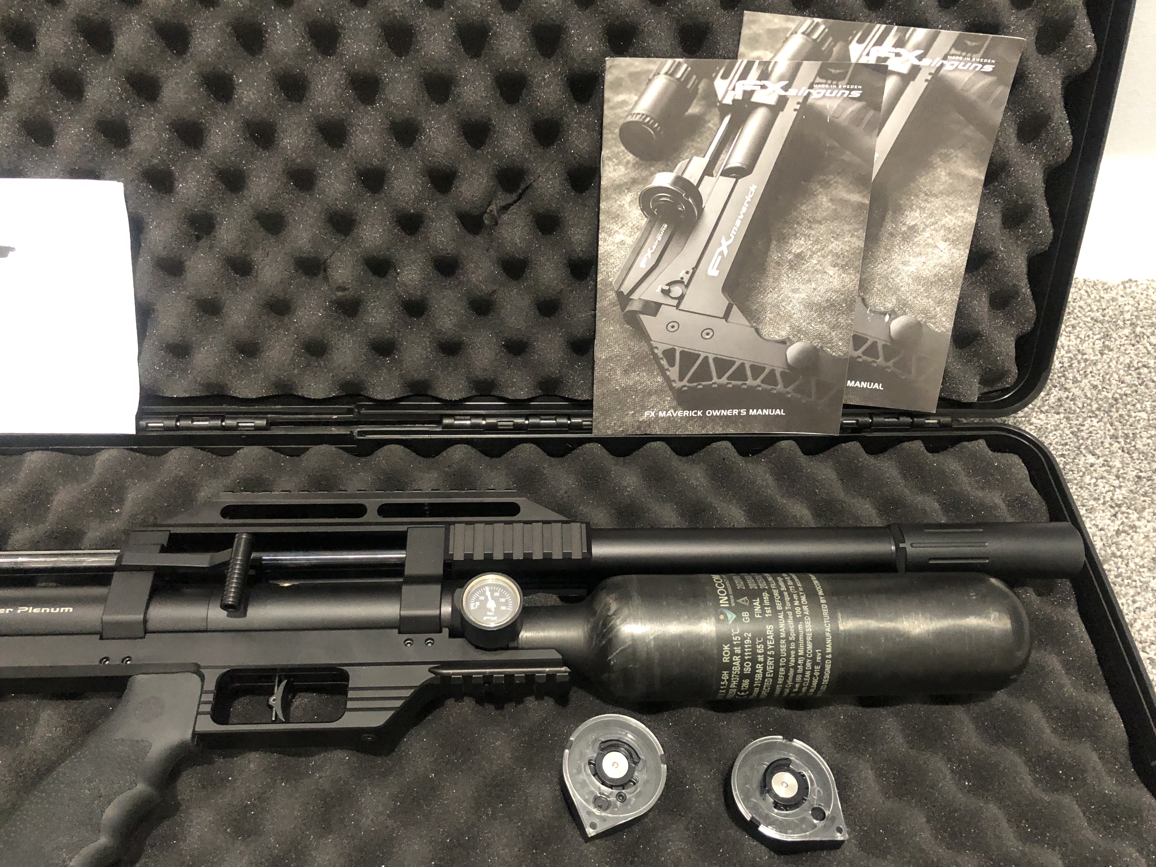

Has anyone put 480cc bottle on FX Maverick Compact?
I'm thinking about getting a larger capacity bottle for my FX Maverick Compact (500mm barrel). I'd like to go from 350cc to 480cc FX carbon fiber bottle. Has anyone done this on the compact, with an LDC? I know there won't be much room to play with, but if my math is correct an LDC with 1.22" diameter might barely clear the bottle?
If anyone has done this, I'd love to see photos! Thanks!

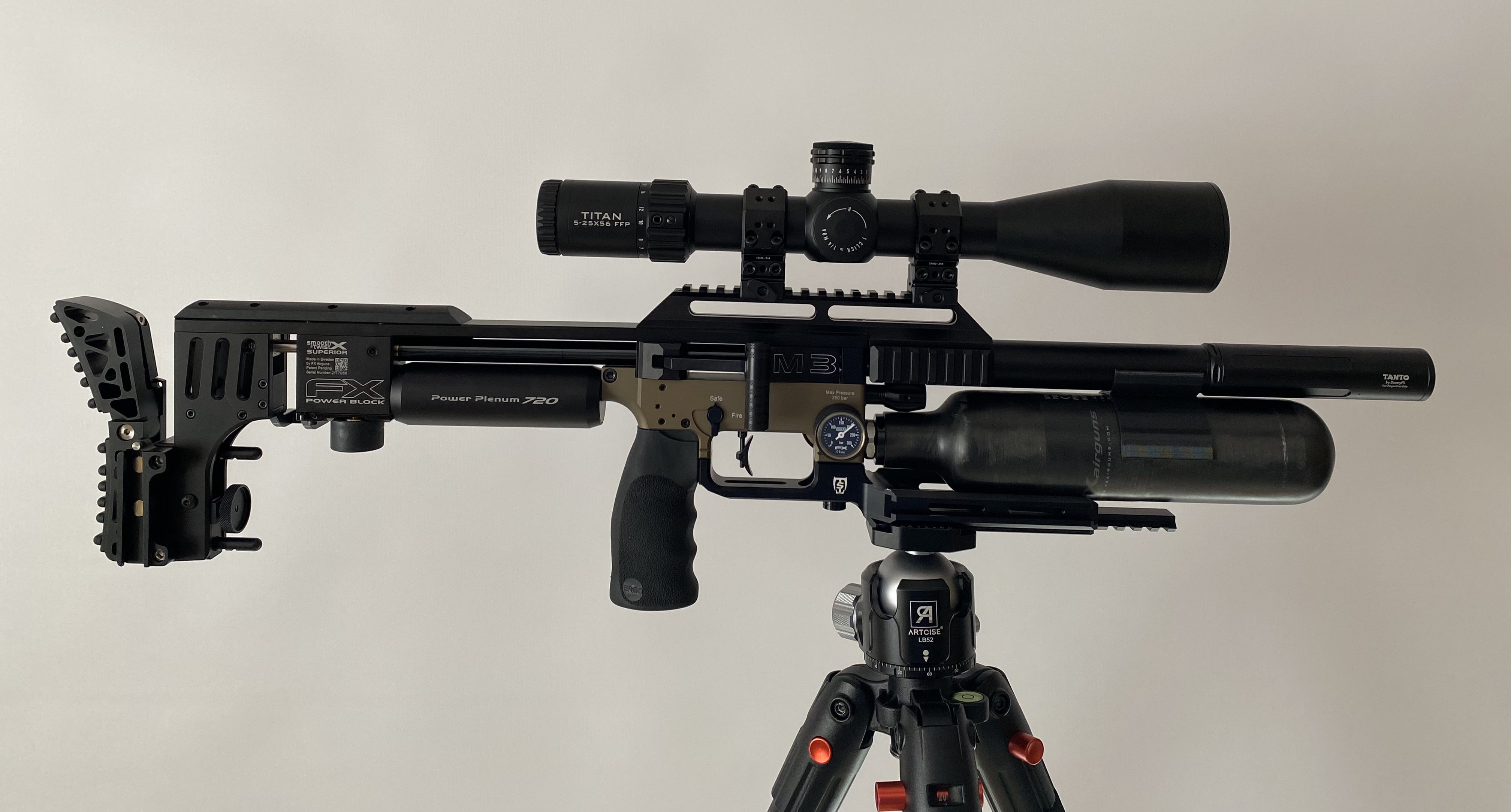

Not a Maverick but a .30 Impact Compact here. I am using the Tanto and noise is minimal to me, for what that is worth. View attachment 327936
Thanks for the pic! If and when DonnyFL re-opens…..I’m in!
Looks great, by the way! I was getting about 110 shots before the new transfer port. Now about 85 shots. Back reg at 75.
