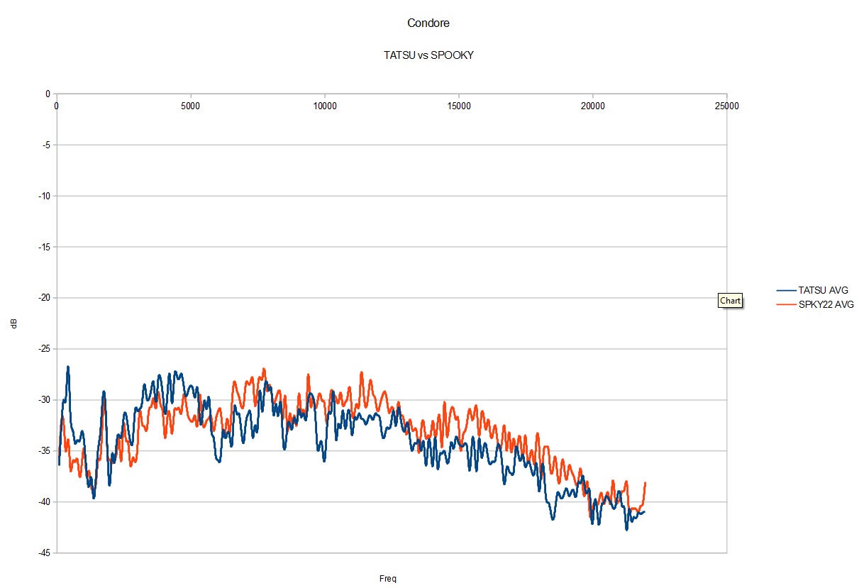

You can record your shooting session with a camera which uses the .MOV format. You can extract that audio using something like VLC. I usually extract it to a .WAV file and then import that into Audacity, which is a sound editing tool. At that point you will have a relatively high quality stereo recording of the shot(s) and can analyze it to your hearts content... and YES it IS repeatable and very useful.I like to see individuals experimenting with moderators designs. It shows interest, but I also see folks are reinventing the wheel. First, using a Db meter is fraught with repeatability issues, all to the point of being unreliable and essentially useless.

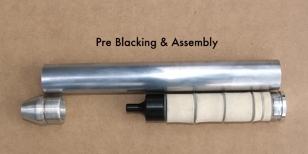

Um no, I don't think that is true. "Packing material" can and does absorb some sound. Take a Huggett or Weirauch apart and remove the felt packing material. Compare. You will see for yourself.. Next, packing material does not limit sound volume.
so ... i you combine your "felt" with baffle's inside ?????Knowing how good the hair curler approach worked (and how hard they were to beat) I thought about how I'd come up with a better hair curler.

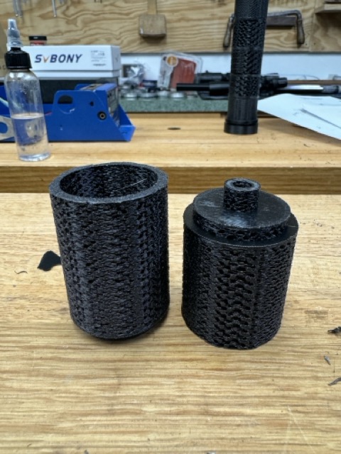

One of my more promising ideas is what @subscriber called "digital foam". I wanted a mesh that air could flow through, but not straight through... and unlike hair curlers, I wanted them sized to my specific specifications. I also thought I might be able to do something about the fender washers too.
Oh, and I'm nowhere near as talented with CAD as Subscriber, so I was also working within those constraints.

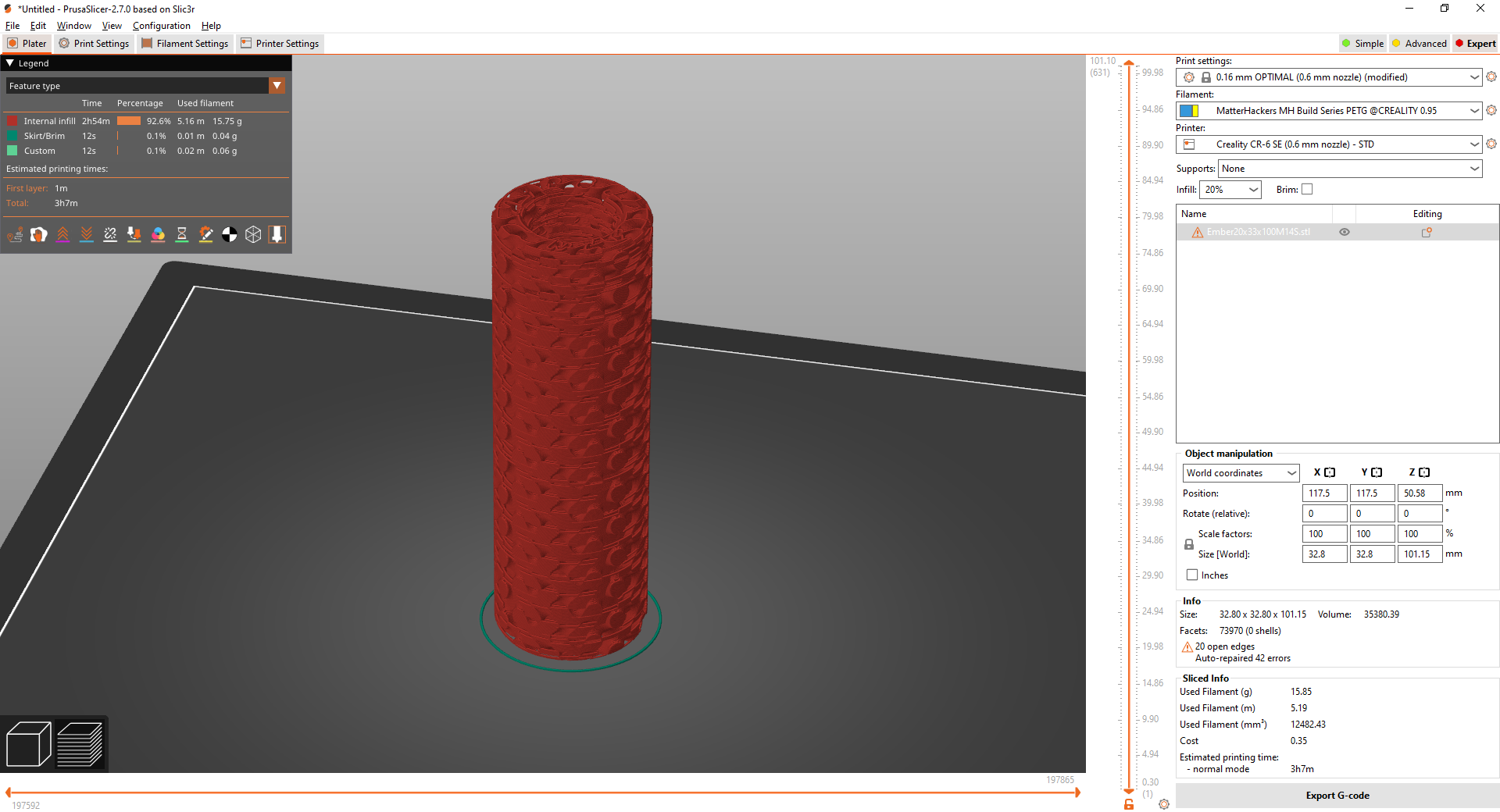

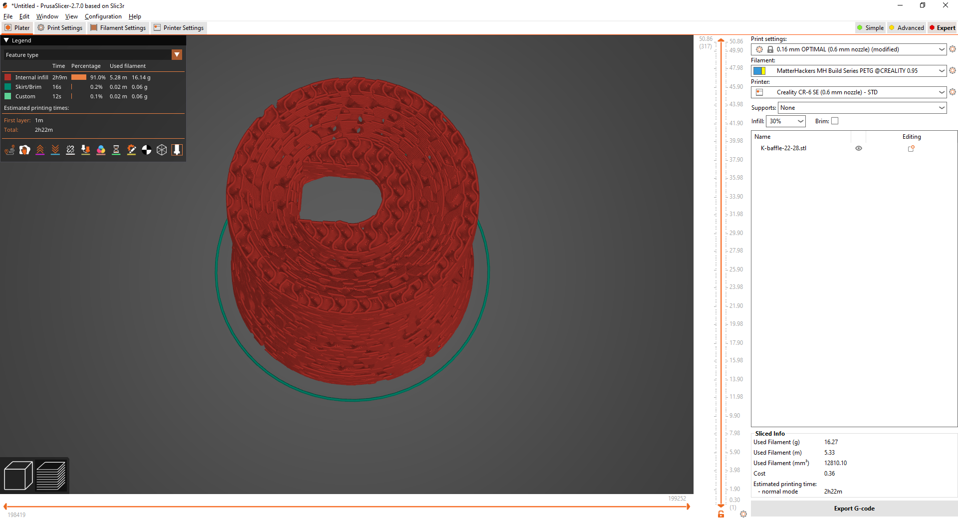

I made a simple stacking baffle design, sized to fit inside a carbon fiber tube that I was using as a shroud. What makes this design different happens when you slice it. By turning off the walls and using gyroid infill... I was able to create a mesh to spec. Between 15-35% seemed to work best. It makes a very convoluted mesh that has proven to be very durable.
This was a significant improvement on solid 3d printed baffles. Encouraged I made more designs that were a few mm smaller in diameter than my shroud and wrapped them with felt. I found getting them installed with the felt was a bit of a pain in the ass... so during one round of testing I decided to try without the felt. I was surprised to find that my ears couldn't tell the difference. My hypothesis is that the mesh is performing a similar role as the felt.
But... along the way, I noticed that designs printed in PETG seemed to be a little better than ones printed in PLA. That led to my next idea...
