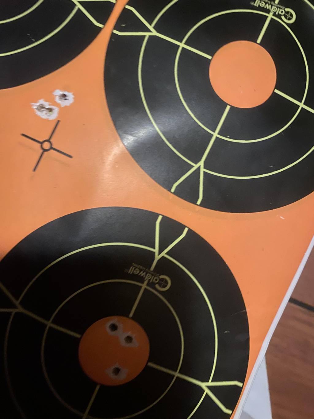

I can confirm the .177 superior liner standard is real, as I bought one at krale. I live in Norway, btw. An easy way to distinguish it from the smoothtwist-X, is that the the rifling turns the oposite direction. I got already 3 .177 smoothtwist X barrels for 3 different FX guns, and the old ones all twist the other way. At the moment I am in a prosses of tuning my impact for pellets, and so far it shoot with the same accuracy as it did before with the old liner. I have ordered some 12.5 grain nielsen slugs from krale also, but they was out of stock, so I might have to wait some before I got them. My plan is to try them out when it is getting warmer outside.
i got one from krale as well mate the riffling on mine goes the same exact way as the one i had in the impact the differences are that the one i got from krale has a tighter choke, the riffling looks more pressed and it starts after the ring that goes into the transferport end
