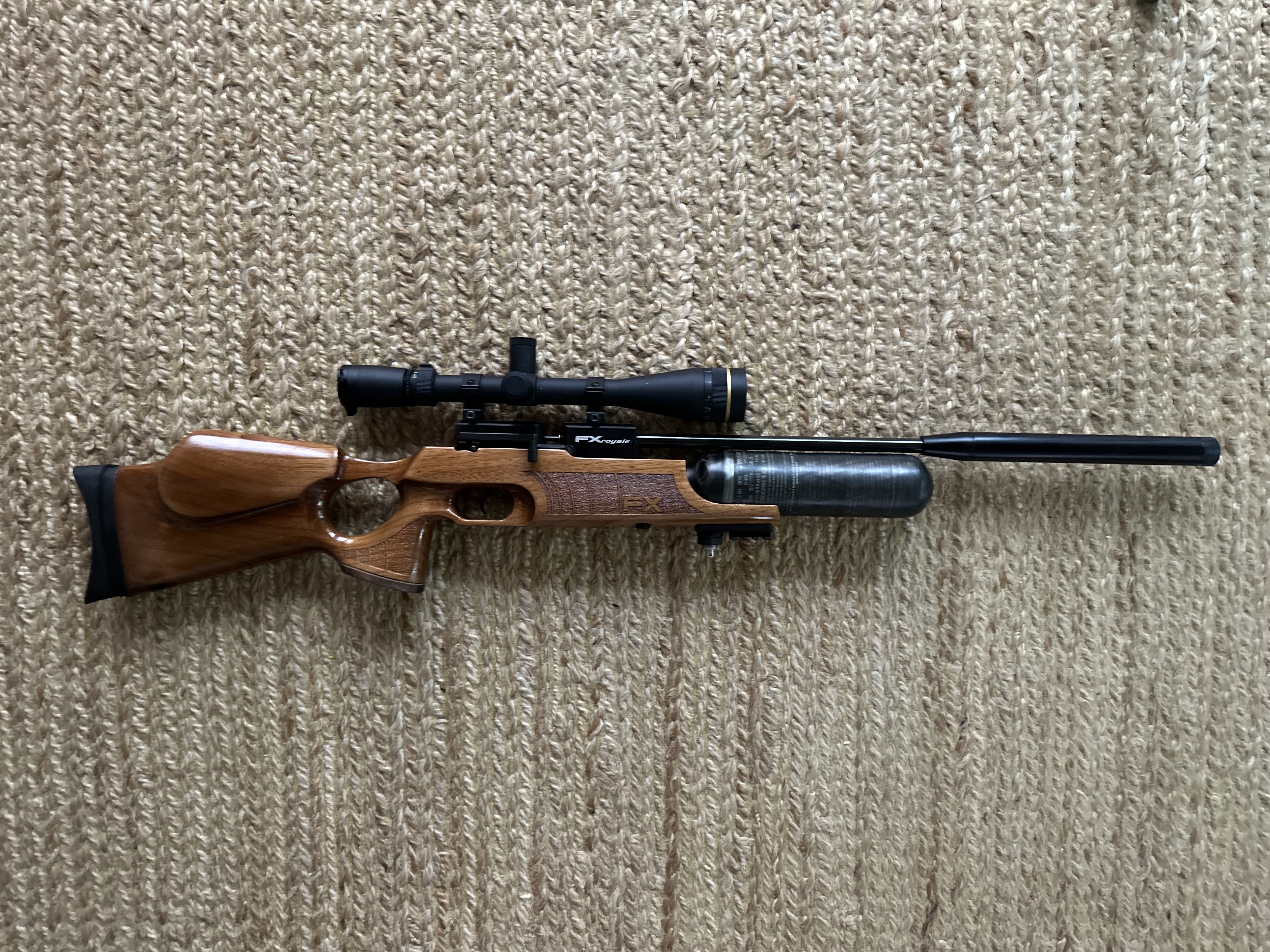

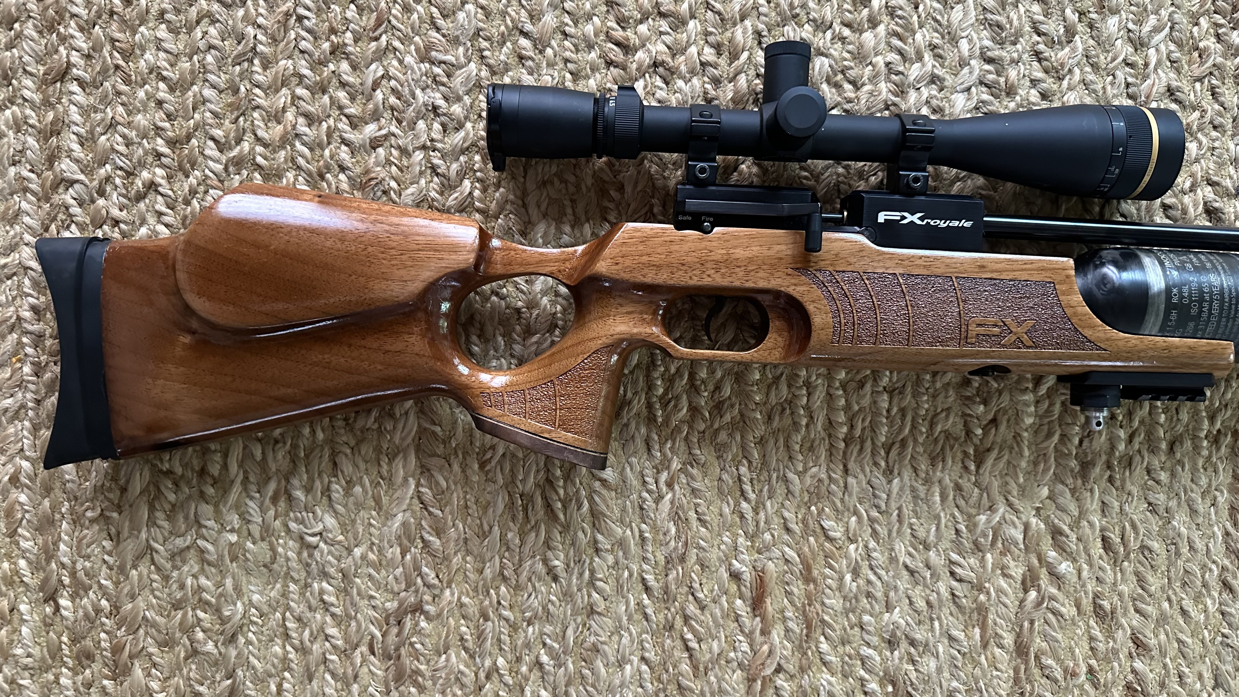

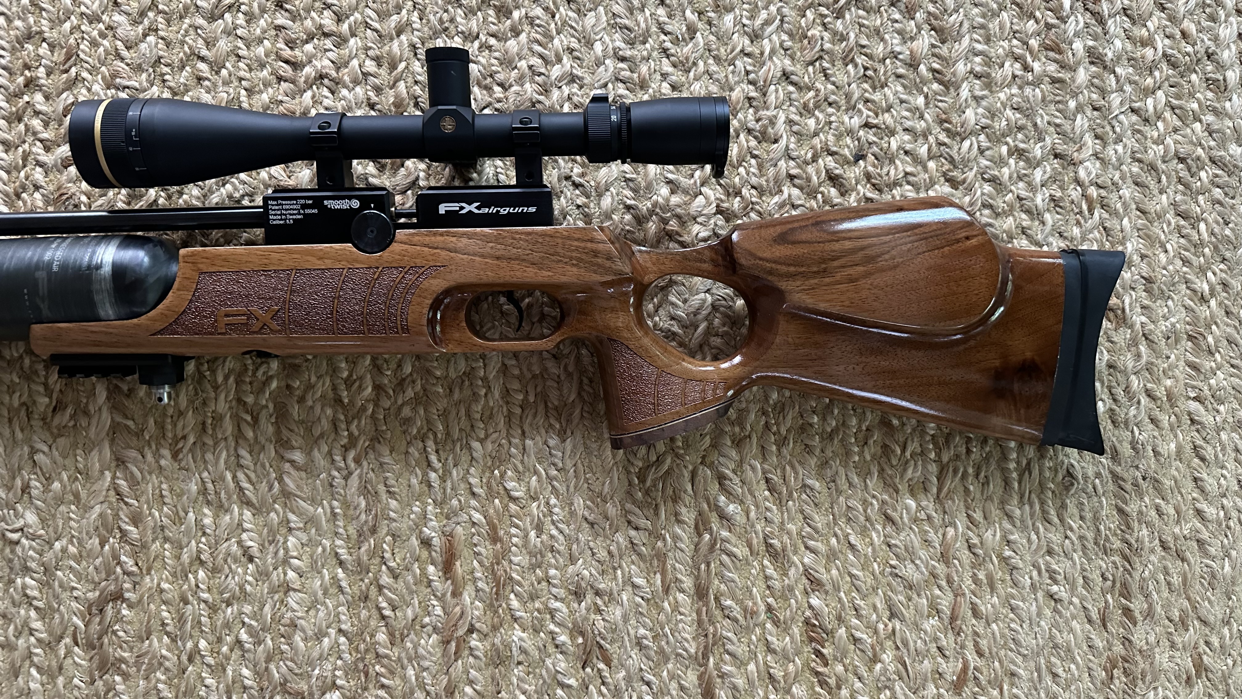

I recently finished my ‘first and only gun wood stock’ project with True Oil.
Watched a lot of YT videos B4 I tried my luck. I have an FX Royale 400 .22 ST barrel from SPAW with Walnut stock. This was a 3-week OCD trial and error learning experience for me.
I probably sanded and applied 9 or 10 True Oil coats before I called it “good.”
Also used 000 and 0000 Steel Wool in between sanding and applying the True Oil.
I wanted a glossy finish. Came out nice.
Would be happy to talk live if needed.
Reactions: fishing43 and Mr.H

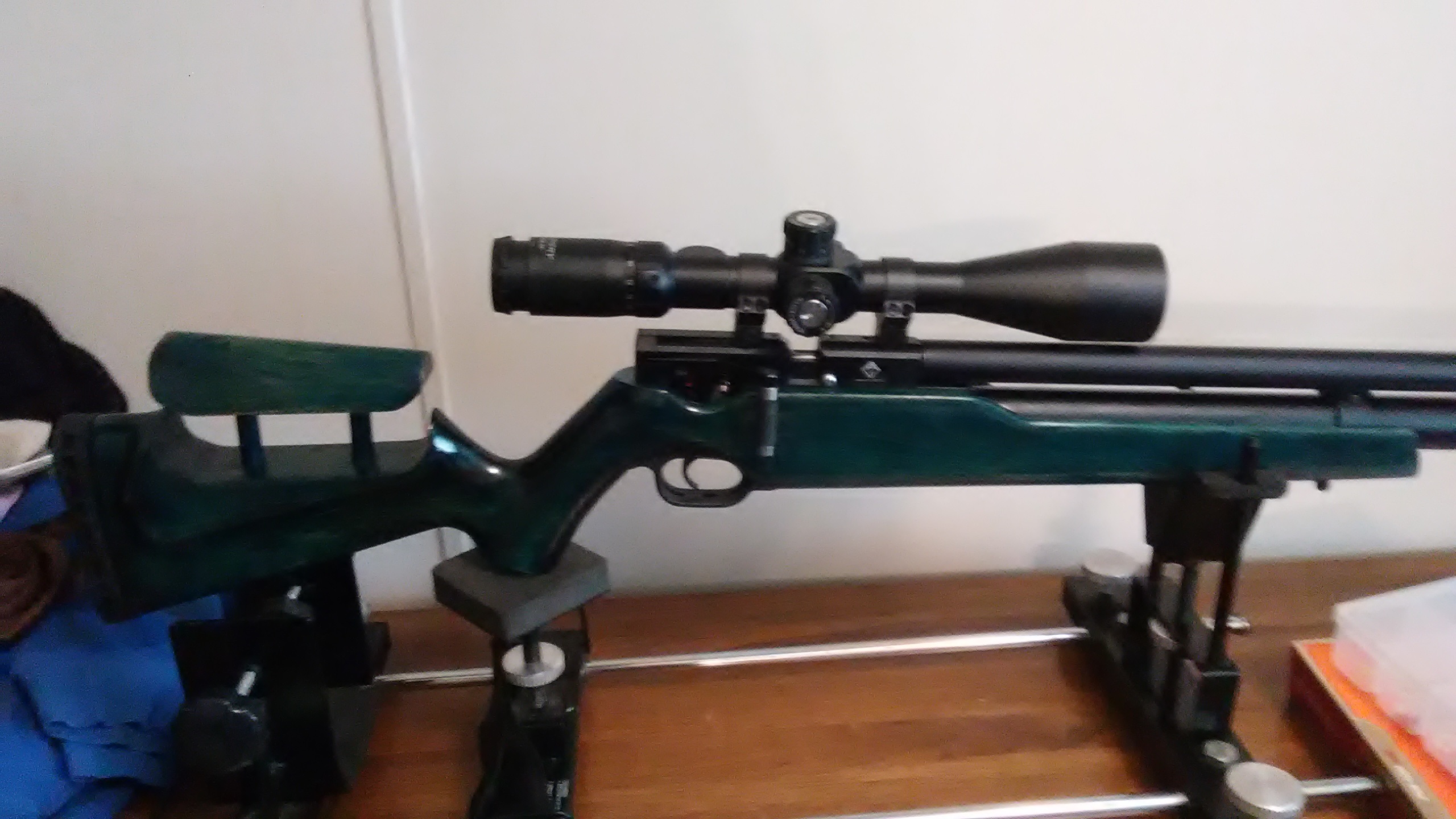

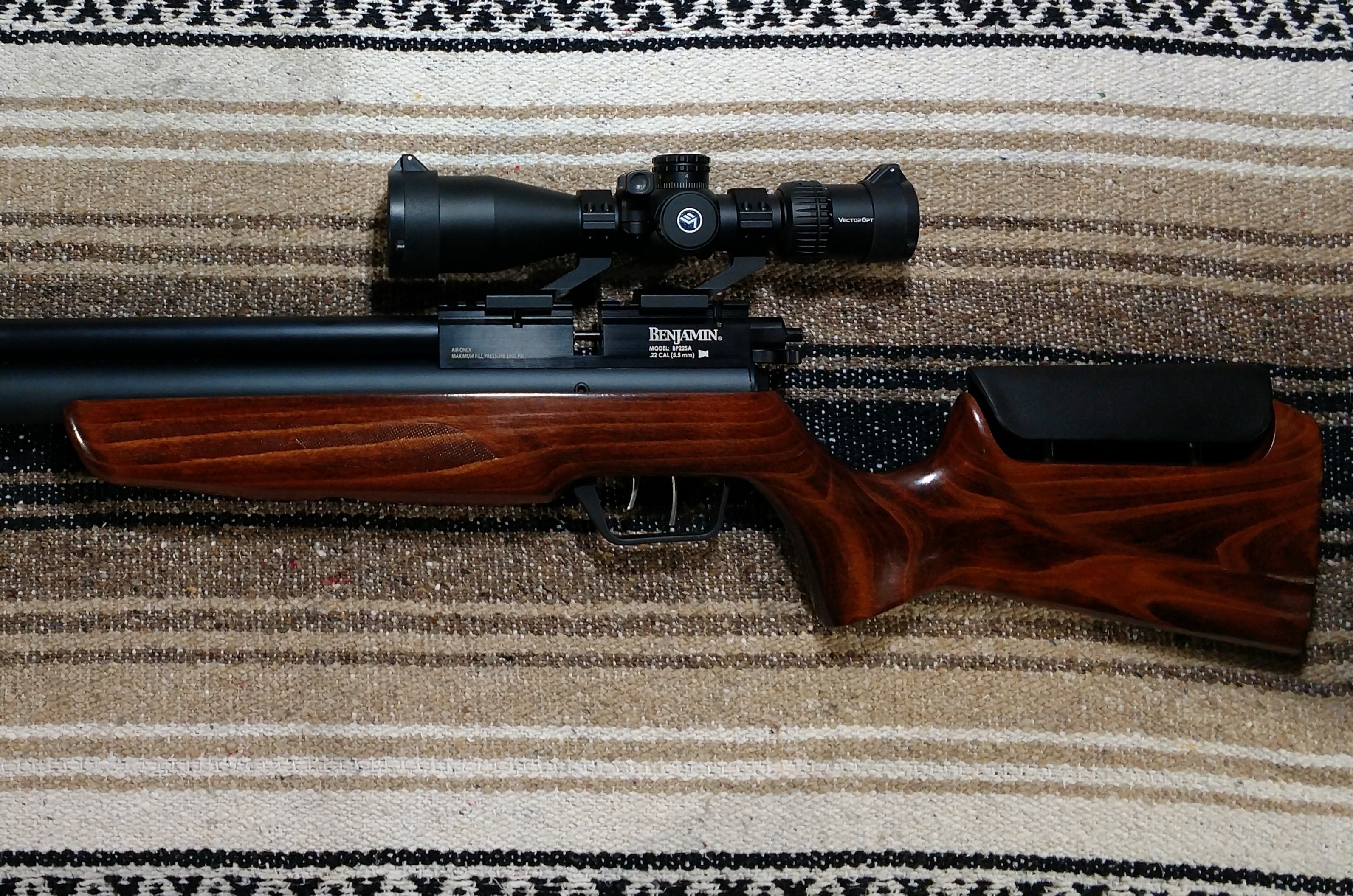

I also did a complete strip and refinish. I watched a lot of woodworking/refinishing videos and came up with the method and finish product for the look that I thought would give me the best result and look I was after. This is stripped of all old finish, sanded, stained, and finish coated.
Gerry, I watched the video. The Min Wax Poly Seems easy.
Thanks pal. Yours looks beautiful! If I need more assistance I'll get in touch.
Reactions: tommyb
