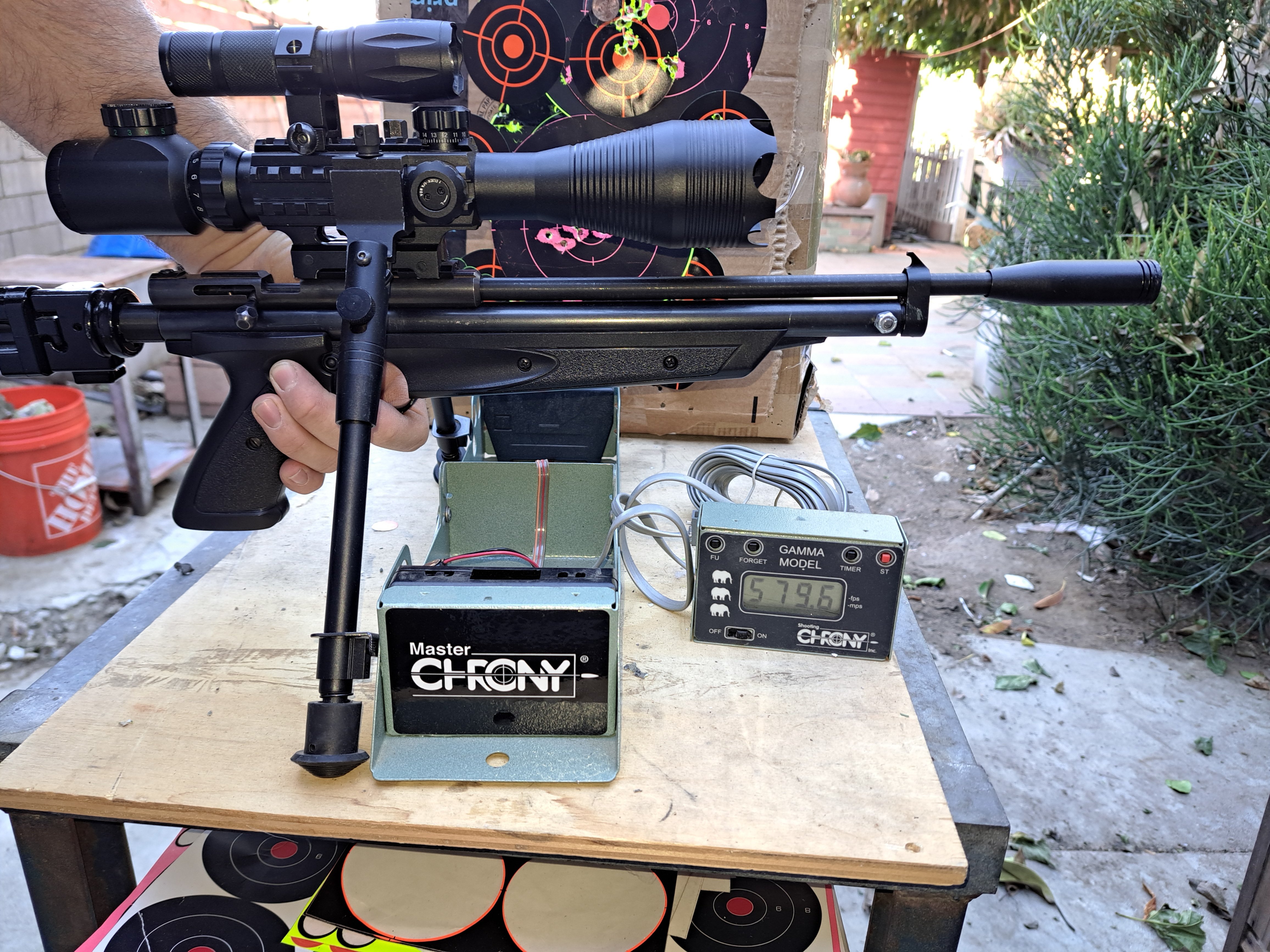

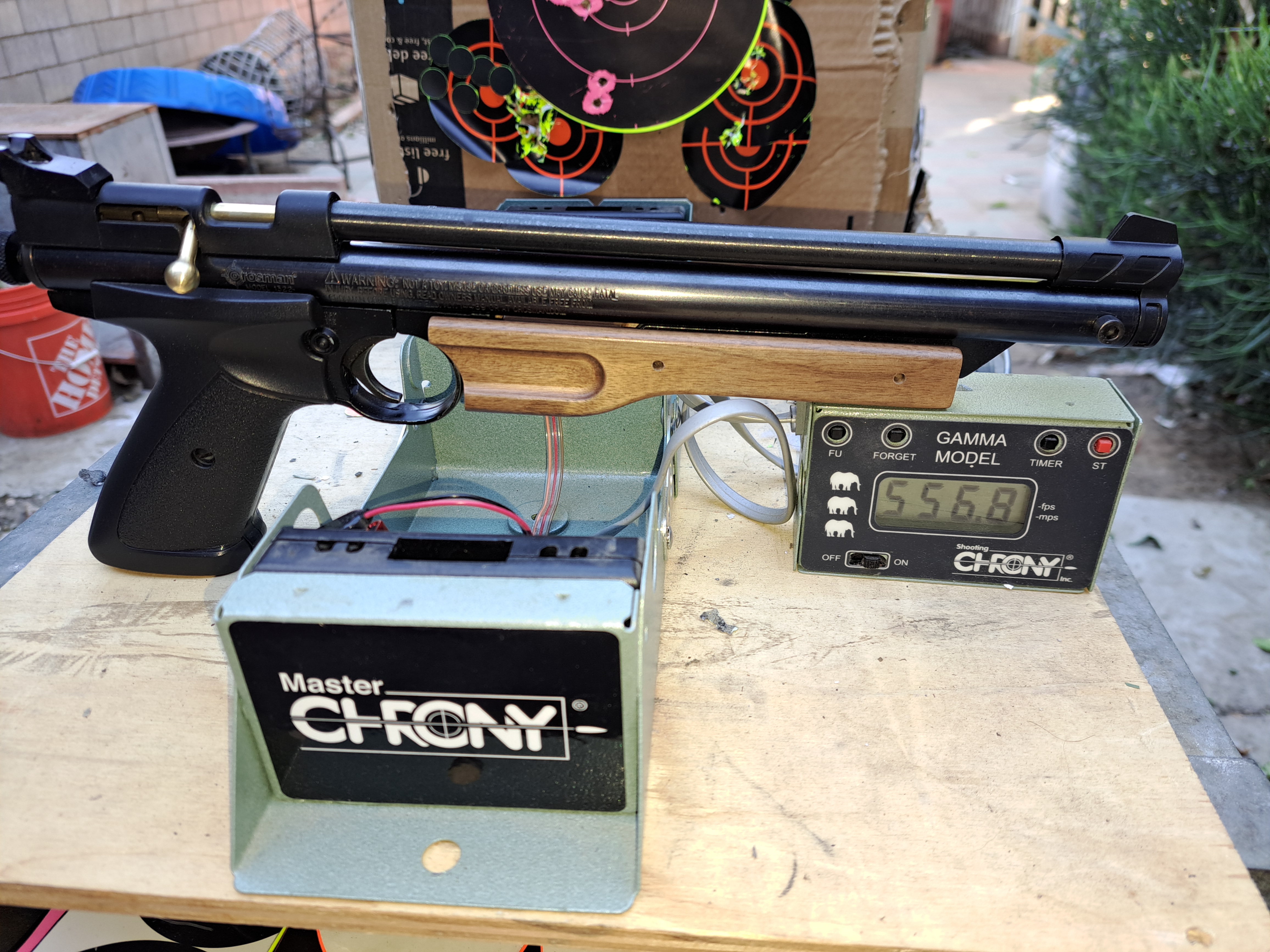

I'm working on attaining that too. There comes a point where reliability may be a factor. The seneca aspen is great if you change the o-rings but the fix is not for the faint of heart. I love building the crosman platforms and have made some awesome builds. Just a few I've made. 1322 with extensive valve work and yes, a plastic piston with pump cup. 556 with 15.49 .22 and a10 inch barrel at 16 pumps.

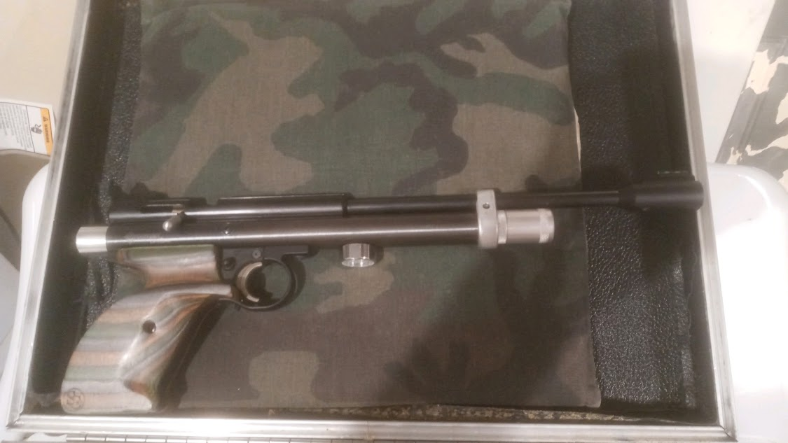

1322 with m-4 tube 14 inch barrel modified valve and flat top piston. The piston needs a bit of adjusting and needs one more mod to make it virtually zero headspace 14 pumps w/15.49 .22
I once built a 2100 13xx with a 14 inch .22 barrel and could be used as a large pistol. Lots of valve work and flat top. Eventually wore out the pump arm and tube pivot hole do to my poor work at adjustment on the piston. That one shot 14.9 gains at 620 fps at 10 pumps. Crosman has the parts but volume is key. Also wanted a zoraki but heard the pumping was a bear.
