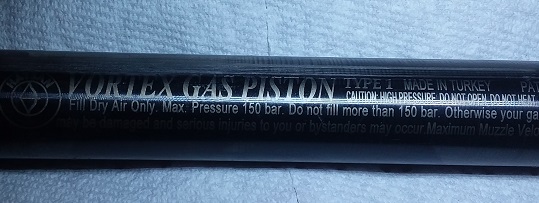

The Vortex rams I've tinkered with have all said Max pressure 150 Bar and not to fill them over that. I've never owned the bigger 125 or 135, but at least in the Model 95's and 87QE's I've had, they were all set right around 125 Bar, so just a wild guess on my part but to get the higher power of the bit bigger rifles, I'd say something like 135 Bar?
Also have to remember at least on the 125, the stock is synthetic and is going to take some abuse from the extra pressure required to cock the rifle. 16962-Vortex-ram-body.jpg
