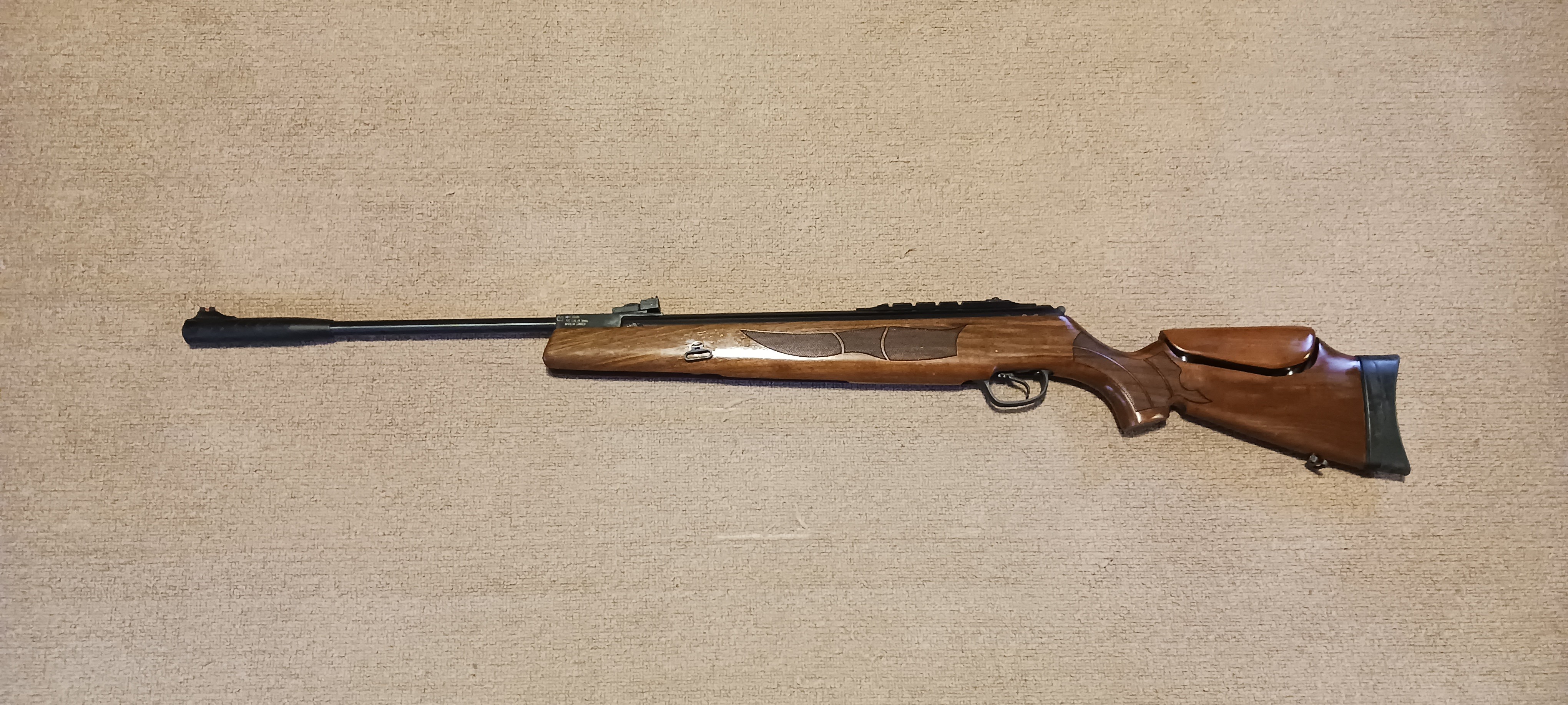

The 125 .177 is looking good in the walnut. Just tuned the 125 spring. Softbedding of the stock to make up for the 1mm tube difference in the tube diameter. Drops right in the 135 stock.
Is the 125, 130 and 135 the same rifle but in different stocks? They all have identical specs if I'm not mistaken?
the internal cylinder diameter of Mod125 is 29mm and Mod135 is 30mm.
Both 125 and 135 have the same stroke.
They are same except stocks, cylinders, piston and piston seals.
