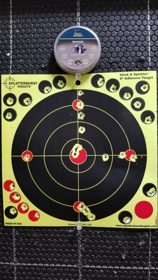

I just got my Puncher Breaker back from Pyramid Air [Air Venturi] today,
[They not only replaced the broken OEM valve-stem with an upgrade but also gave me another as a spare]
and as soon as I got out of work, I set it back up, sighted it in real quick, and within just a few minutes,
I remembered Exactly why I enjoy it so much!
Bull and Bottom/Center are the 2 dots I used to sight in..
The rest were my actual shots.
Those random looking ones in between does? Those aren't random..
That's where there used to be little tiny numbers: 7's, 8's, and 9's..
The thing is ridiculously accurate..

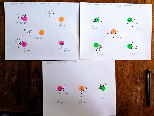

One more observation regarding the kral bigmax and hatsan flash. While the kral gets a few points for having a power adjustment wheel (transfer port adjustment) its hammer spring has very little room for adjustment. The hatsan lacks TP adjustment but more than makes up for it in a hammer spring that has a wide range of adjustment to it. I recently opened up the transfer ports on the kral and will be using the TP adjustment to test accuracy with JSB 18.1 grain pellets at different velocities. At full power (TP wide-open) the gun is shooting them a bit fast now and accuracy with them has suffered a bit. However, the extra power I got opening up the ports brought the speed into the sweet spot with the JSB monsters.
I did a full shot string with jsb 18s yesterday and it confirmed that accuracy suffers above 920 fps with them. Here are 130 shots in 10-shot groups at 50 yards. Meh...

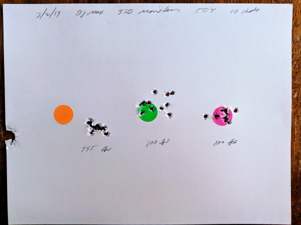

I shot these groups with the redesigned monsters after topping the gun off. Now this is what were talking about :) Again 50 yards and 10-shot groups:
