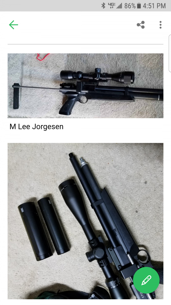

2nd on the 1720T. I've a collasible rifle stock, so can shoot rifle and pistol with the same gun. Huma reg, 6 oz trigger, it just rocks.
Sometim
es, it's more expensive to be cheap?
this slips in my backpack, gives me access to local ground squirrels no one else can shoot..
I've only had the 1720T , well worth the $345.00 ( do shop around) . Good trigger, >W barrel taht would hit a house fly at 50 yards every single time. Can easily be boosted to 11fpe with good shot count & spread, really the value in low cost target pistols.
