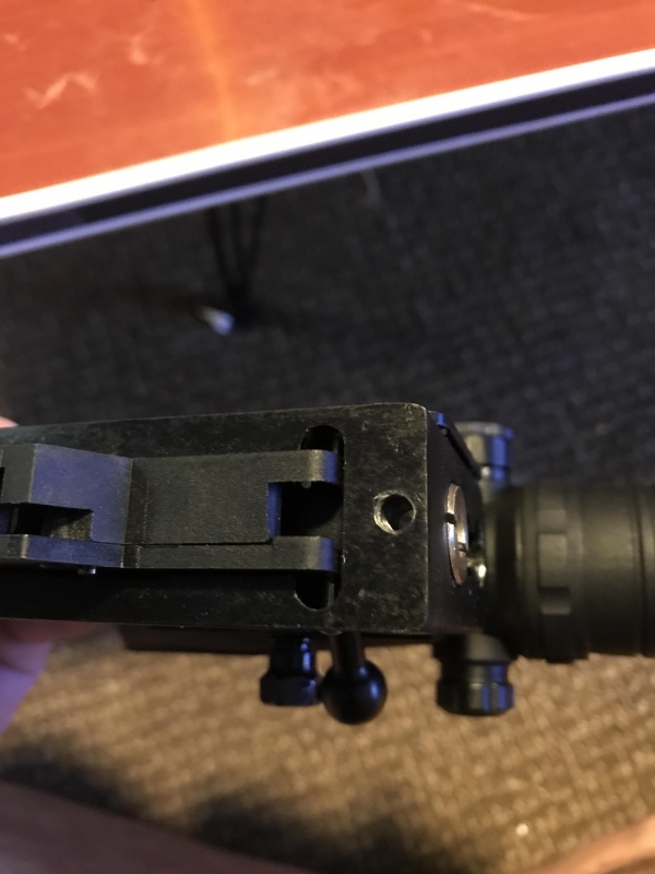

I took a chance and called HatsanUS and was directed to the technical and repair extension. I explained the problem and he gave me a solution I could try. It was (1) remove the stock, (2) put bolt forward, (3) insert a 4 mm allen wrench into the bottom hole at the rear of the gun, and turn it counterclockwise. I turned the wrench 1 1/2 turns and then reassembled the gun. I tested it with two full magazines and it operated properly. No more feeding problems. I have only praise for the HatsanUS technical person.

To add to the instructions that Hatsan provided above:
(1) de-pressurize gun
(2) remove the stock
(3) put bolt forward
(4) insert a 4 mm allen wrench into the bottom hole at the rear of the gun, but first you have to loosen the set screw on the bolt and then you can turn it counterclockwise
(5) turn the wrench 1 1/2 turns
(6) reassembled stock
