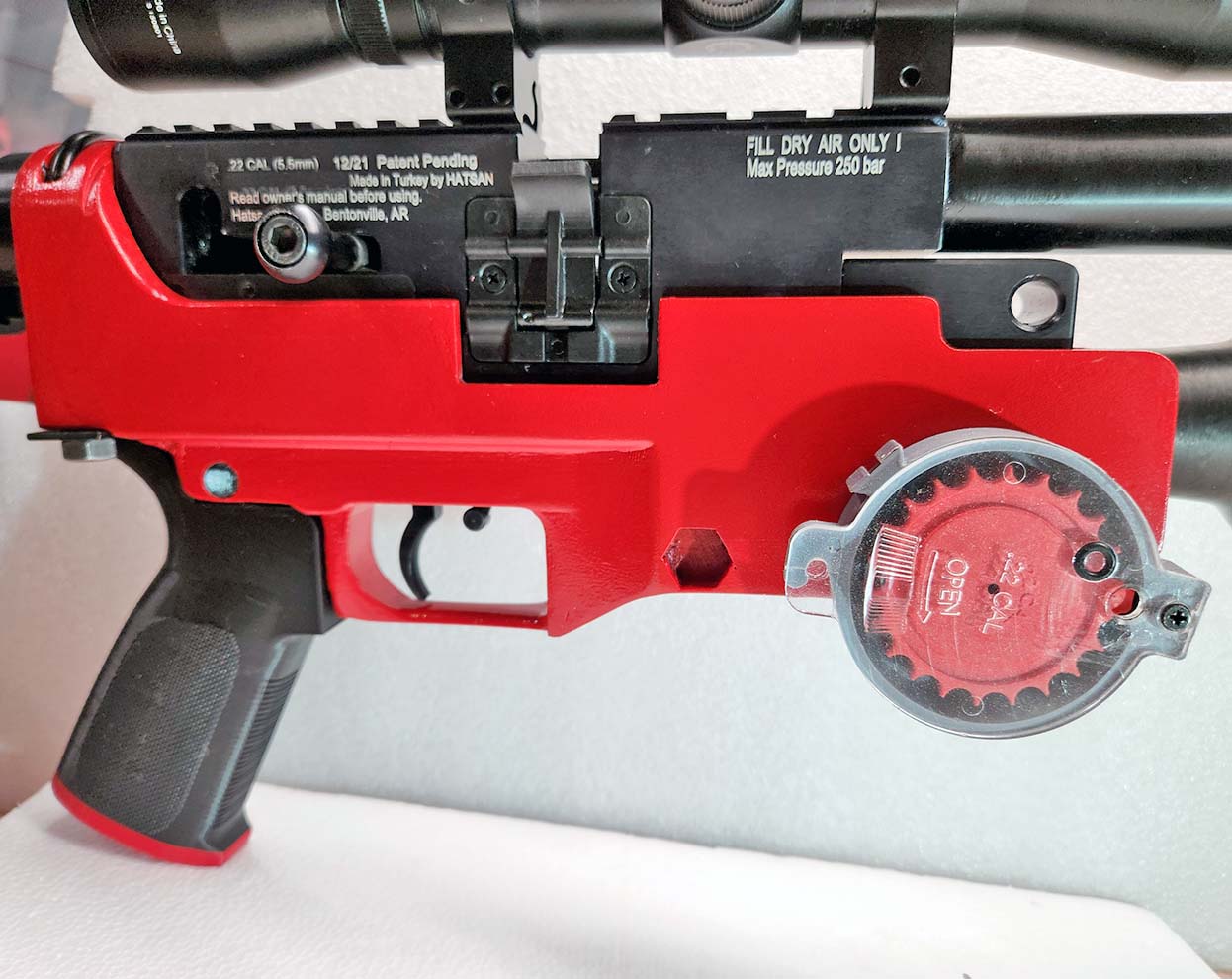

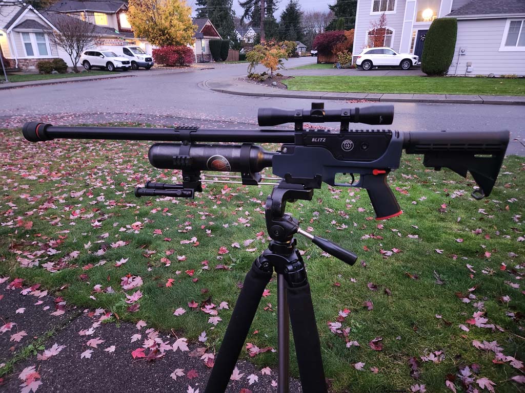

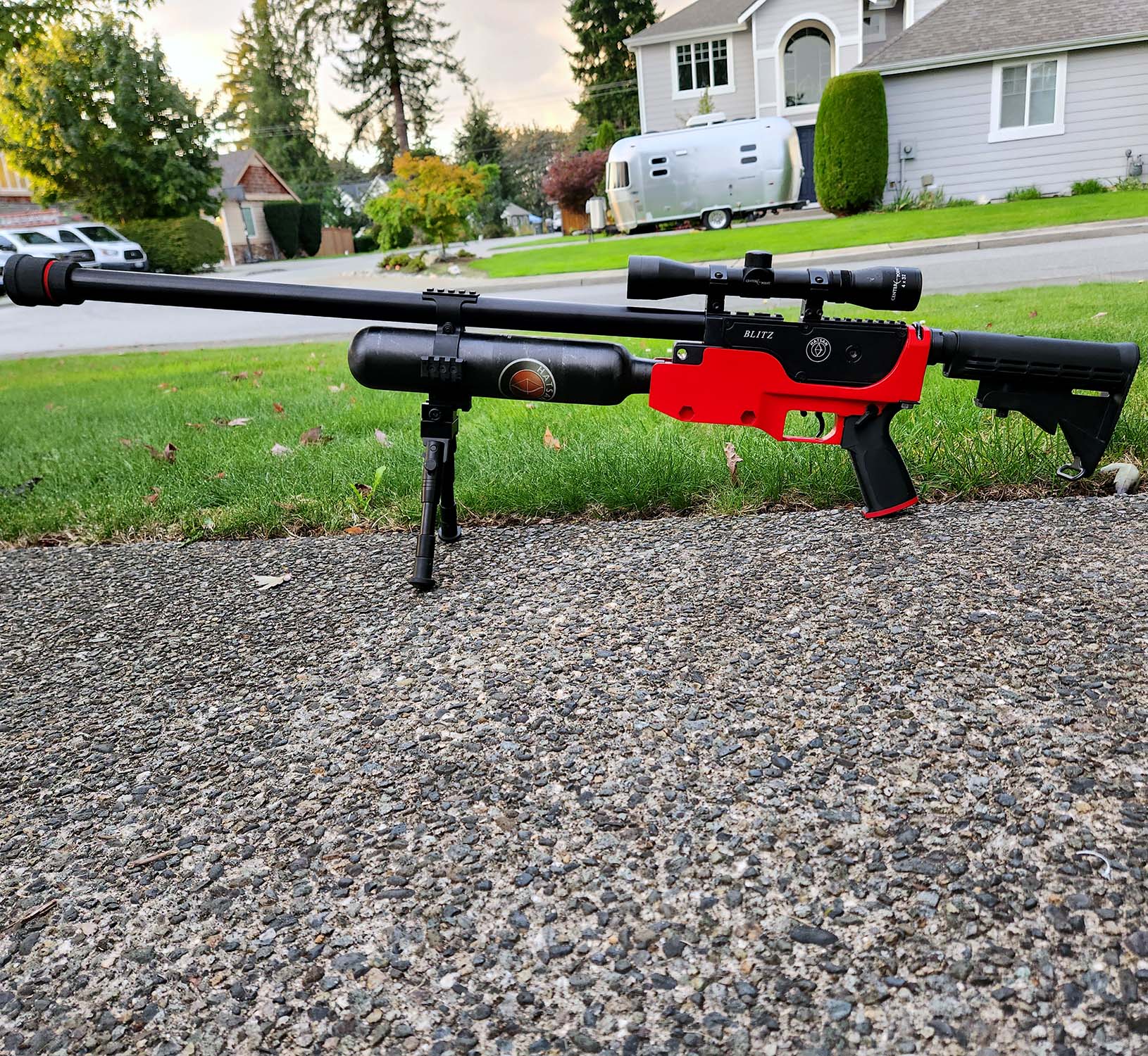

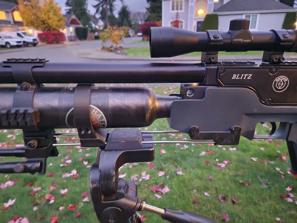

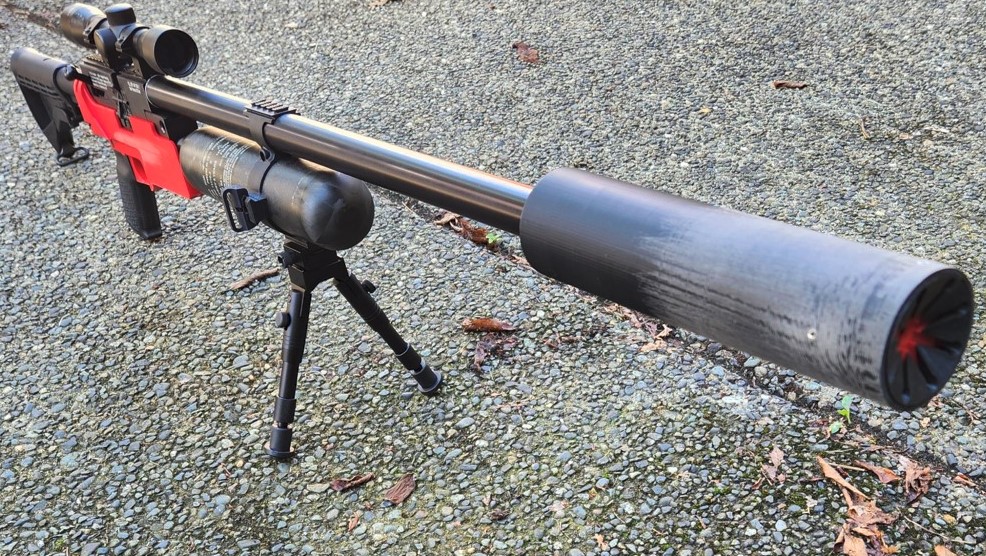

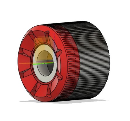

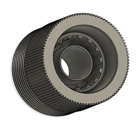

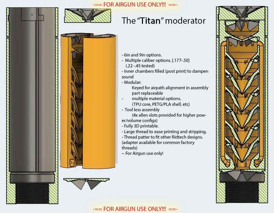

I have a few mods for the Blitz online if you have a 3d printer. Links are in my signature below. AR style frame and suppressor adapters. My Suppressor, "the Titan" will be out soon too.

I revised a barrel end cap suppressor adapter to take weight off the spring. Seems to slow cycle rate some (a plus) but makes it easier to use with lower volume suppressors. More air can travel out of the barrel to suppressor. Allows some custom tuning. I also have details on the video in post #16. I did not see this until after but seems to be a bit hand in hand as to how it effects things in my write up.. See the link above and check the "here's the dirt" portion. One thing I differ on is setting the geared slide rearward as far as possible as you align the gearing to maximize the travel using less air pressure as the suppressor "suppresses" this.
