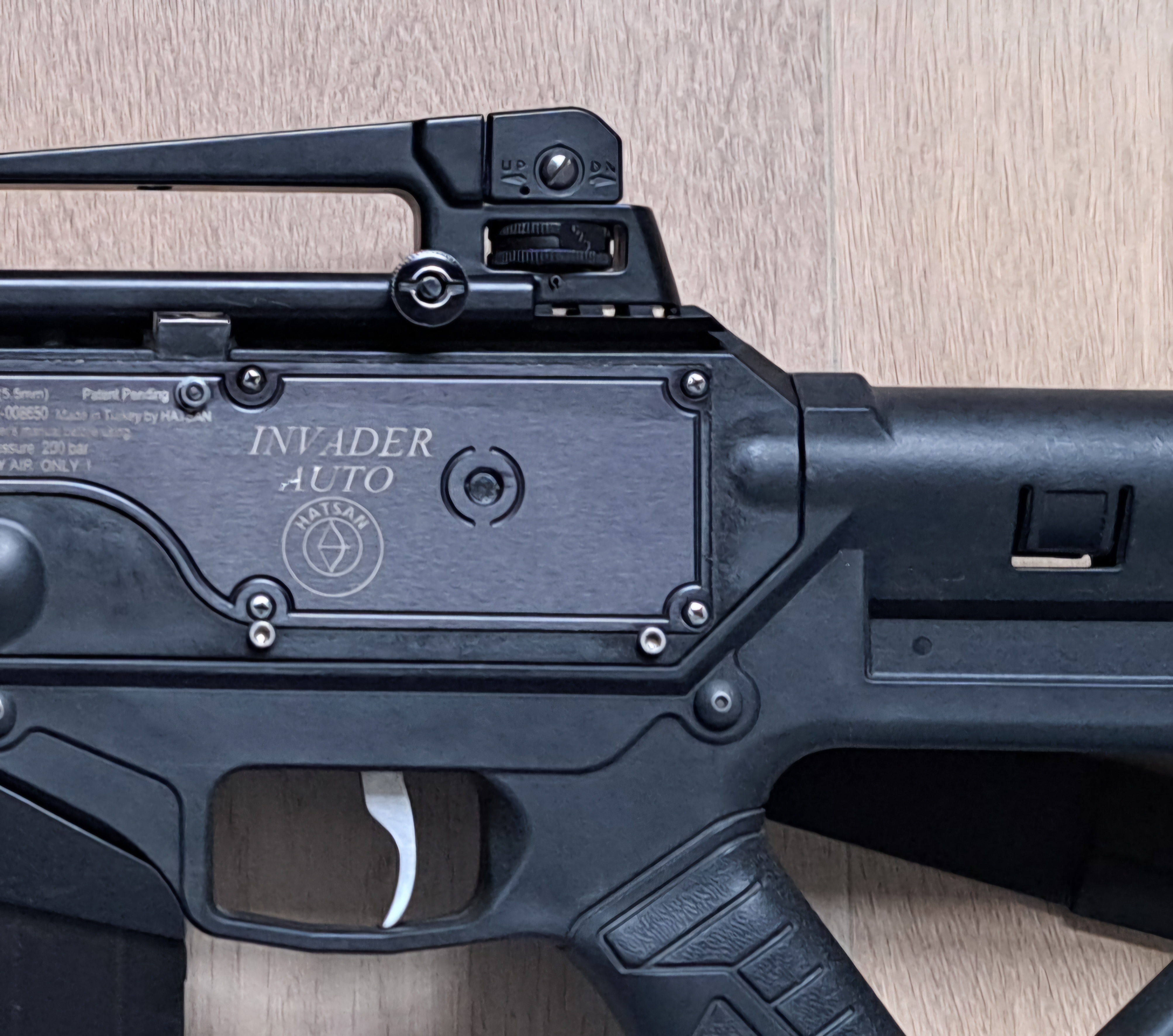

A huge inprovement is to make a new and larger triggerblade. Don that on my Invader Auto

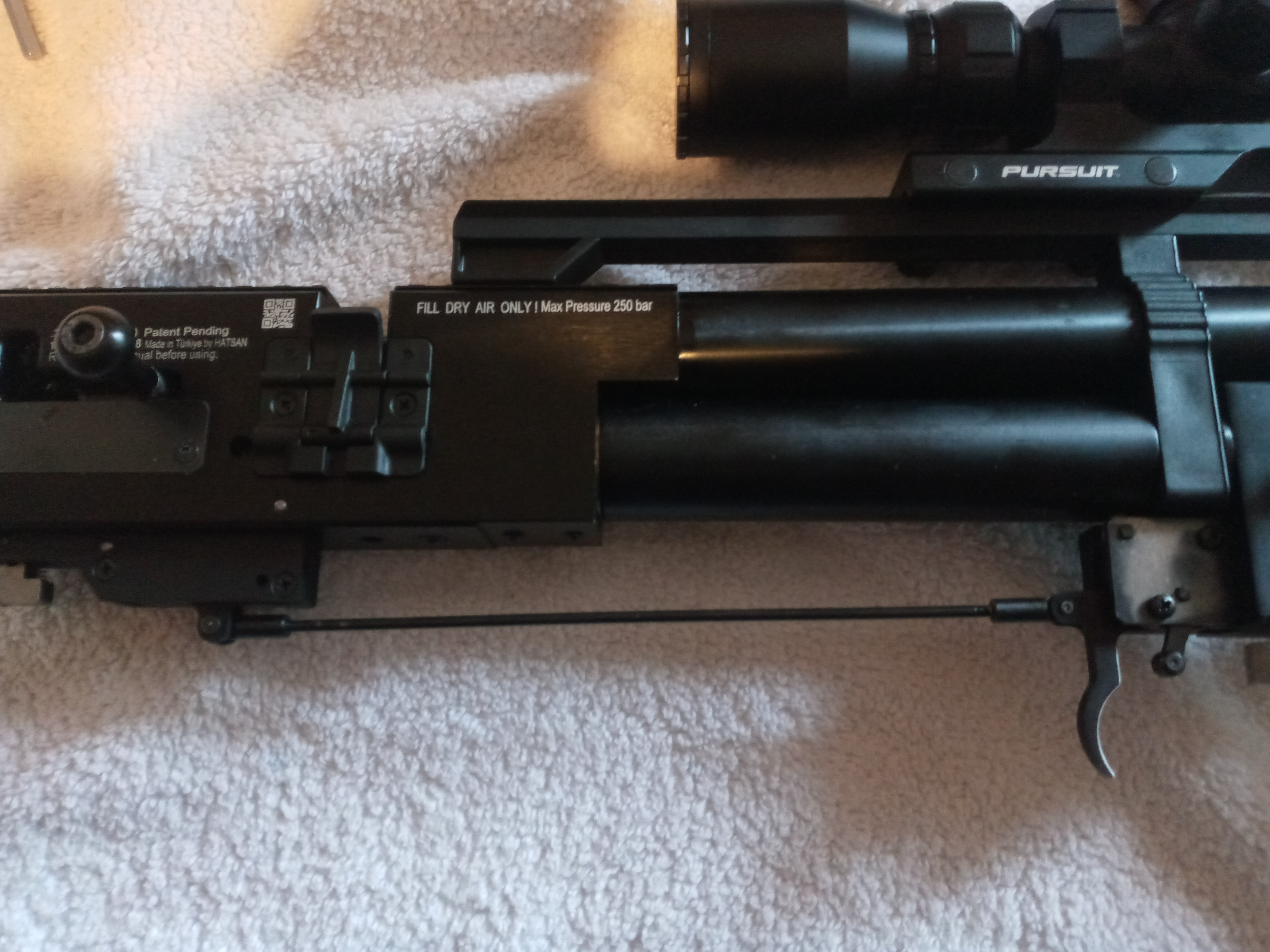

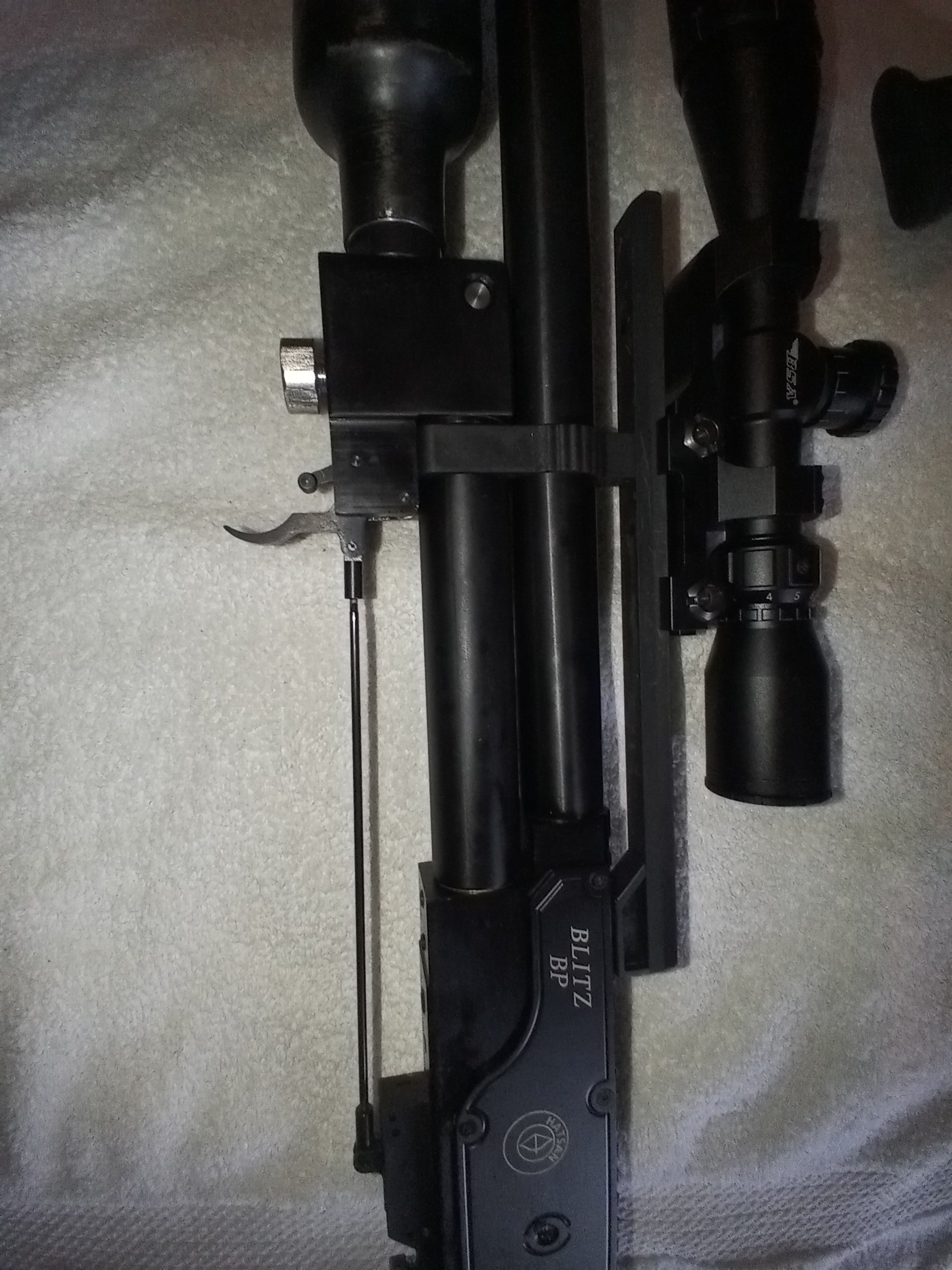

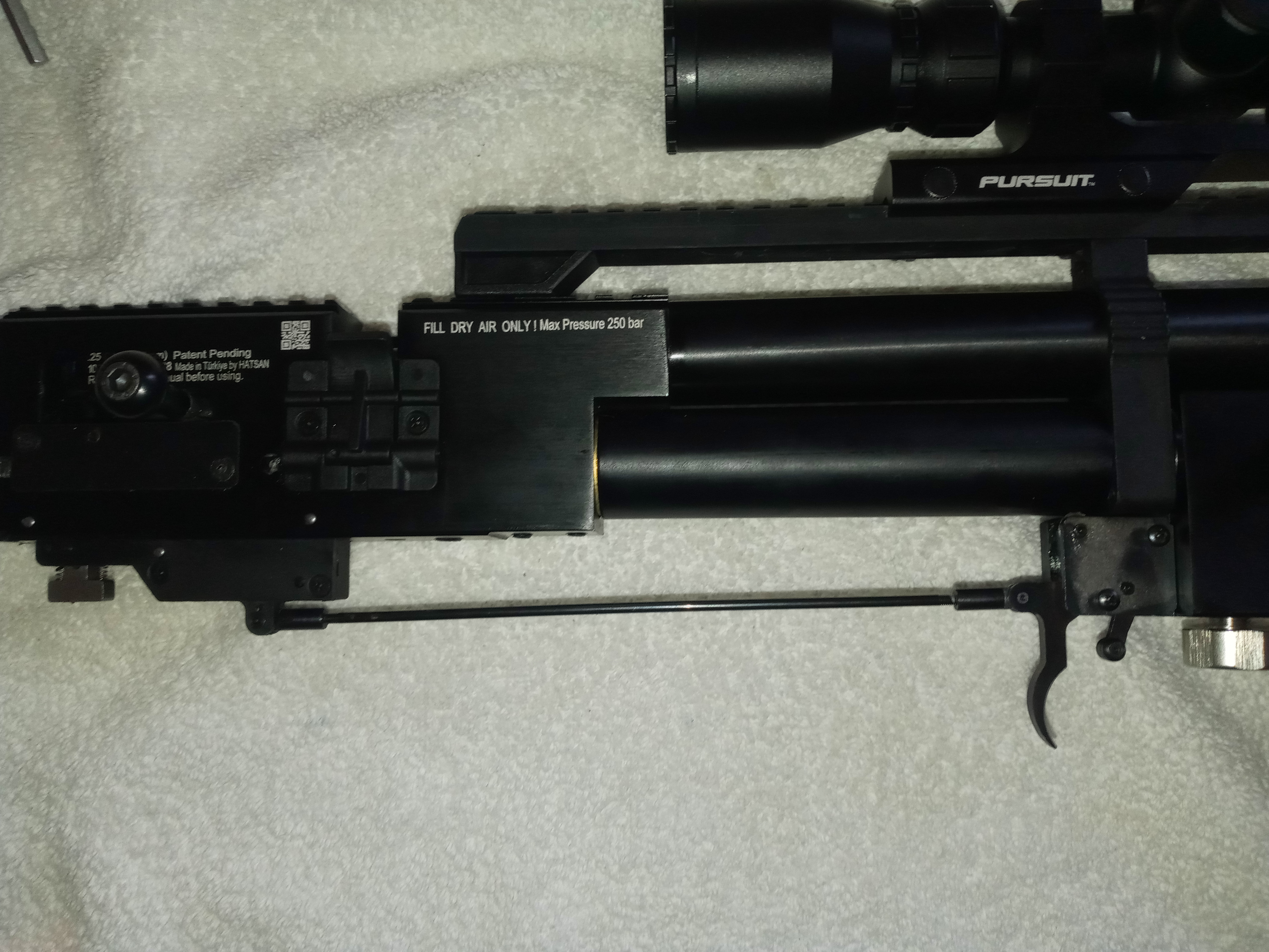

Well I figured out the cycling issue deburred and polished and that did the trick, and yes hatsan moved the trigger forward right behind the bottle block and attached a rod to where the original trigger was, I don't know why they don't sell them in the US I've talked with a few vendors and they wish they would ship the to the US because they'd be a hot seller, I purchased mine through airgunseurope. com it was at my door step in 7 days even being held up in customs for a day or more, I'd be happy to post some pics of the trigger system if yould like, other than the trigger and the shortened stock it's identical to the standard blitz

Also airgunseurope.com is located in the Netherlands so 7 days shipping time is awesome, they are very friendly and helpful, they told me they ship the blitz bull pup all the time to the US with absolutely no issues but like always they may not ship to certain states or cities, check your laws first just to be sure
