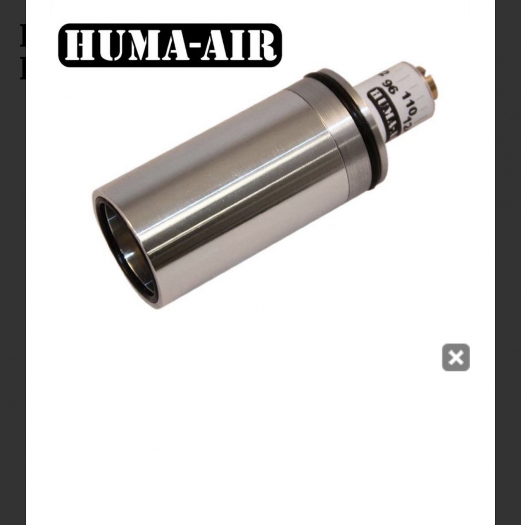

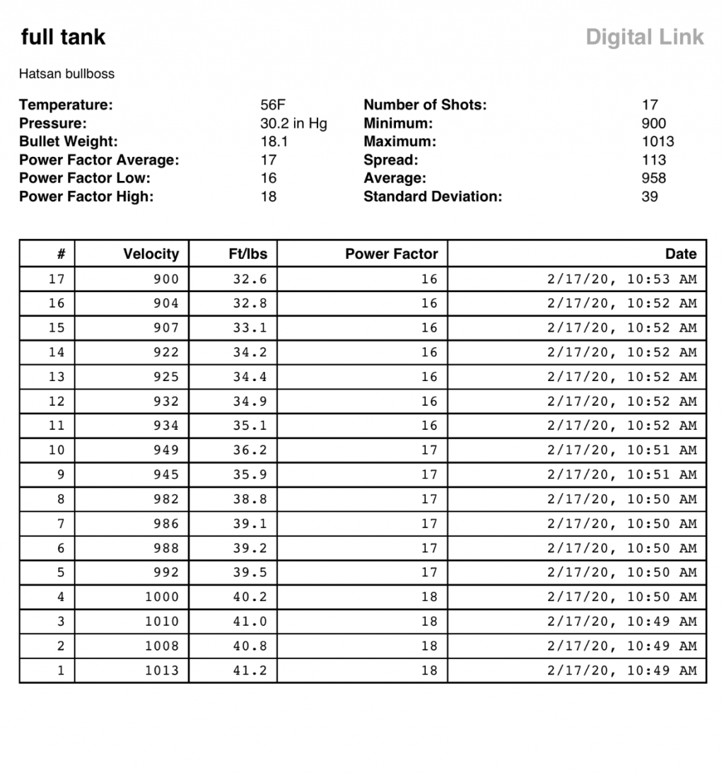

IMHO, It sounds like your going to be wasting air. The main reason for a person to wanting a regulator is increases the shot count. If your plenum is a 16cc plenum with the 18gr Jsb. Id set your regulator at 108bar. Your hammer is going to be to heavy. But on that gun there is a spacer behind the hammer spring try removing it. I did all the calculations for your gun based on .22. 18gr pellet, 900fps, 23" barrel, 16cc plenum. With the efficiency of 1.00 FPE/CI. You may need to inch the regular up but, I try it there first. Becouse the transfer port on that gun may be a litttle small. But I cant remember.
With the regulator set at 145. I guess your going to experience a very loud puffy shot and your probably going to get lucky if its 20 shoots per fill. Your fps will have very high swings from shoot to shoot. Causing you groups to open up.
If its a must to have your regulator that high, you should look for a slug in the 50gr range
