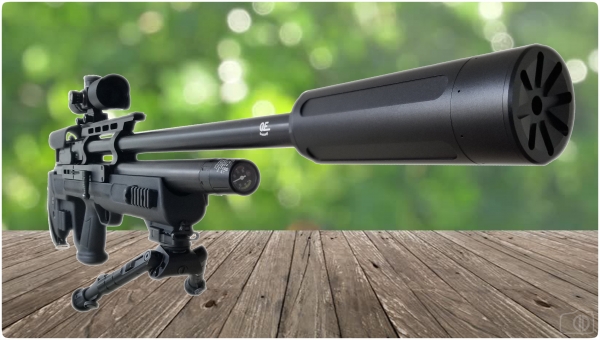

hey guys I just recently made a purchase on a Hatsan BullBoss .25 cal wood stock it’s a very beautiful rifle. I’m looking into getting a suppressor for it does anybody know of any good ones I can put on it.
I have the plastic stock for my stock and he loves it. We have the Sumo from DonnyFL on ours and it works, But the Ronin would be more appropriated for it. The sumo came with my Taipan Veteran and that is why we have it on it. You will also need the 1/2 x 20 adapter to attach it. I had found some on ebay too. The price is a lot less than DonnyFL but probably not as effective.
Also if you are in the looking for a Clip storage for your Bullboss check that up Bullboss Clip holder.
I would definitely recommend donnyfl products, I have 2 of his ldc and they really really surprise me how well they work. You can also contact Donny for his recommendation on which to use based on power level and how quiet you want it.
**BAM** Here's my Hatsan Gladius .22 w/ DonnyFL's RONIN suppressor on it. I absolutely love it, and, I have the Emperor V3 now too - so even quieter.
Your Hatsan Bullboss should also have the "QE" barrel / shroud on it] At the end, there is a screw on cap.. That has to come off, and an adapter installed..
The adapter will add a *Hatsan QE thread to 1/2"-20 UNF thread" On Donny's site, the adapter is: #A24 and they're $45.00
After installing one of those, any 1/2-20 UNF suppressor can be installed.
Thanks guys. The shroud on the Hatsan is bugging me everytime I shoot it starts to slide forward I found this out the hard way when I got my new scope had a pellet kilo the internal peace that strips the air. And had threw my groups off. Looking to invest in a donnyfl suppressor just wasn’t sure on the thread adapoter size
Also figured why my shroud was able to move they never screwed on the internal cap that holds it on tight. We will see what happens now I still plan the getting a suppressor for it but I think this will be ok now for a bit
You don’t find it quiet enough with the QE shroud? I got a Bullboss in and I find the QE pretty darn quiet for its small diameter. My buddy has a .25 Flash and it is also surprisingly quiet.
