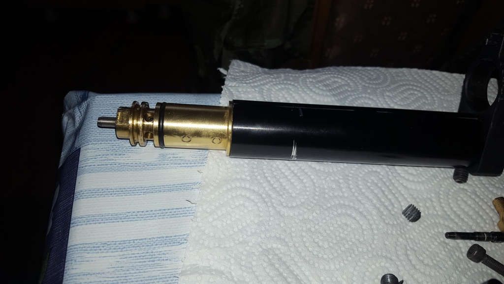

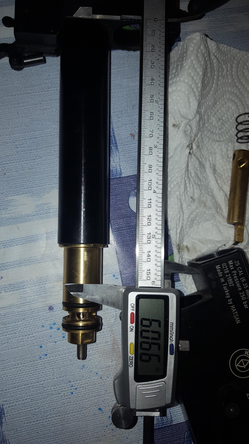

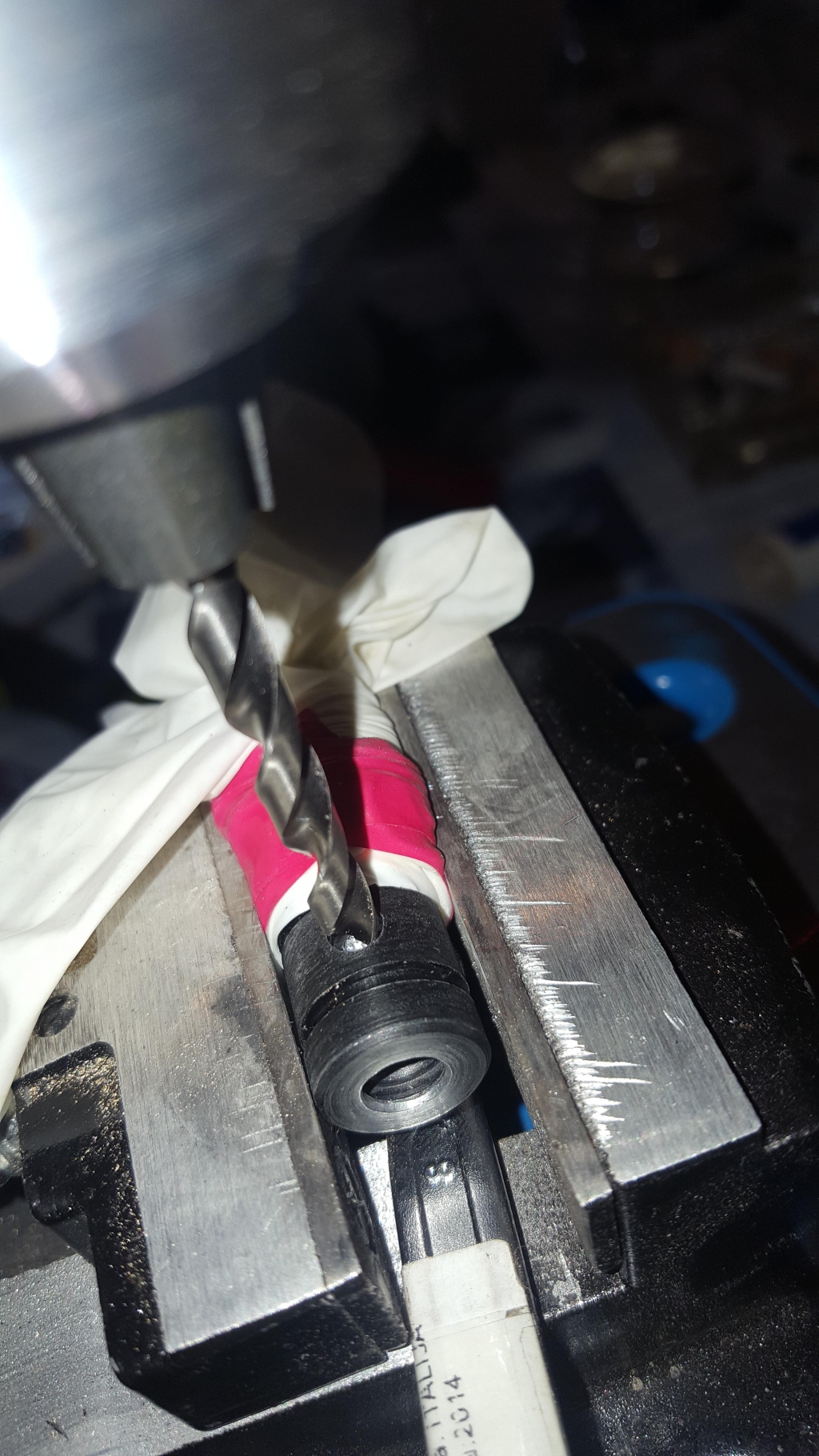

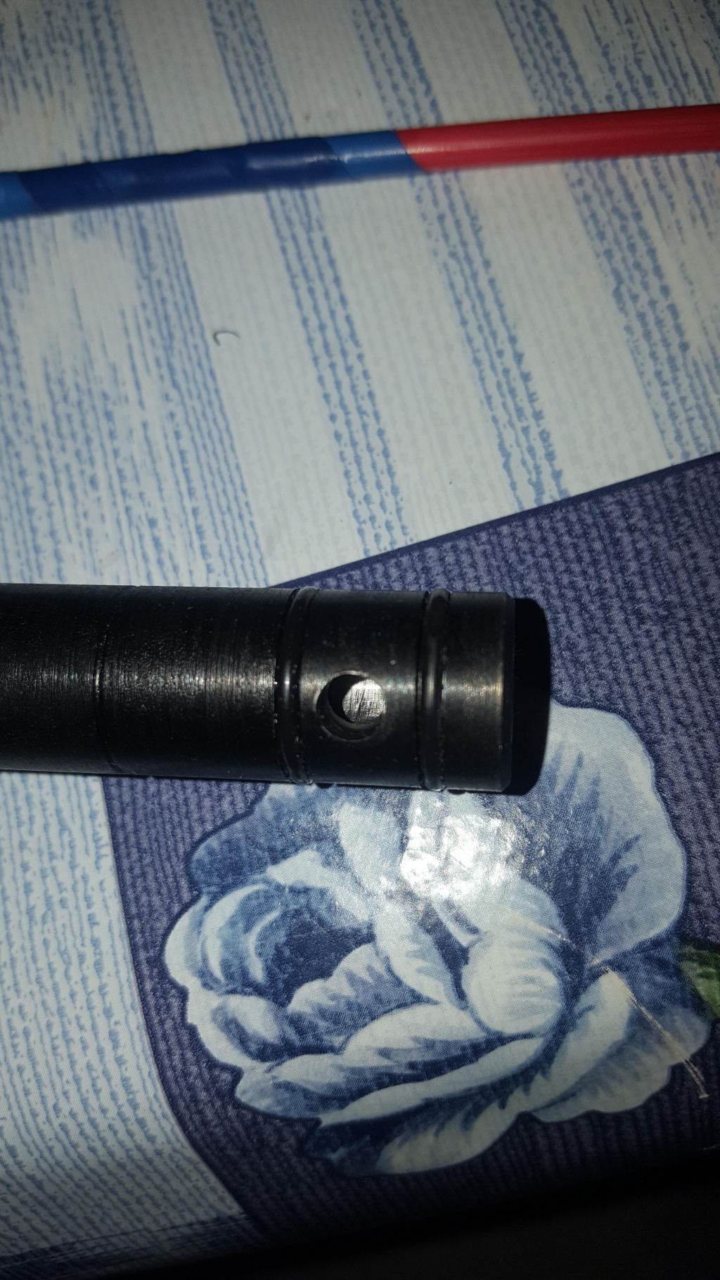

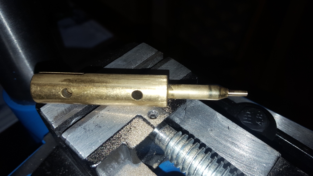

Need some advice at barrel port.

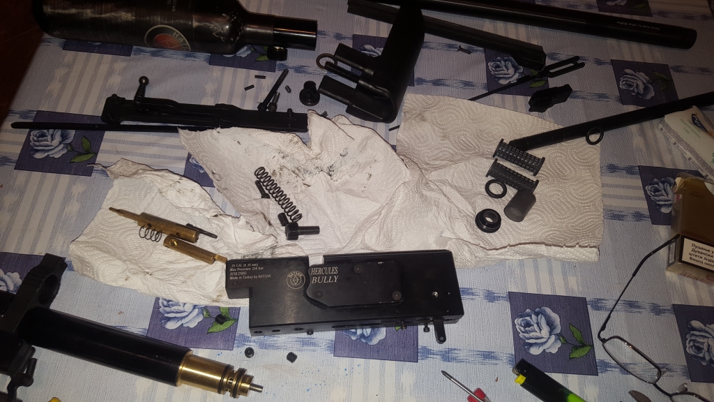

I take out the bullys barrel to see how big tje barrel port is.
The caliper shows 0.181
I want to shoot pellets and slugs
Can i make it bigger? Is my question or longer to 0.200 or 0.195.

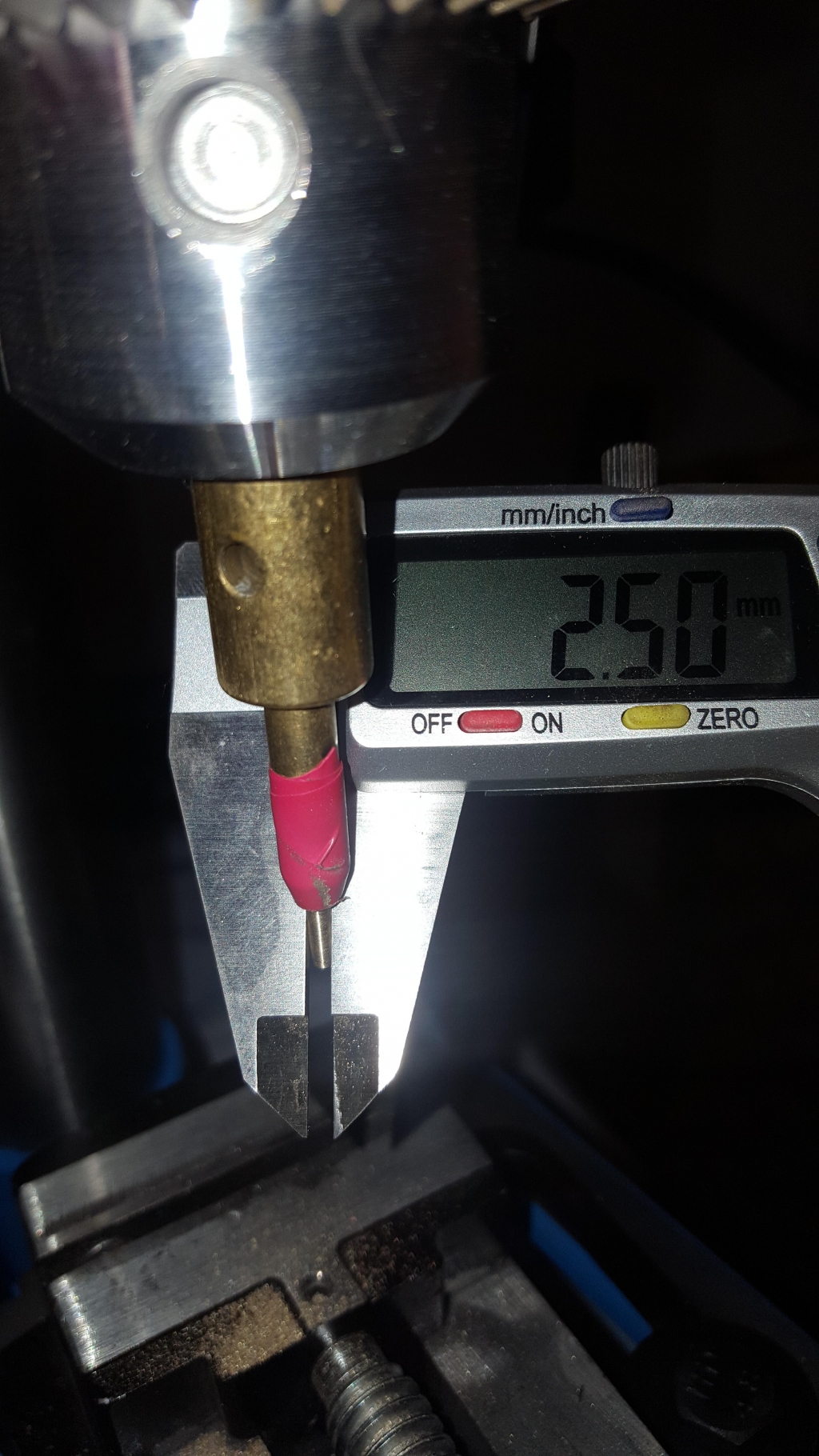

The pellet probe has 0.137 i think it will be stable at .0100.

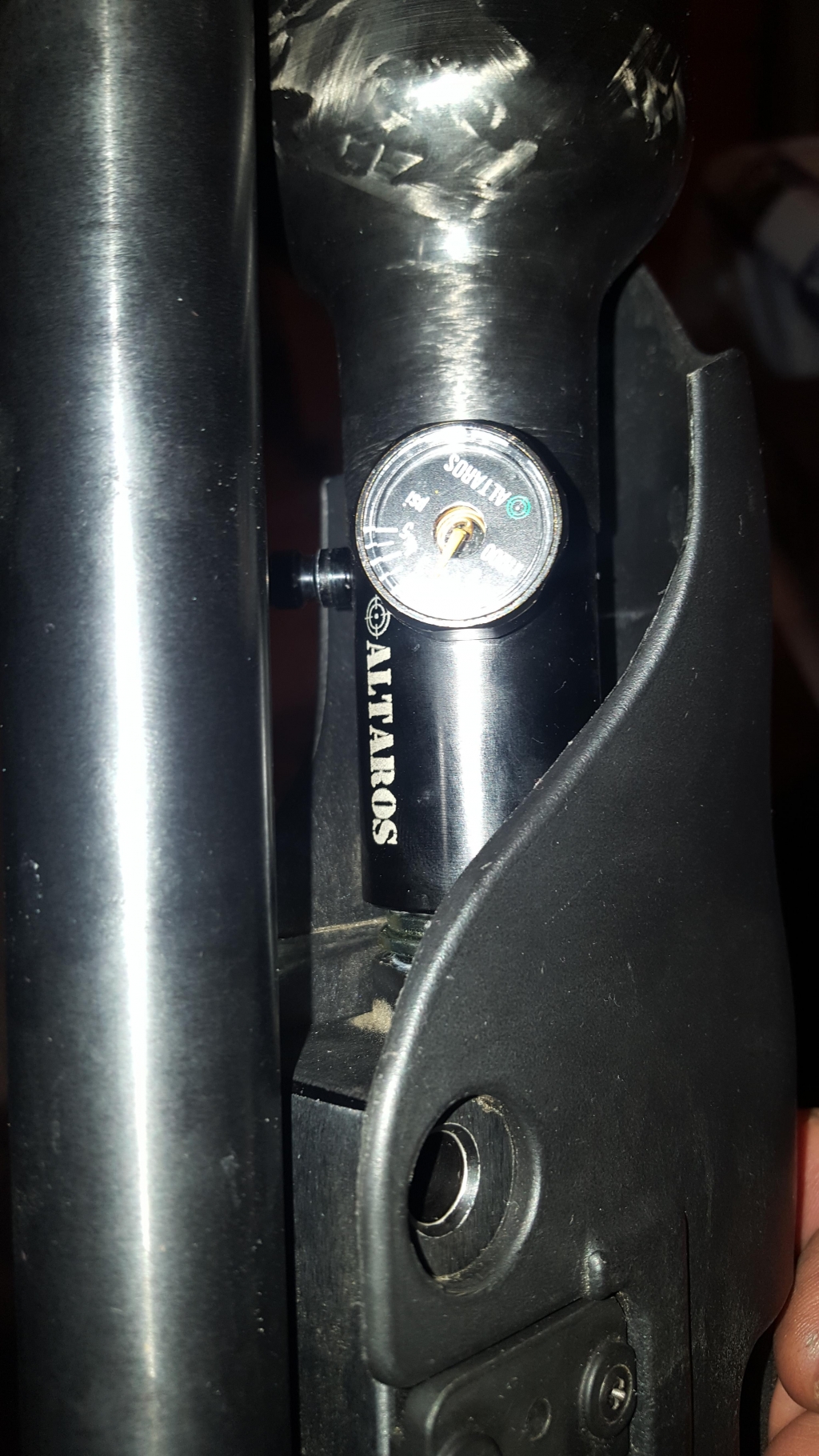

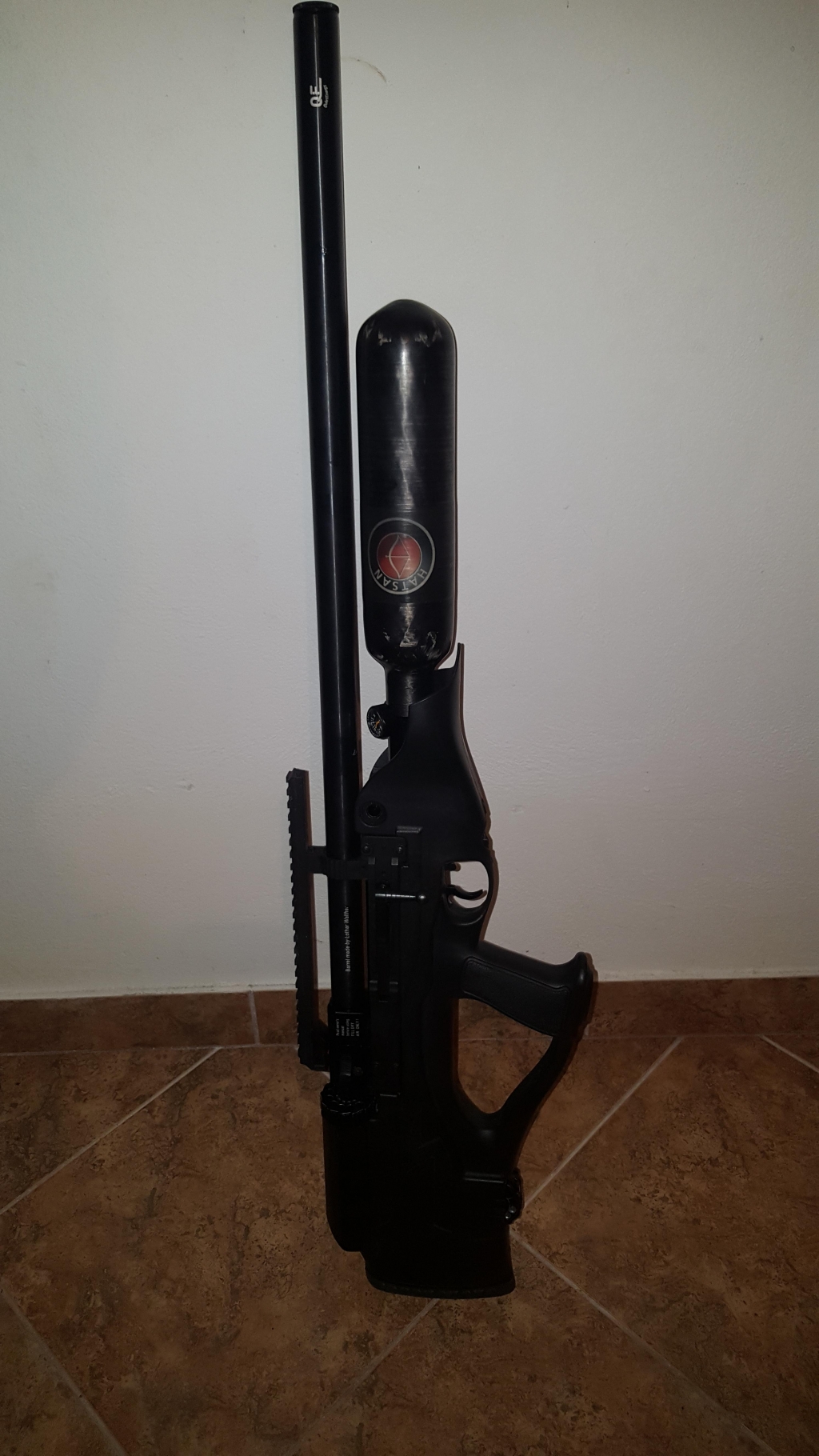

I have instal a Altaros regulator.
Altaros send me on that i can adjust to 170 bars.
Actually it is on 150 bars and shot the jsb 25 gr at 950 fps and the 34gr at 850 fps at lightest hammer spring set.
Like bevor at that pressure without reg
Have no fps drop with the reg it seems like the plenum in the gun is large enough.
Tomorrow i install the scope and make some string test.
Gun look with the reg not bad

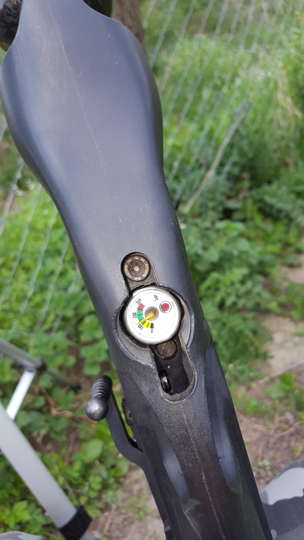

The reg pressure was not 150 bar it was 145 or 140 like on the image

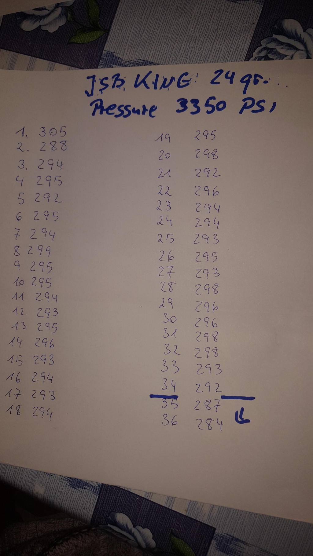

First test was with jsb kings..filling the gun to 3350 Psi
Here the results in meter/second
At this speed tje kings dont perform well
960/970 fps are to fast out my rifle for them
From shot 35 comes the drop

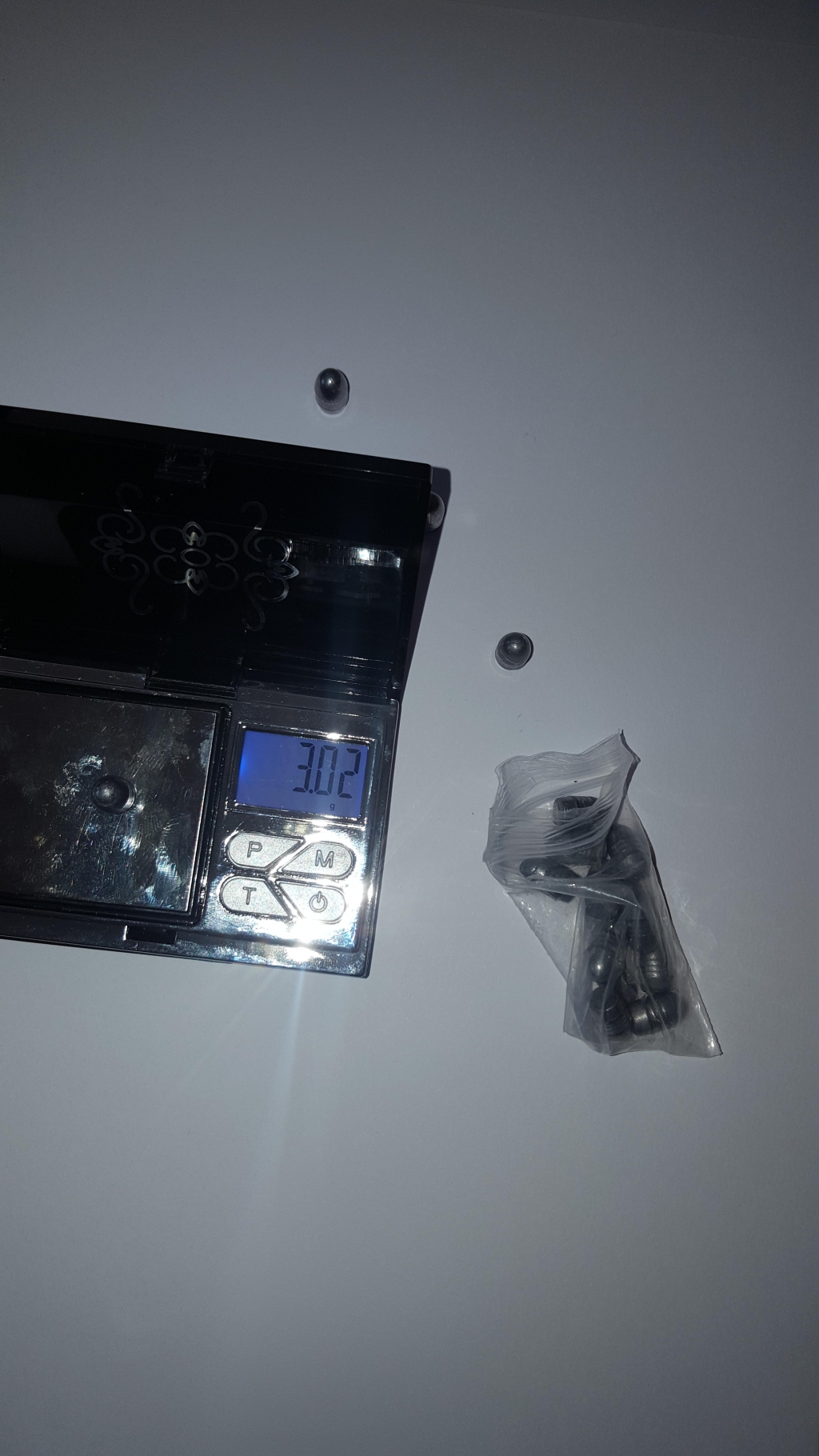

I have cast some slugs with a mp.mold and shot just for fun a few
I know they need a higher pressure not just 145 bar
Dont perform good at 750 fps

With the cast slugs 48 grains velocity
Before portwork and probeworke was 820 fps...after 903 fps or 11 fpe
Sttrange that with tje pellets i have no changes at max power just gaining more speed at lower psi but it reaches a maximum and more pressure dont give more speed.
With the heavier slugs this little porting give me 80 fps.more speed very stabel from 250 till 300 bar after it drops
