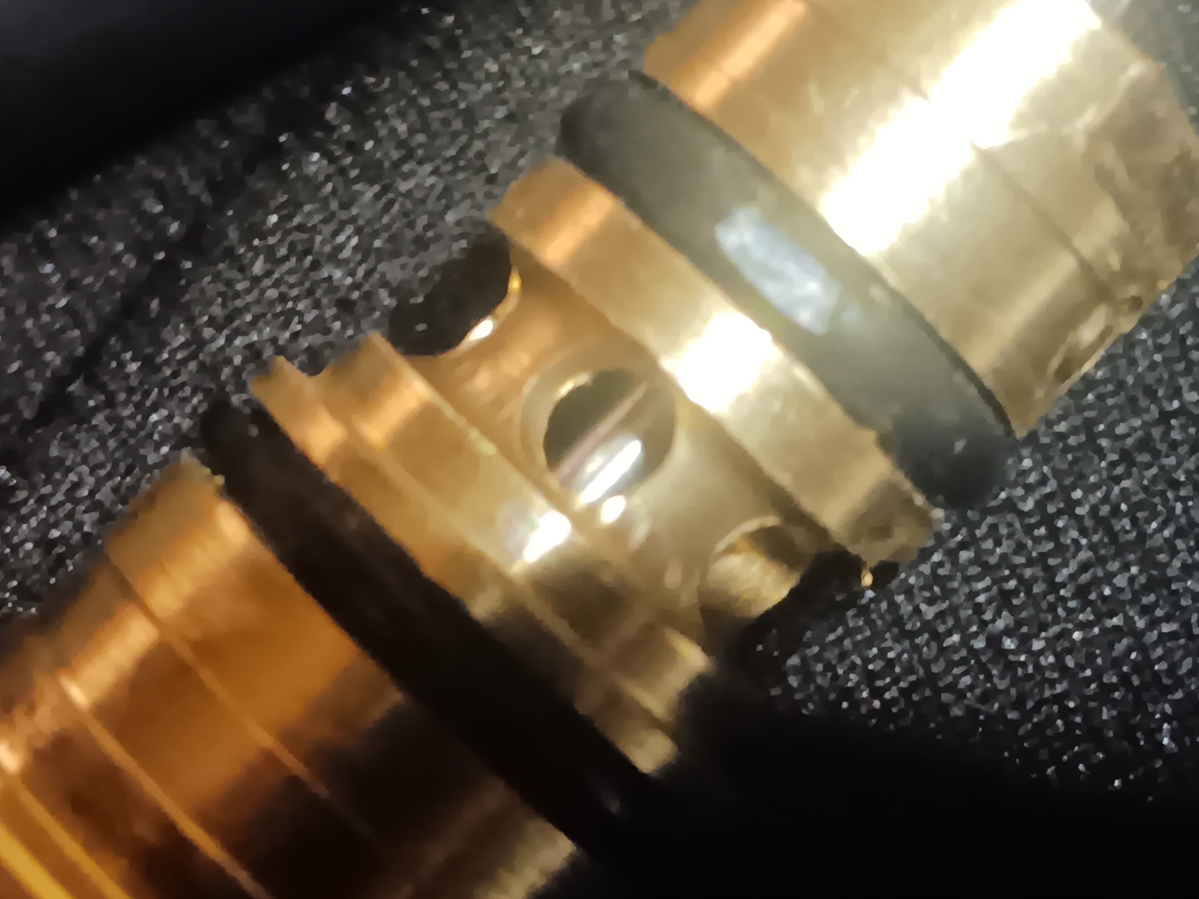

I have come across similar issues with my Hatsan factor (The UK version) and tracked those to a manufacturing issue with part 5951 in that parts list shown in the post here.
There is a hole drilled through from the base and while the holes were plugged, they left razor sharp edges near the front of the hole the drop block is fitted.

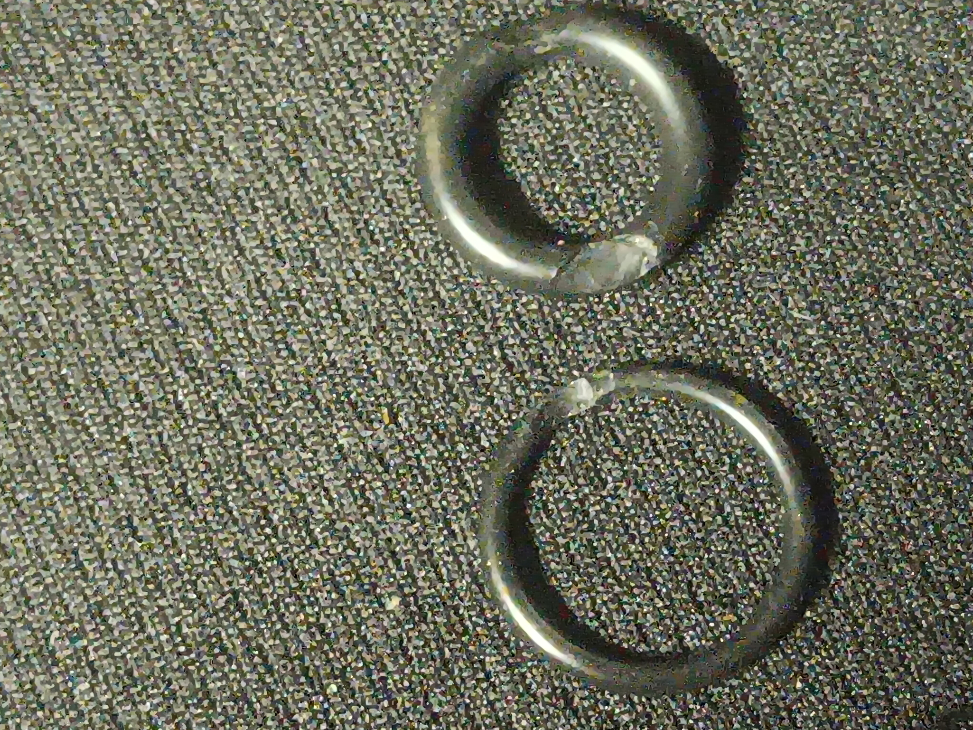

I'll have to use a countersink tool to debur the shoulder in that slot, then either fill, or de-edge those holes to mitigate the damage, since they have pretty much destroyed EVERY freakin o-ring I tried to use :(.
Since the gun is in bits right now, I'm going to replace all the seals, including the ones KatoKevin454 mentioned, while I'm at it.
Glad I found this thread and saw KatoKevin454's post, because replacing the two in the above image didn't resolve the leak on mine 🤬
