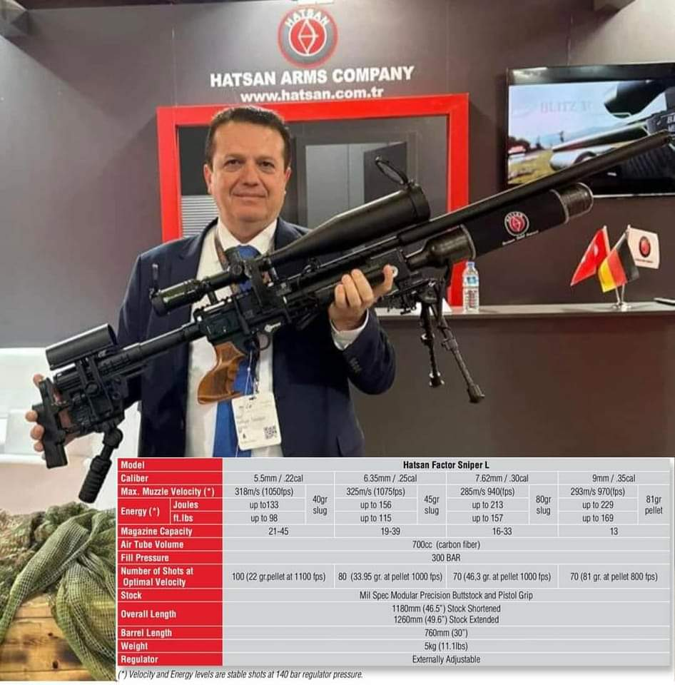

here you can see the owner of Hatsan doing chrony results. the gun is in 6.35mm
First 5 shots were using Hatsan Slugs 45 grains
Second 5 shots were using 34 grains JSB pellets.

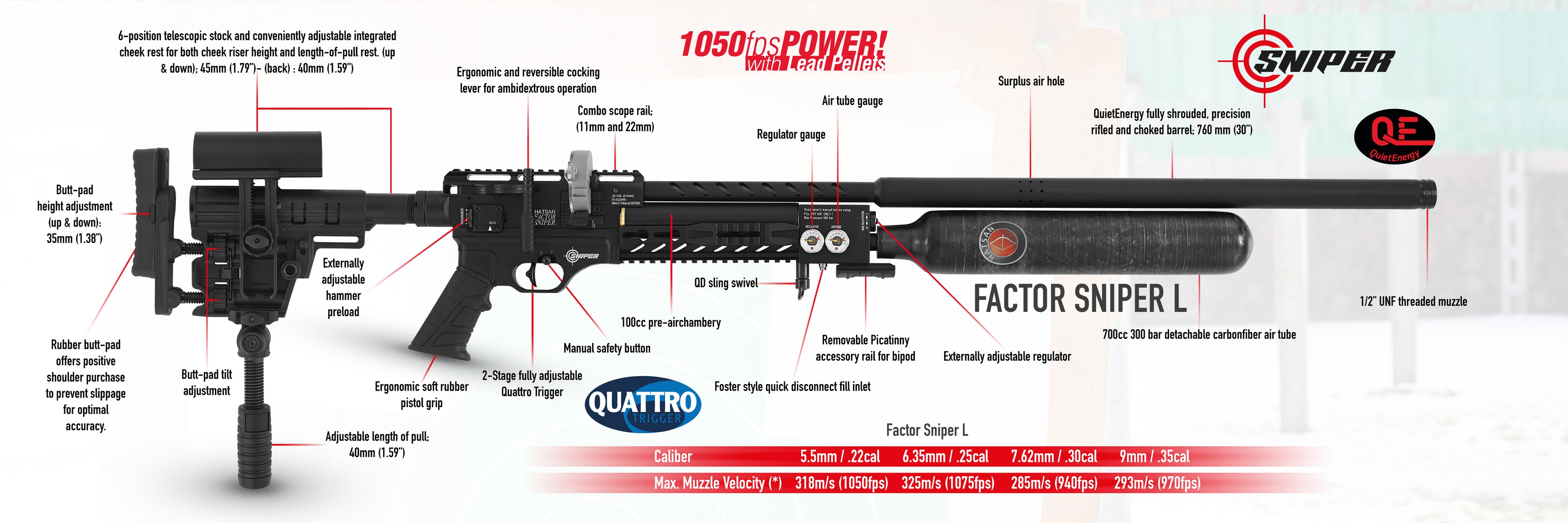

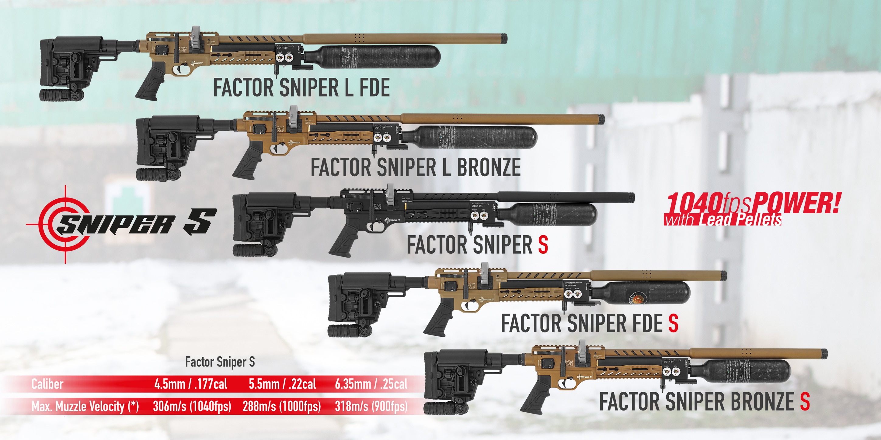

I will buy the Factor Sniper L later this year and to me it looks like one of the most powerful air rifle on the market at factory settings?
I can't think of another air rifle with over 133 joules in .22 cal and 156 joules in .25? Anyone know a more powerful air rifle in .22 and .25?
Here are 2 pics that were released during IWA 2023 if I remember correctly, that shot show in Germany. From numbers listed between the Sniper S and L it seems the L gets about 175 more fps in .25 compared to the S but for .22 it's only 50 fps more. I do not know if the L is available in .177 nor if the S is available in .30 and .35.

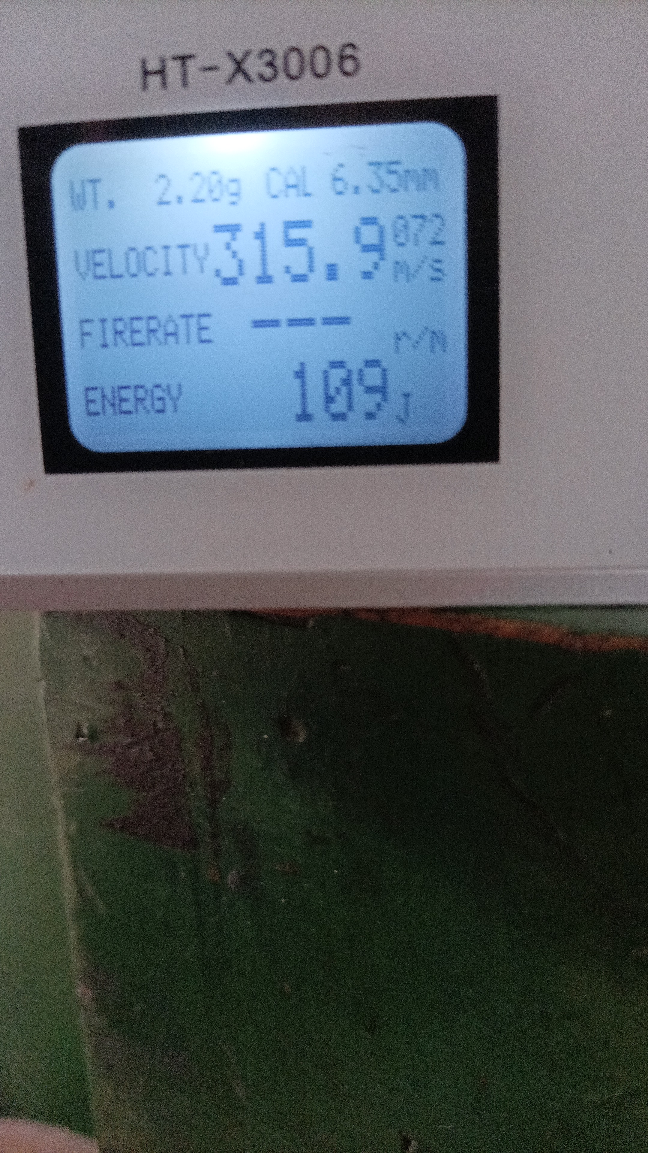

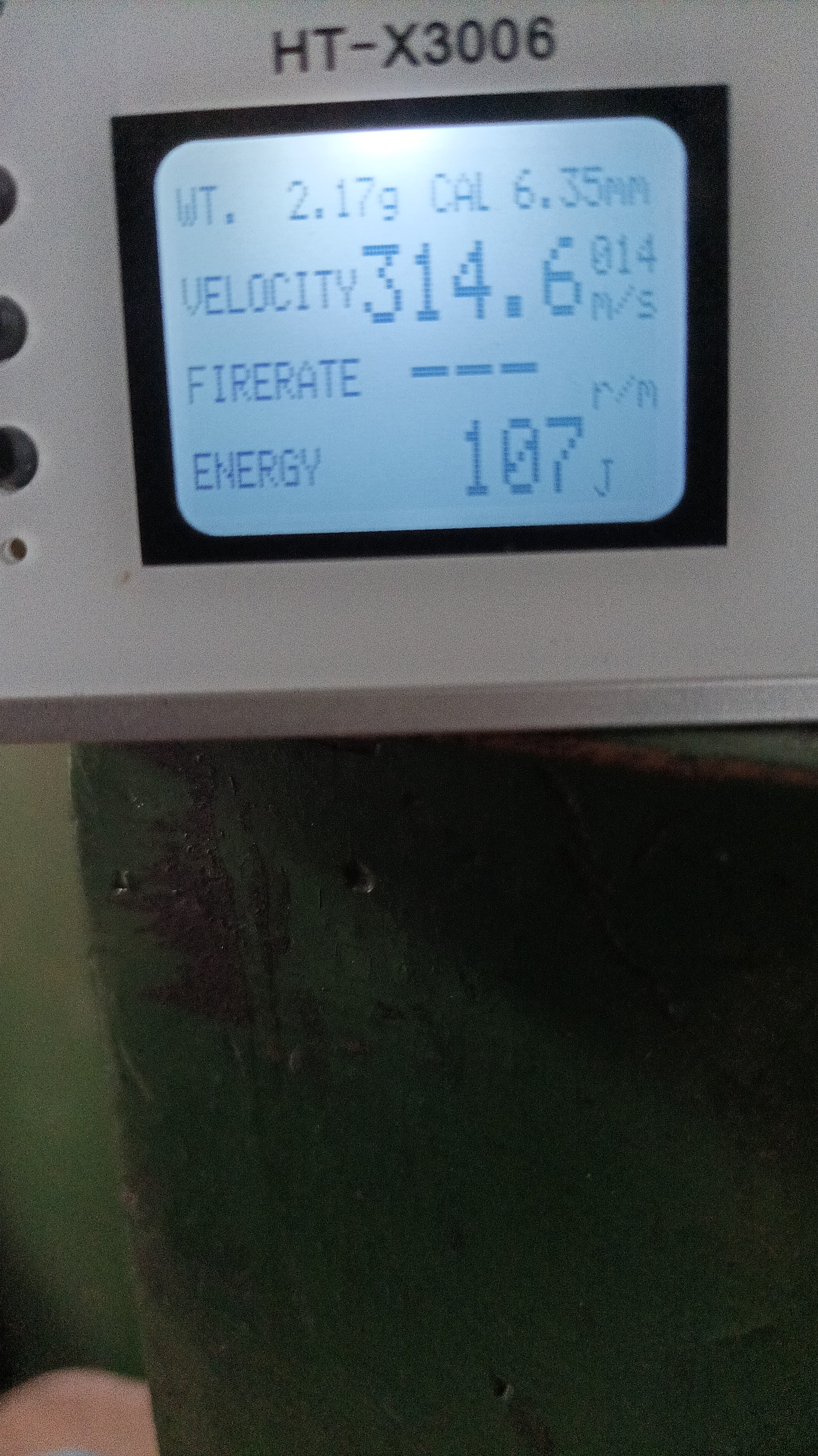

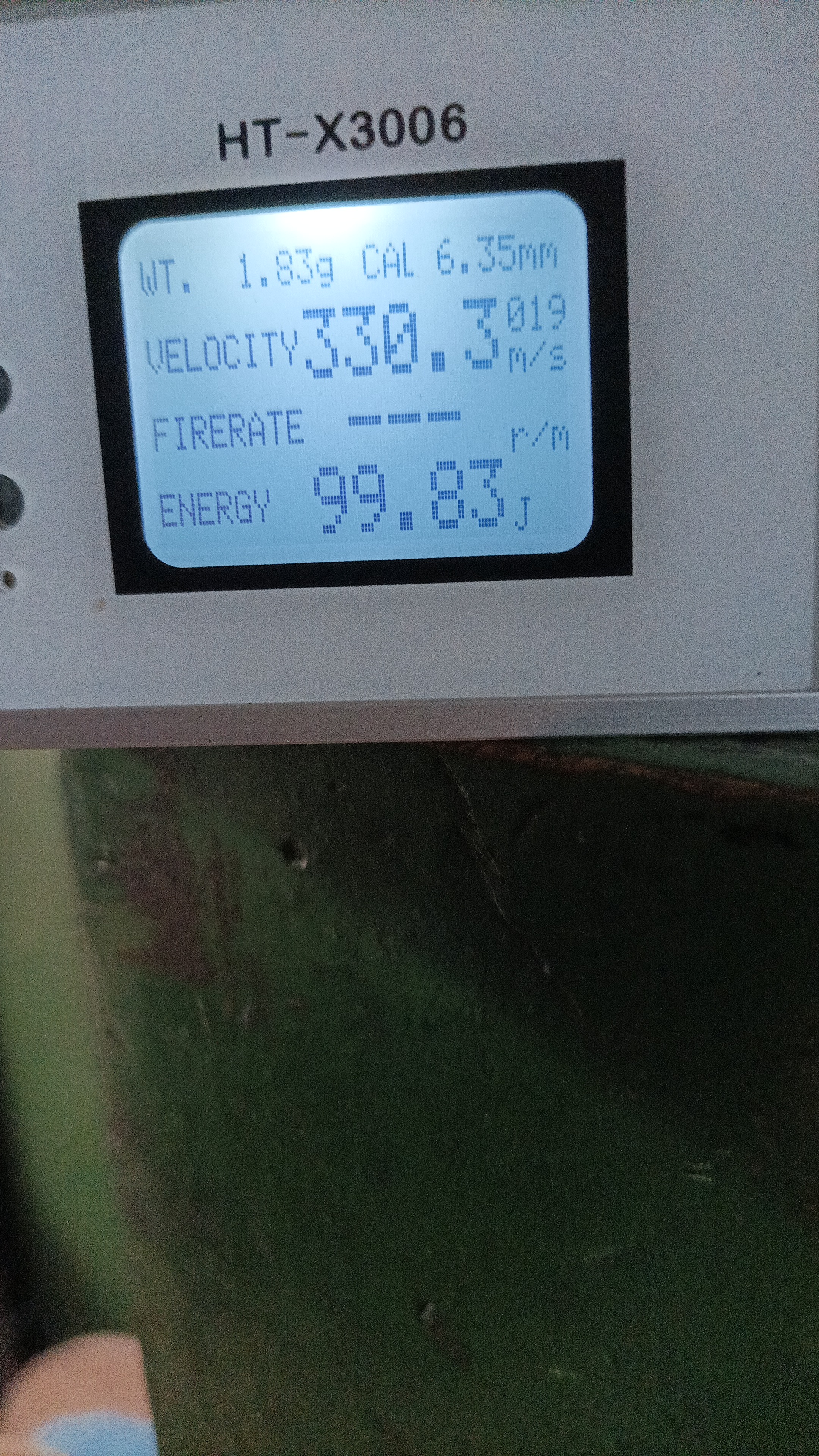

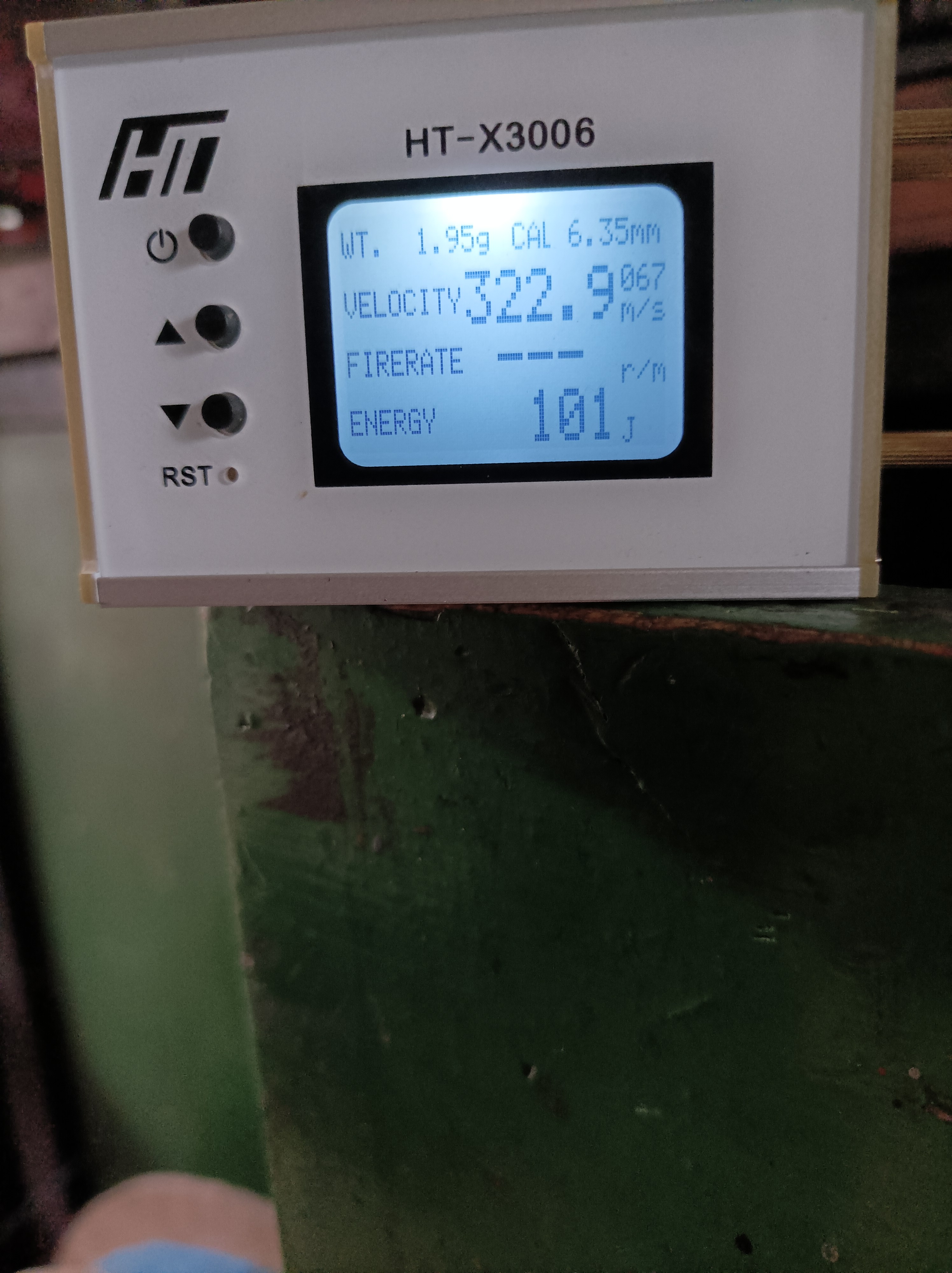

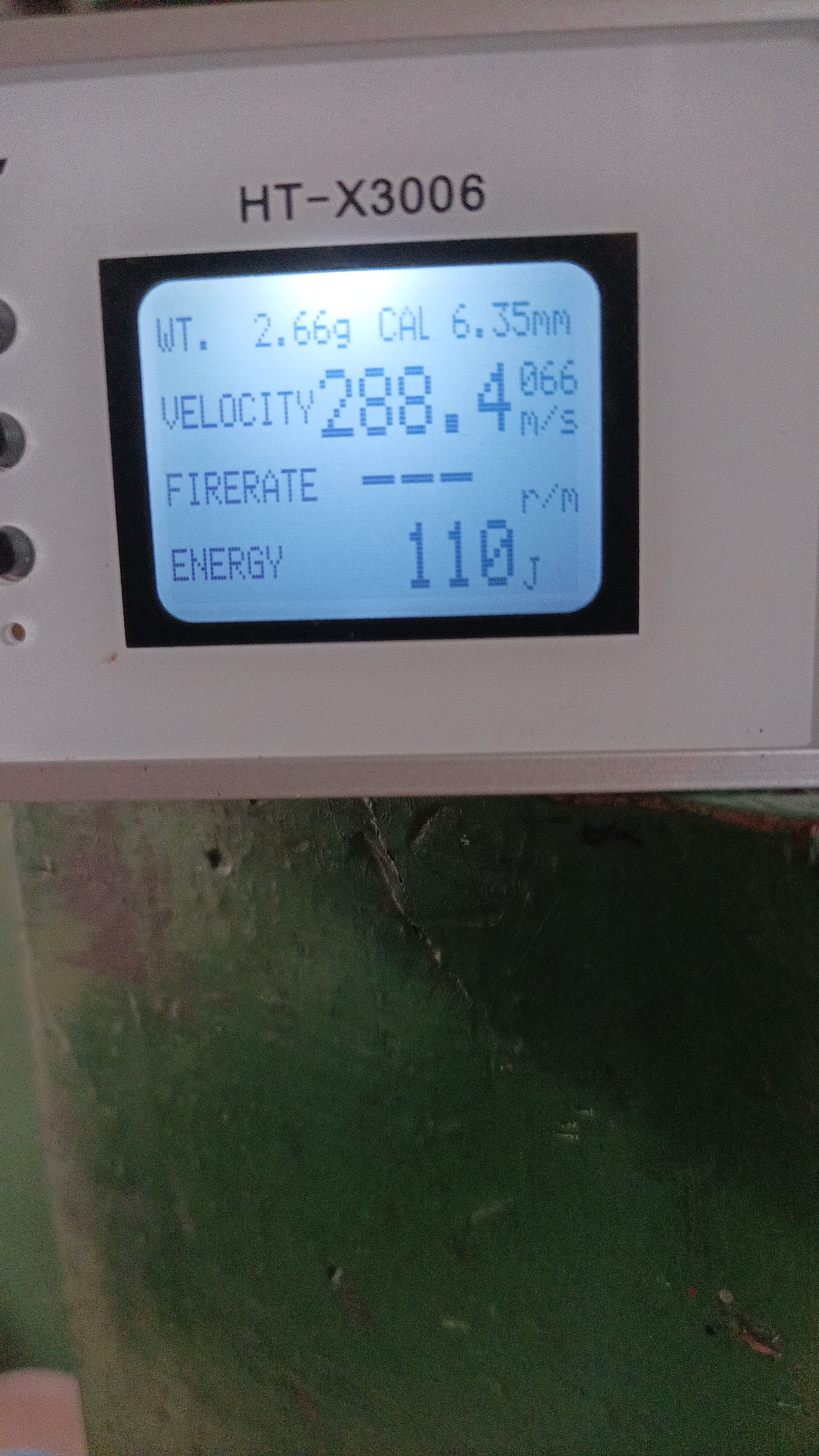

I just wanted to inform you that it is nice what the manufacturer states, but the truth is that the result is completely different. is much worse than stated because at the maximum setting of the weapon it reaches a maximum of 120 joules at 300 m/s and a 41 grain slug at 250 bars on the regulator, which is the maximum that can be set.
I have no idea if it's an internal defect. but the seller tells me that it's okay because the gun may not reach the declared performance.
hello everyone, I'm new here but the owner of this beautiful airgun.
250 bar on the reg seems like a ton... That much pressure seems like it would slam the valve closed really fast and might be working against you. Maybe try taking the reg down to 150 or so and tune from there, you might find that it works better for you.
I tested it from 145 bar to a maximum of 250 bar. at 145 bar 82j , 150 bar 84j 175 bar 94j 200 bar 98-110j depending on weight. setting 200 bar see photo

I understand it, but it compares low power gun with high power gun. I was only pointing out that the manufacturer lied about performance. otherwise, compared to previous hatsan products, it has improved a lot in terms of material and production quality, only that it still can't deliver the performance it claims. the potential of this weapon and design calls for improvement
