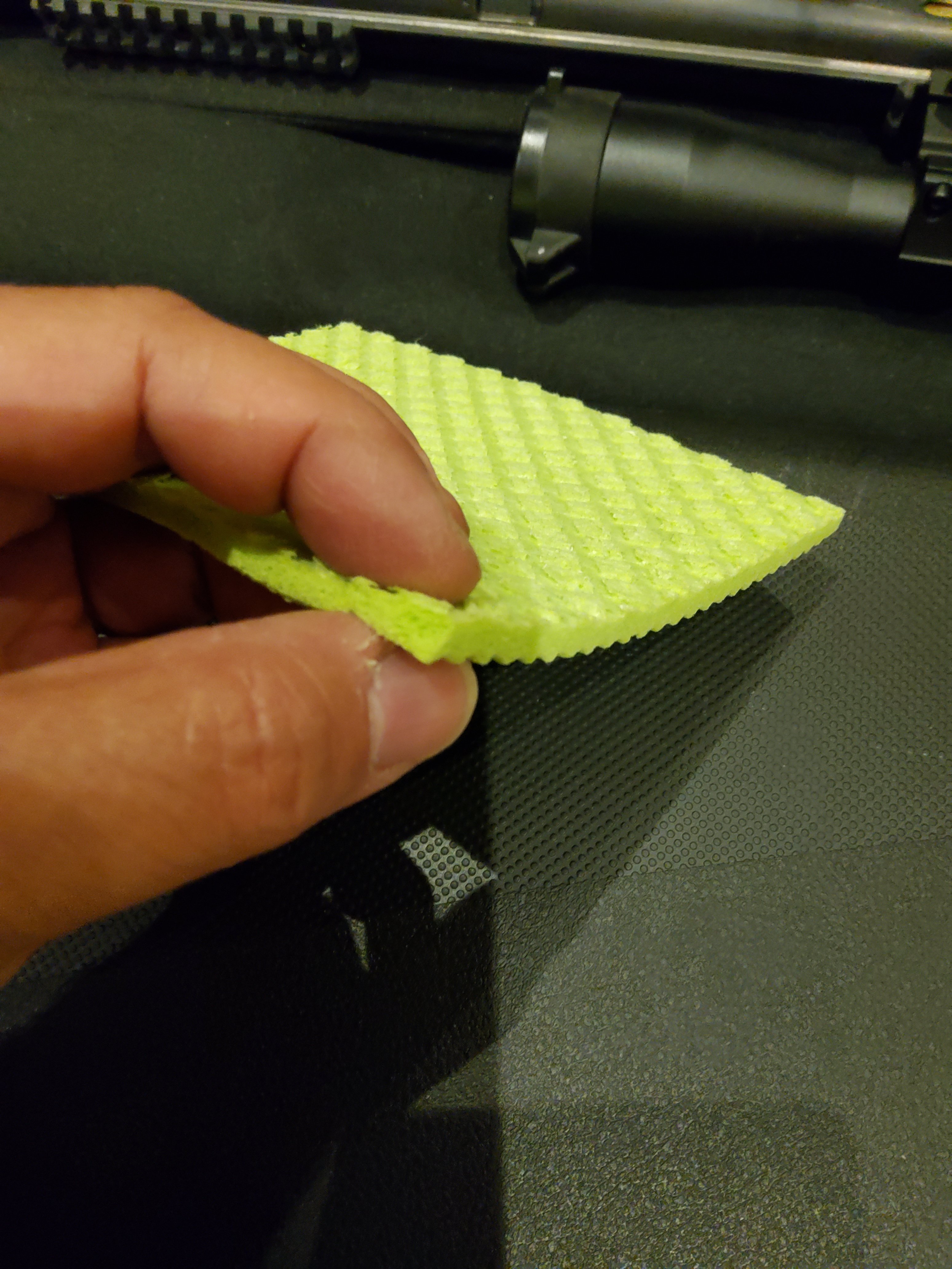

Today my friend shot his after i tweaked it a little and it looks promissing! I wrapped a spong towel on the barrel under the shroud "snug fit" to block the dusty lead air blowing on his his face and closed the shourd vent ports. And shot H&N 40grain .22cal "0.218" @ 945ish FPS Hammer set to MAX and reg pressure @156ish "can't tell exactly with analog guages". groups really well @50 meters and @100 meters! really good results! and we hit some metal frying pans @170 meters "didn't check the grouping at this distance tbh!". on the up comming days we will shoot it more and i will get you some pictures!
*P.S. that was the spong. i will get you the brand later.

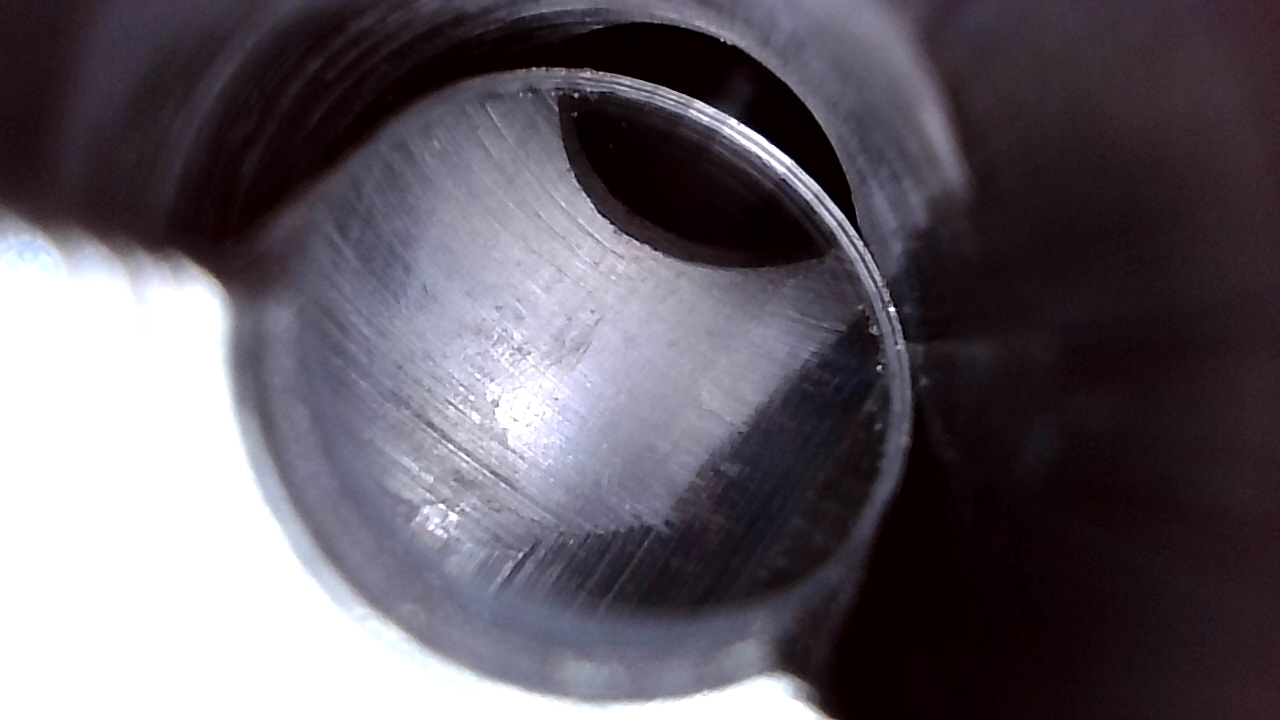

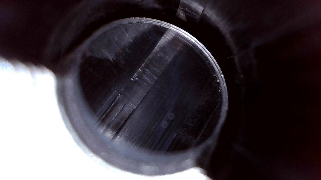

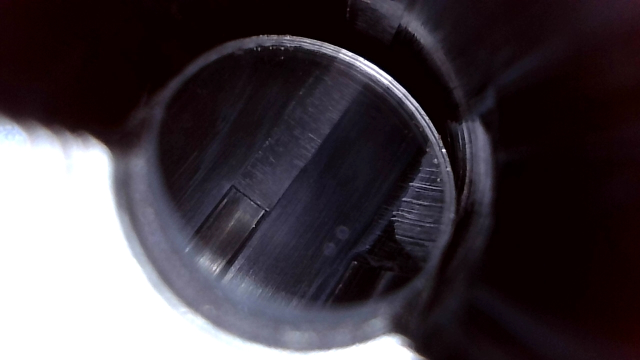

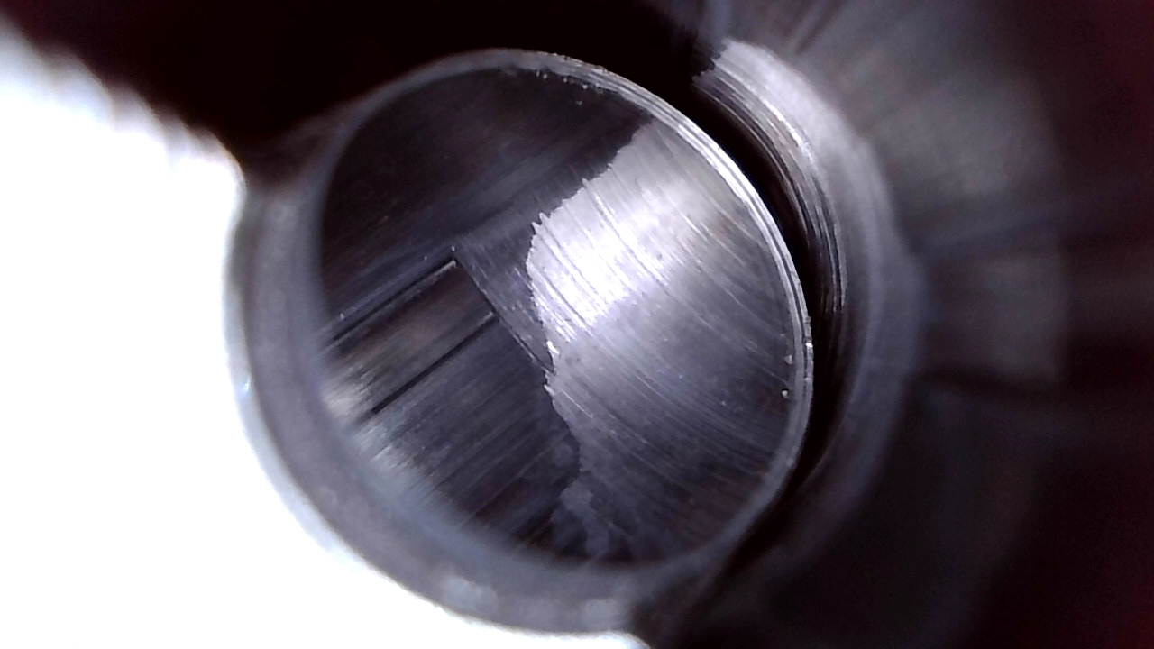

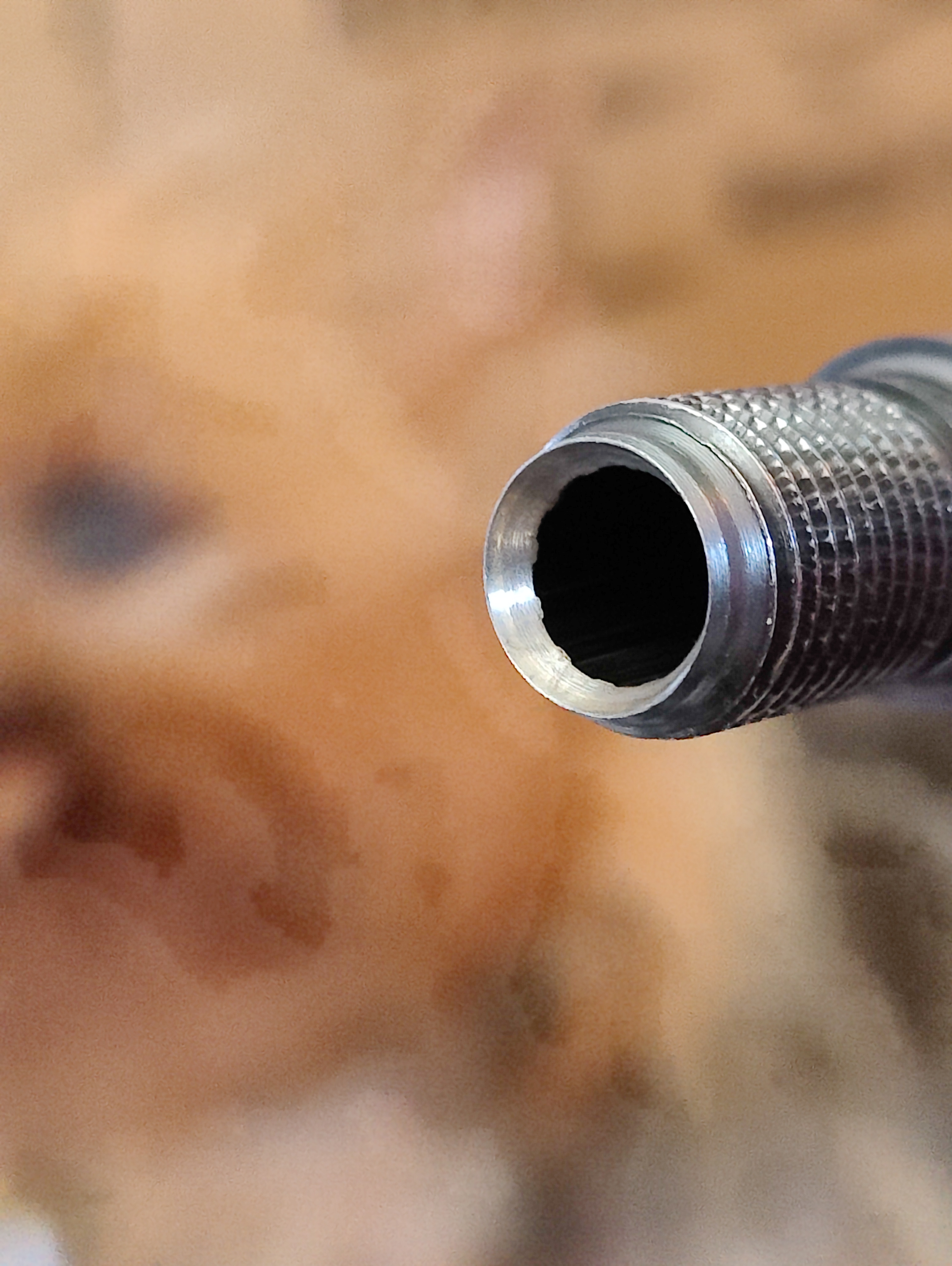

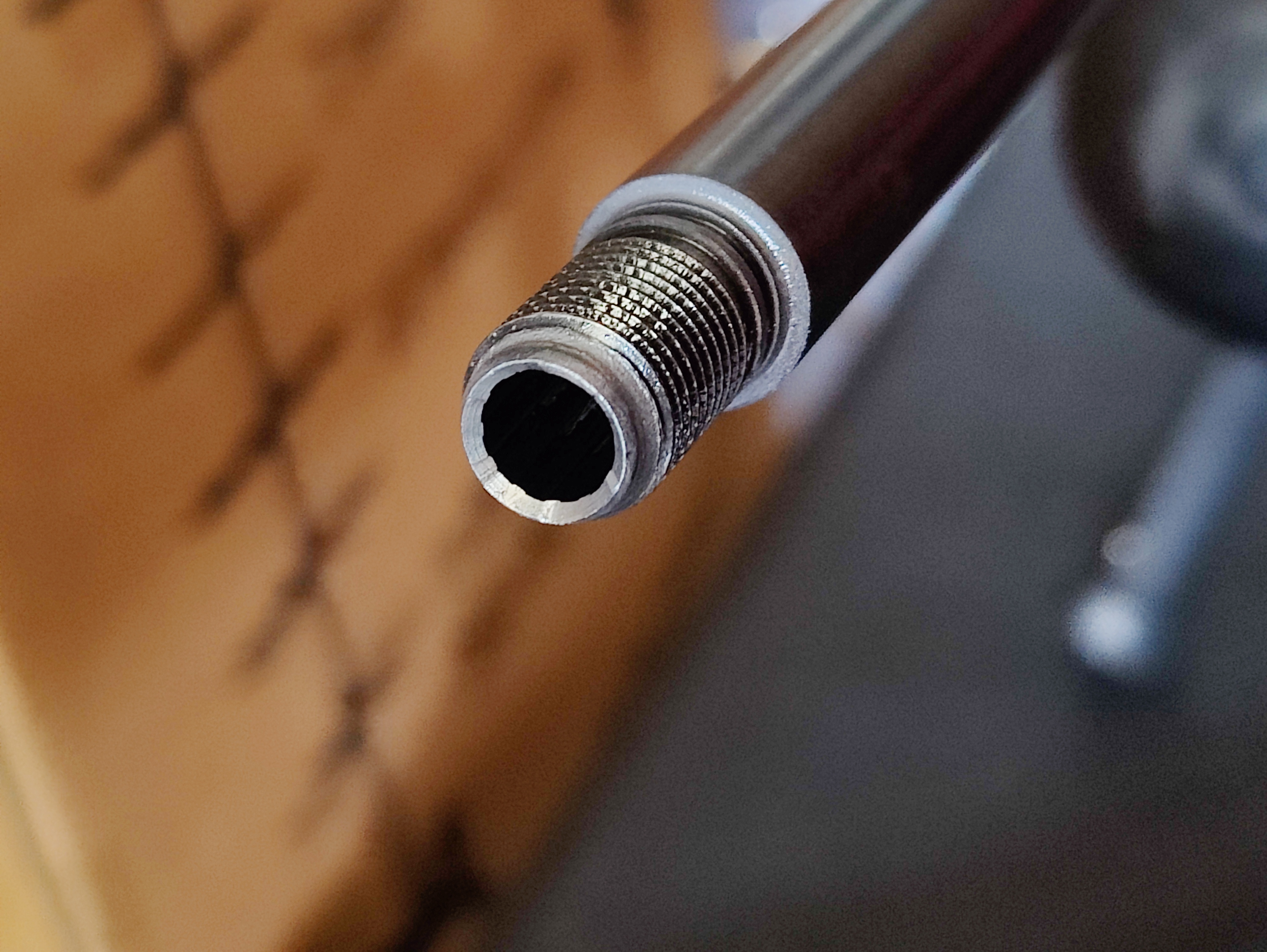

Push a pellet down the barrel with a wood dowel. If the pellet is noticeably loose when it exits the muzzle, you are not going to get good results. Also inspect the pellet to see what kind of marks are left on it.
FWIW the two .25 cal snow peak barrels I have have fairly rough crowns, but I have not touched them since they both shoot lights out.
Reactions: stephenst4470
I would have left that one alone if it didn't shoot so bad, but with how it's shooting I figured it couldn't hurt to clean it up.
Reactions: Long_Gun_Dallas
I'll pull the barrel this weekend and push one through from the breech end and see what it looks like. I've got a 1/4 inch dowel lying around that should work fine. It's a choked barrel, so presumably it should tighten up at the muzzle.,,
