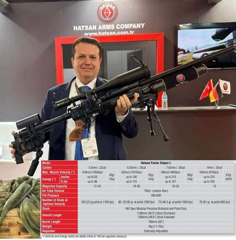

Just saw this on a turkish airgunforum, my god that is a long rifle.
This model hasn't been out yet on the turkish market, i think it will come soon though.
@Asbestos
here you can see the owner of Hatsan doing chrony results. the gun is in 6.35mm
First 5 shots were using Hatsan Slugs 45 grains
Second 5 shots were using 34 grains JSB pellets.
