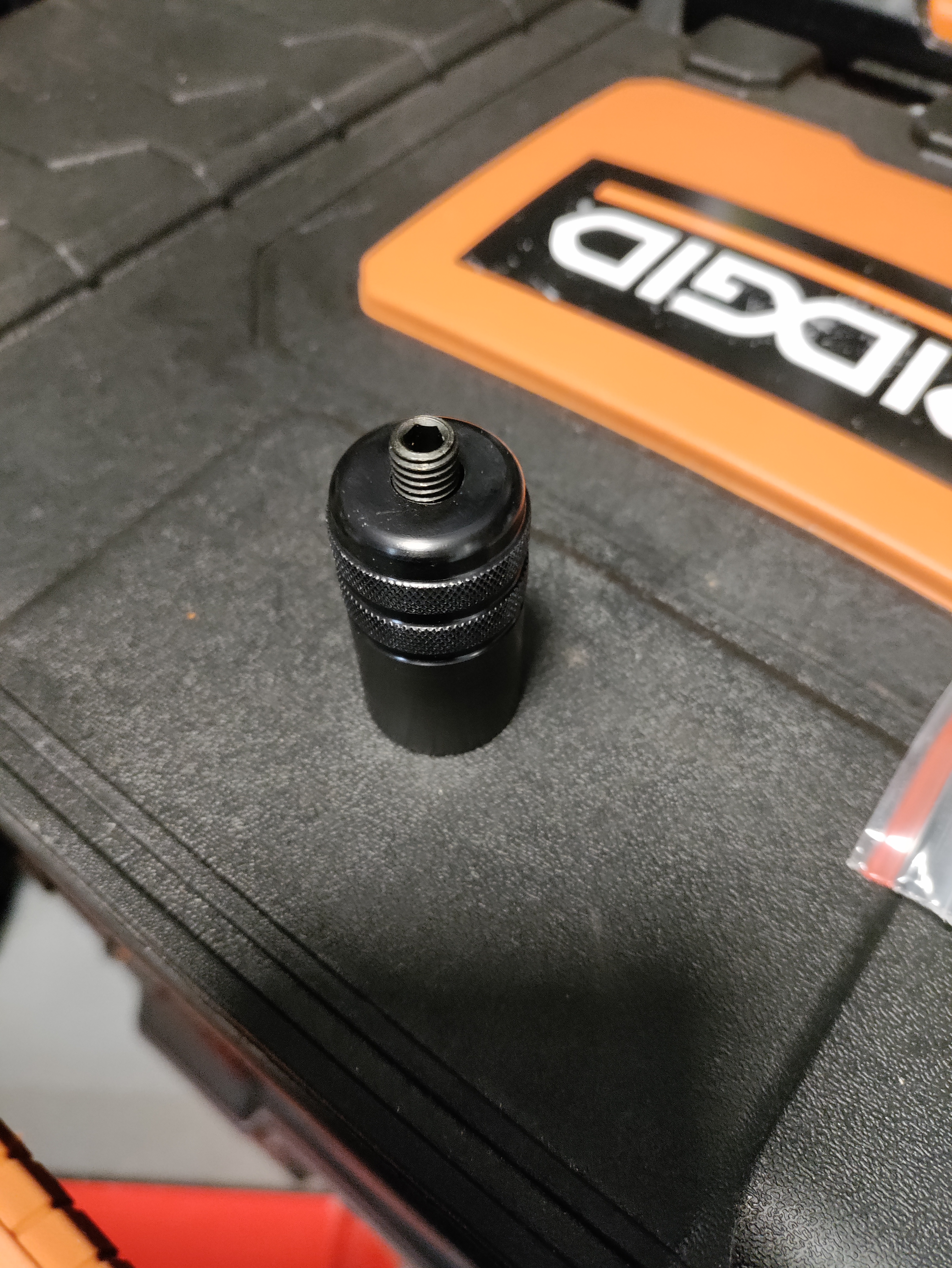

Hi All, just got my Hatsan invader .25 also , I have 2 question
1. when the airgun fires - there's a noise of a spring, is that normal, its Perry loud
2. I got a part int he box and I dont know what its for, uploading a picture, anyone knows what this part for ?
