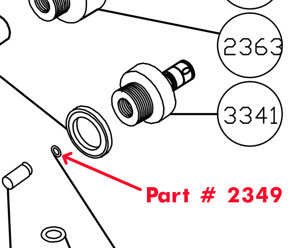

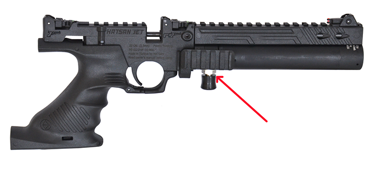

If you can't return it and you don't want to send it back to Hatsan, you might want to try replacing the O-Ring in one way valve on the fill quick connector. You could also place a parts request on their website to see if they will send you a new O-ring or maybe a complete quick connector assembly at no charge. I am assuming that part 2349 in the parts diagram is the one way valve O-Ring seal but they don't list the part names on the PDF.
Sometimes a small drop of airgun / O-ring compatible silicone oil dropped into the opening on the fill connector and letting it settle down in there with the opening pointing up for a while before testing it, will make it seal.
