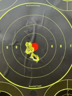

Here is a 7 shot magazine shooting the .25 Polymags at 25 yards. This is sitting, supported by my knee, using iron sights.
