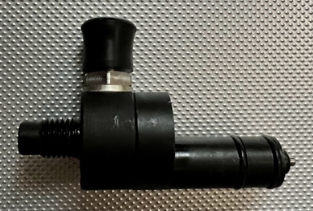

Since I converted one of mine to a Jet 2, I also have a spare valve assembly, which is the part the cylinder screws onto. That could probably be used to fill the air cylinders off the gun... But, I have not tried it.
