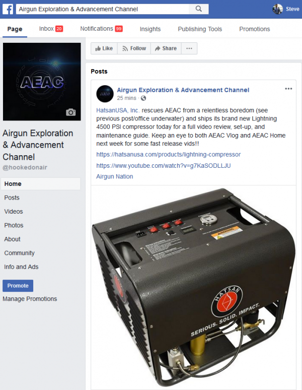

Hatsan Lightning 4500 PSI Compressor ships to AEAC today
Hey guys just wanted to let ya'll know that Hatsan USA shipped the brand new Lightning to me today for a full review, set-up, and maintenance guide vid. Keep an eye to channels, AEAC Vlog and AEAC Home for vids next week... this one I can do from home so I'll be gettin' right on it!
More info; https://hatsanusa.com/products/lightning-compressor
