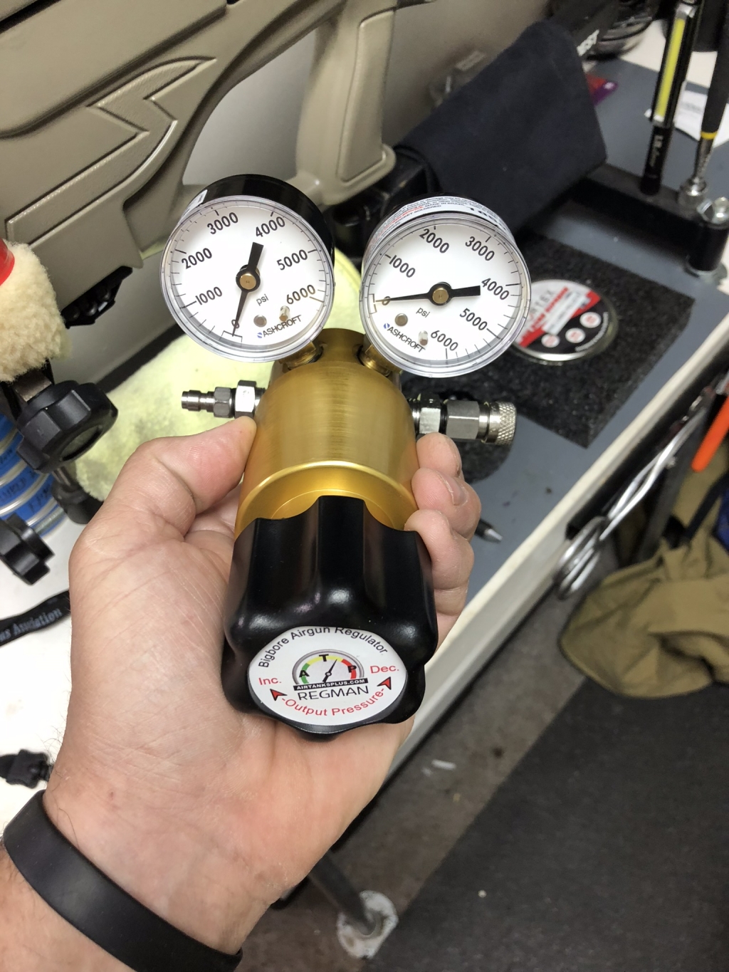

I recently invested in one in one of these -
Man, oh, man! I’ve had my eye on one of these for a long while now, and now that I have one I can’t believe I waited this long. This baby is used for shooting tethered to the tank, and I immediately realize the savings on air consumption cause the only time I bleed from a gun top off is when I’m done shooting for the day. The other day I spent literally 5 hours tethered, and the only time I heard that PFFFFTTT was when I called it quits. Another benefit to this tool is adjusting for sweet spot on pressure that your gun will be the most accurate on. My Bully takes a max fill of 3600 psi and at that max pressure I tend to get around two fliers out of 5 shots, which of course opened up my groups. I dialed my pressure to 3200 on the fly, and then to 3100 psi where the gun shot best, and I never had to reconnect a fill probe and top off the gun, checking to see if indeed 3100 would be the best, guessing away and wasting air from bleeding.
My overall thoughts on this is, if you are a tank owner, and shoot off the bench a lot at paper or prairie dogs, or even a tuner shooting thru a chronograph, this tool is a must have. This Regman pretty much completes an Airgun enthusiast’s air supply arsenal that already owns a compressor and a tank. I picked this up locally from ATP(Air Tanks Plus).
