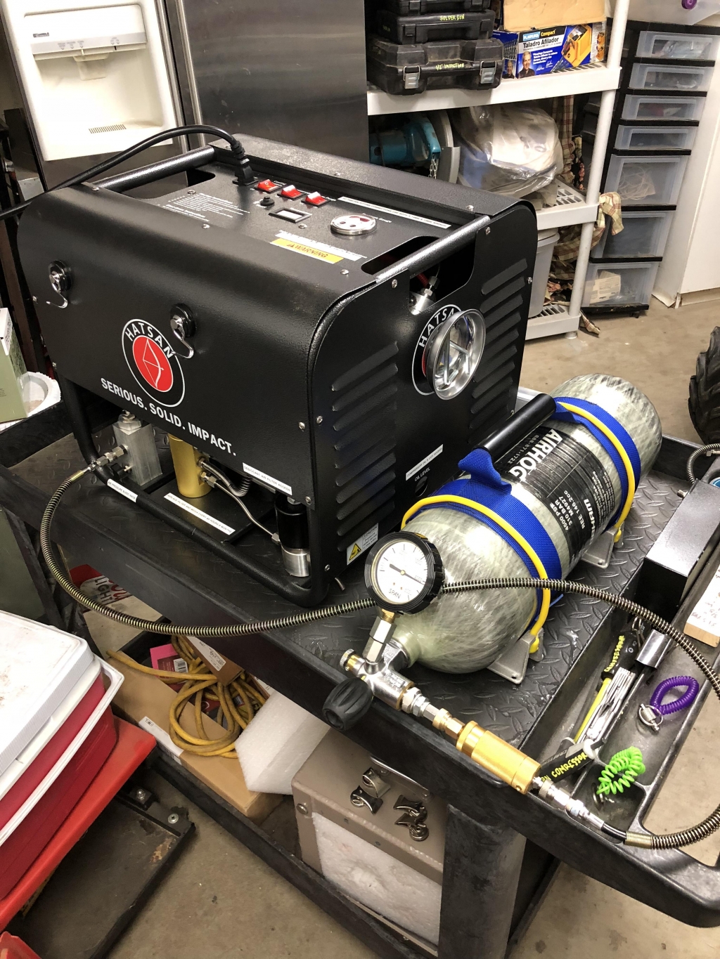

Next month my Lightning will hit a year in age. Since March of this year, I’ve been using it at 3X a month to top off my 88 cu foot tank with the recent aquirement of another 30 caliber in the Wildcat. These 30’s sure suck up the air, but no problem with this Lightning. The auto purge never stops amazing me, and never stops scaring the crap out of me when it blows, lol!
So far this has been an awesome tool!

It took your photo for me to slap myself. Your tool cart set up and the rubber tool mat. Duh, I've got mine just sitting on top of the cart like yours, except mine is steel. Talk about the auto purge being loud!!!

BandG, it averages me 12-17 minutes for a top off from 3200-4500. From 3000 to 4500 about 20 minutes. I have the auto purge set to come on in 10 minute intervals, so for sure I get a moisture pop off in a top off.
SigP220 yes that cover plate you want to raise is on top of the cooling fan. It goes from bottom to top, starting from the bottom- cooling coil, cooling fan, protective plate. I believe the airflow works in that direction, also, so by raising that plate up as much as you can(I was only able to achieve around 3/4”) you’ll free up the air flow path, which will allow the fan to not fight against itself. Your temps will be happy, too.
My oil in the Lightning along with the coolant is still from the initial fill when I unboxed it last July. Oil is still clear looking, no burnt smells. I do plan on changing both oil and coolant next month, as instructed in the owners manual.

SigP- on that rubber mat on top of my plastic 4 wheeled cart, I sourced that from Home Depot. It came exactly at 24” x 30”, the size of the cart on top. I lay that in there and it fit perfect. It is about 1/2” in thickness, maybe 3/4”. You’ll find it in the area where the flooring and carpet materials are at.

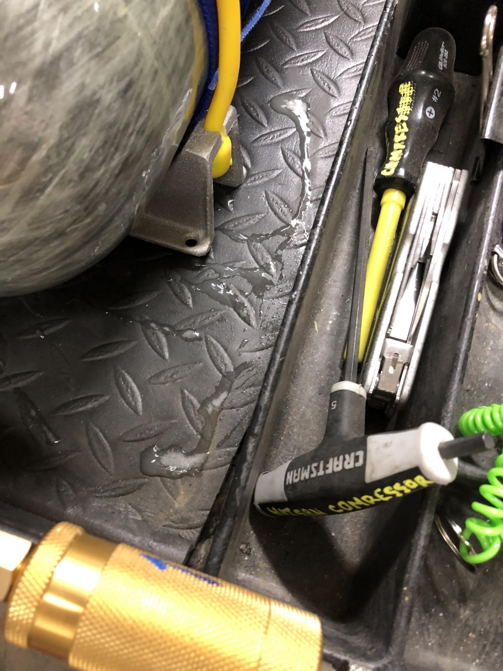

Before I put that mat down, my Airhog tank vibrated so bad from the compressor it wouldn’t stand still, and if my cart didn’t have a raised edge to contain that tank that tank would’ve vibrated off. That mat sure quieted things down, too. That moisture you see on top of the mat, in the top pick? That’s from the auto purge, and that moisture won’t soak into the mat. I have to wipe it off.
