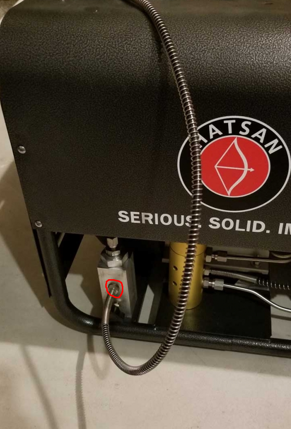

Can someone tell me what threads are on the air output port on the aluminum filter? I want to install a male fill nipple to replace the fixed air line. Thanks.

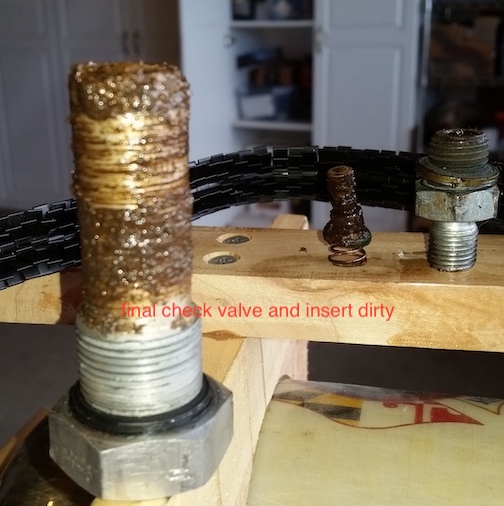

Yes you can turn the aluminum block. It is bolted from the bottom, just loosen and turn. Make sure you clean the inside and the pressure valve on top with every oil change. I have attached a photo of what the inside looks like when you do not do routine maintenance.
can i use 1/8 npt qd nipple on the aluminum block air outlet?
