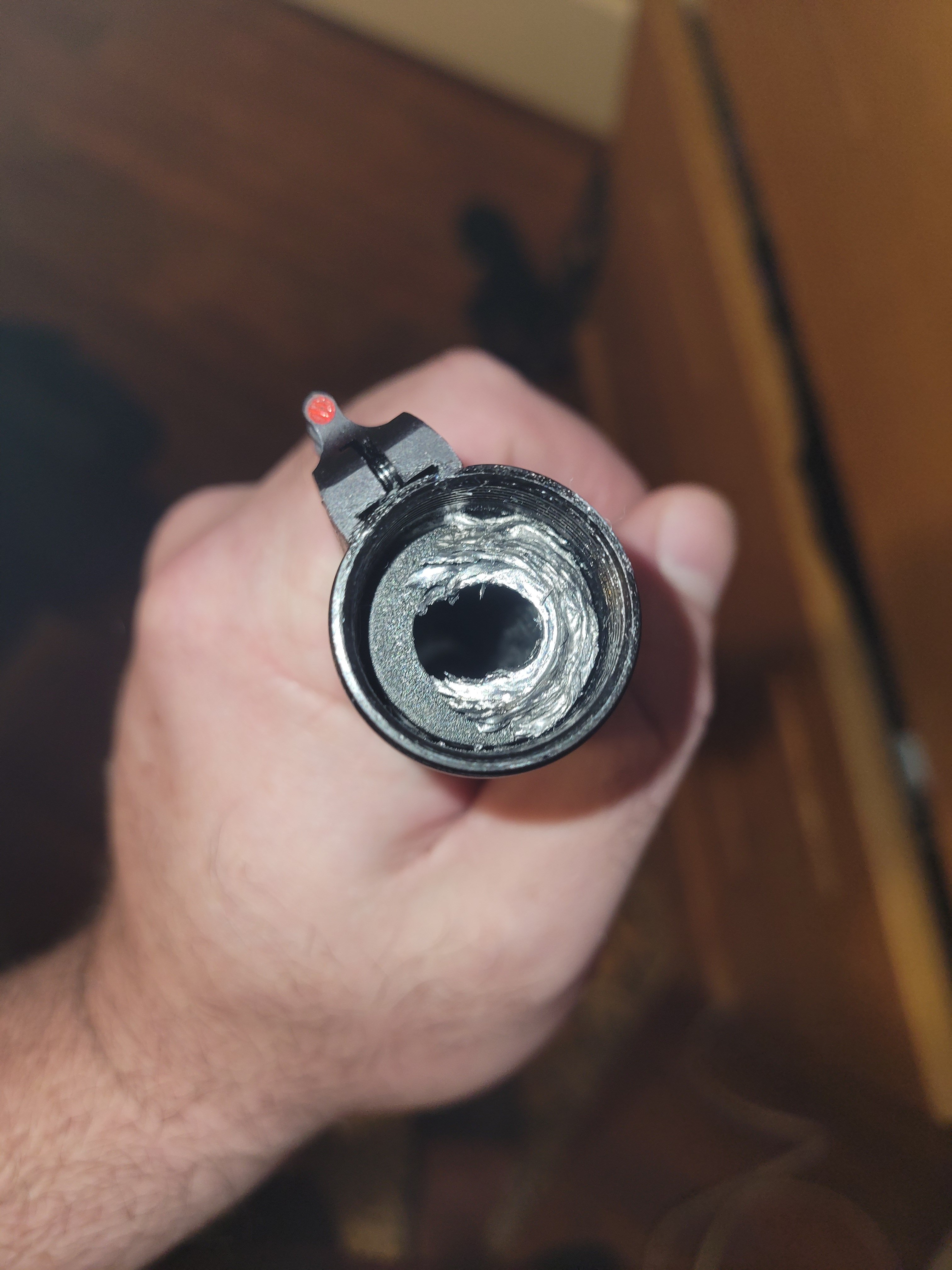

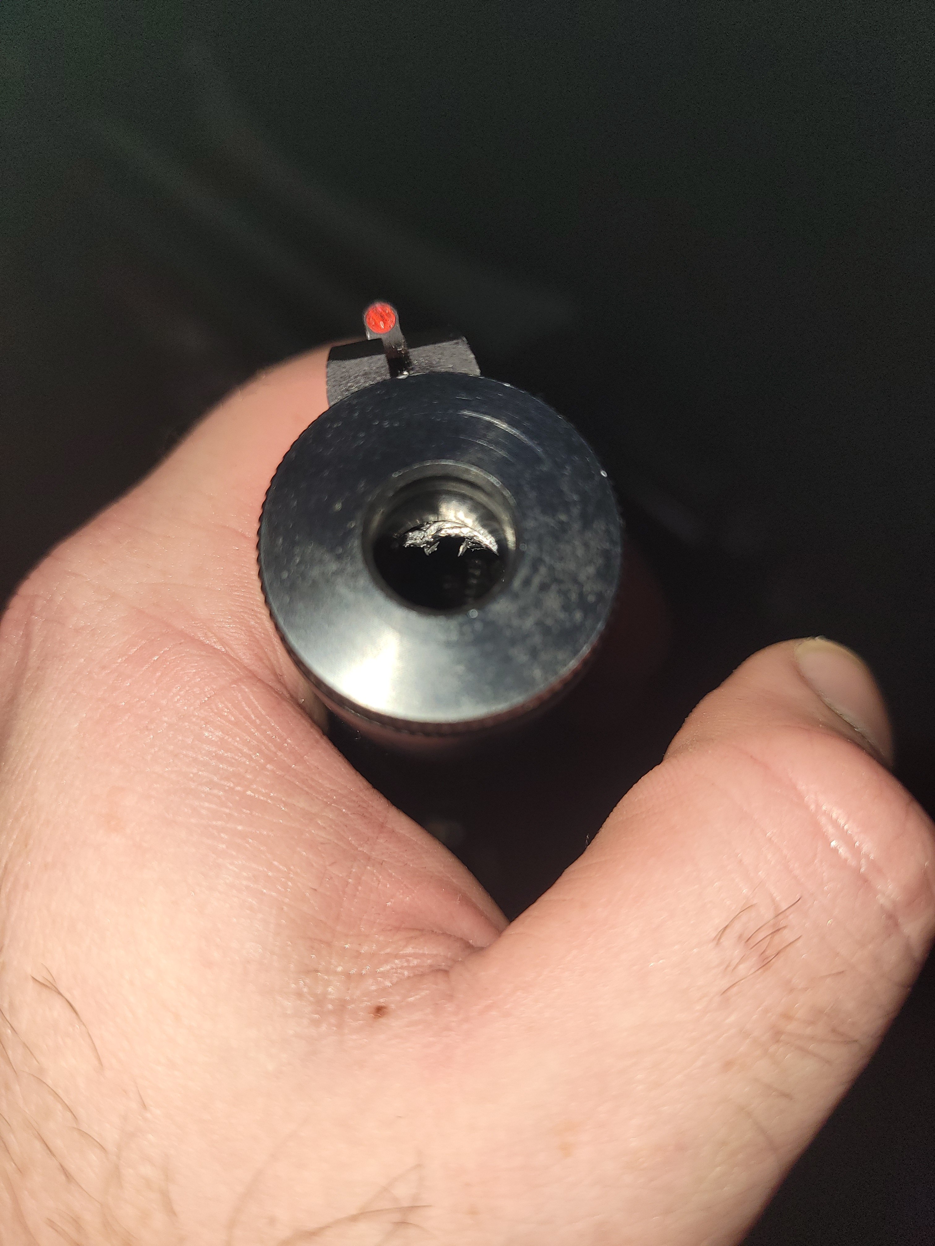

Hey guys, I'm new to airguns and I just got a Hatsan Mod 130s QE from Hatsan USA. I've fired about 30 shots through it. The first couple were bangers. I think they must've been diesled. The muzzle shot sparks and It sounded like a 22LR. After those couple ones, I noticed this soft metal obstruction inside the muzzle. It looks like it's getting bigger with each pellet shot through it. I have no Idea what it is, or if I just got a faulty gun. I'm shooting a target 5 yards away, and it's missing by 4 or 5 feet. I can see the pellet bounxing in the dirt 5 yards to the right. I was hoping someone knows what the hecks is going on and what the heck is stuck inside. Picture attached
Also when I retrieve the pellet after, it's almost completely flattened and deformed. Using Vortex Strike 48.6gr and Polymag predators 44.75gr

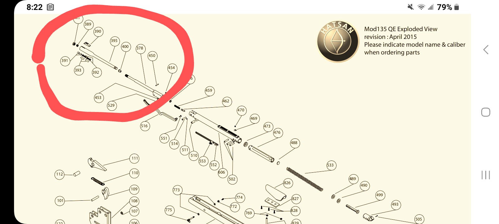

Like SD and the schematic show, that end cap just screws off. Might be a little or a lot tight, but it does. Inside you'll find what's in my picture.

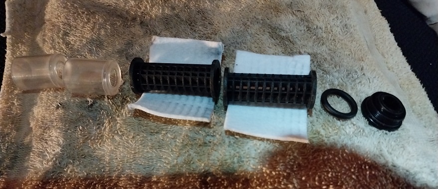

Cap, rubber oring, 2 hair curler looking plastic baffles wrapped in felt and at least with mine, the 2 clear spacers. I also have a couple that they made them out of metal.
Get it pulled apart to see what you're actually looking at, but it looks like the felt material they use. The baffle in that video can be found on Ebay, probably a few other places too. I have a couple, but mine are on PCP's. Never have tried them on the several QE break barrels I have to say how much better they may work than the factory stuff.

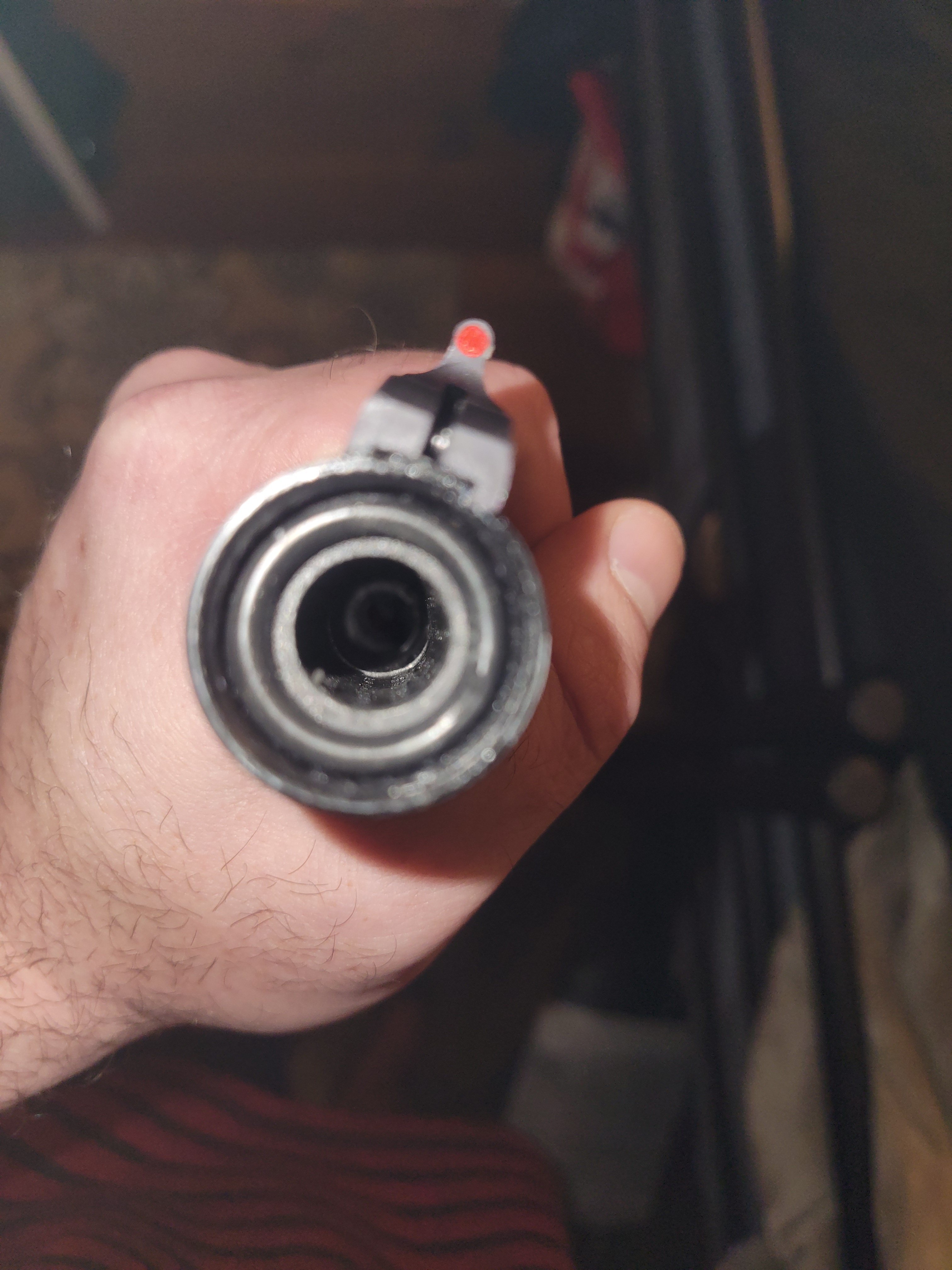

This thread got me thinking about mine. A have over 100 shots with it but never looked down the barrel like that. I just pulled it out and it looks fine. Yours needs to be sent back if it's under warrantee. As far as sounding like a PB, maybe that is from clipping because mine only has mechanical noise which is still a bit loud but nothing like a .22PB.

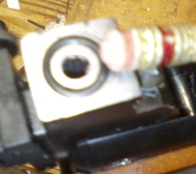

Like steve shows above kinda looks like the tampon is overhanging . You could just unscrew the end cap dump that baffel out shoot it and see . Then try with the hair curlers no pads and see again. Then if looking good put the pads back in proper..

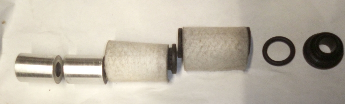

Setves are plastic spacers mine are aluminum..View attachment 337776
I have several that have the aluminum spacers. Random lame thought has always been they did to stop any metal on metal noise. Might have been a better idea to make a 3rd baffle instead of the 2 spacers.

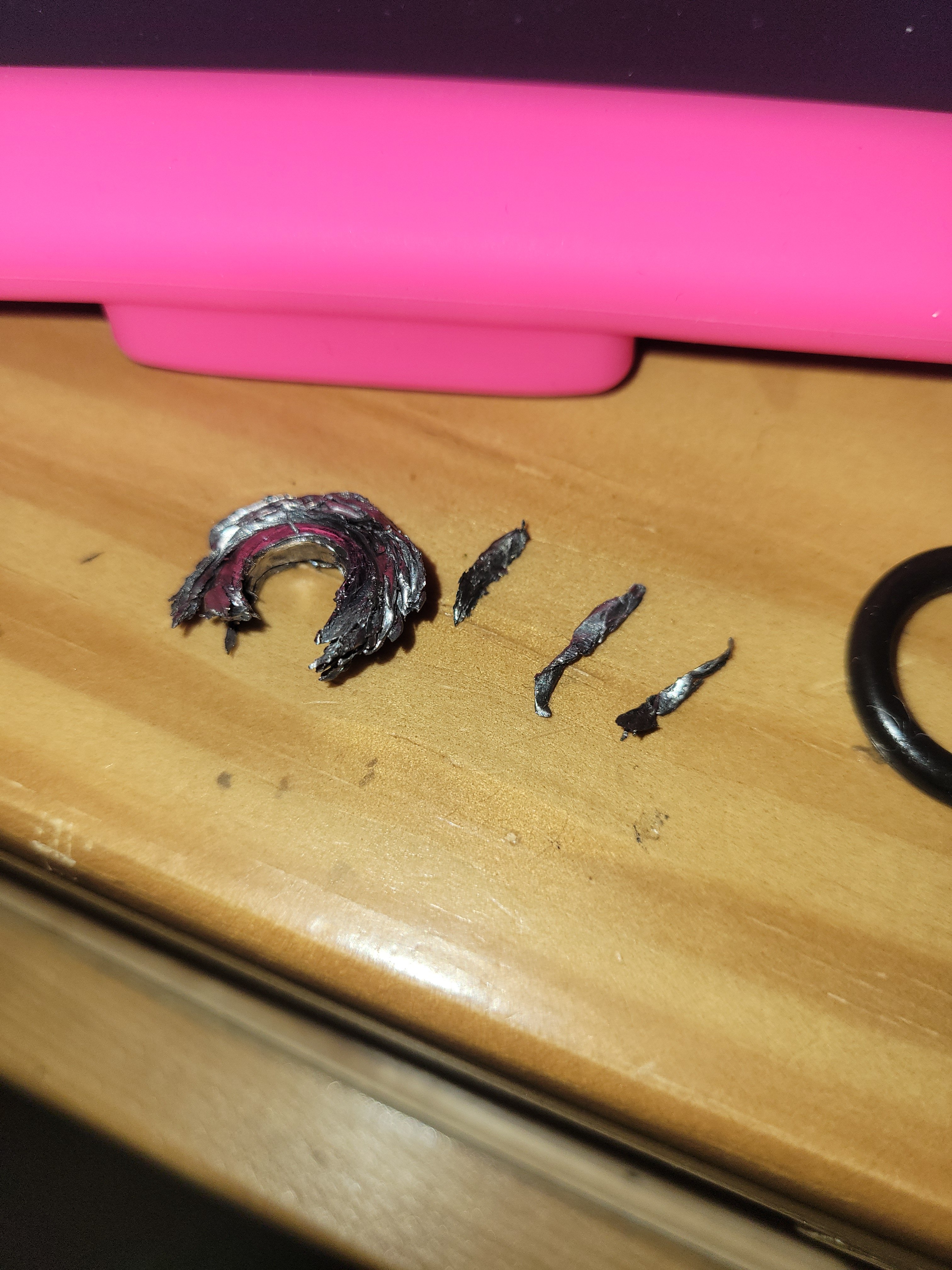

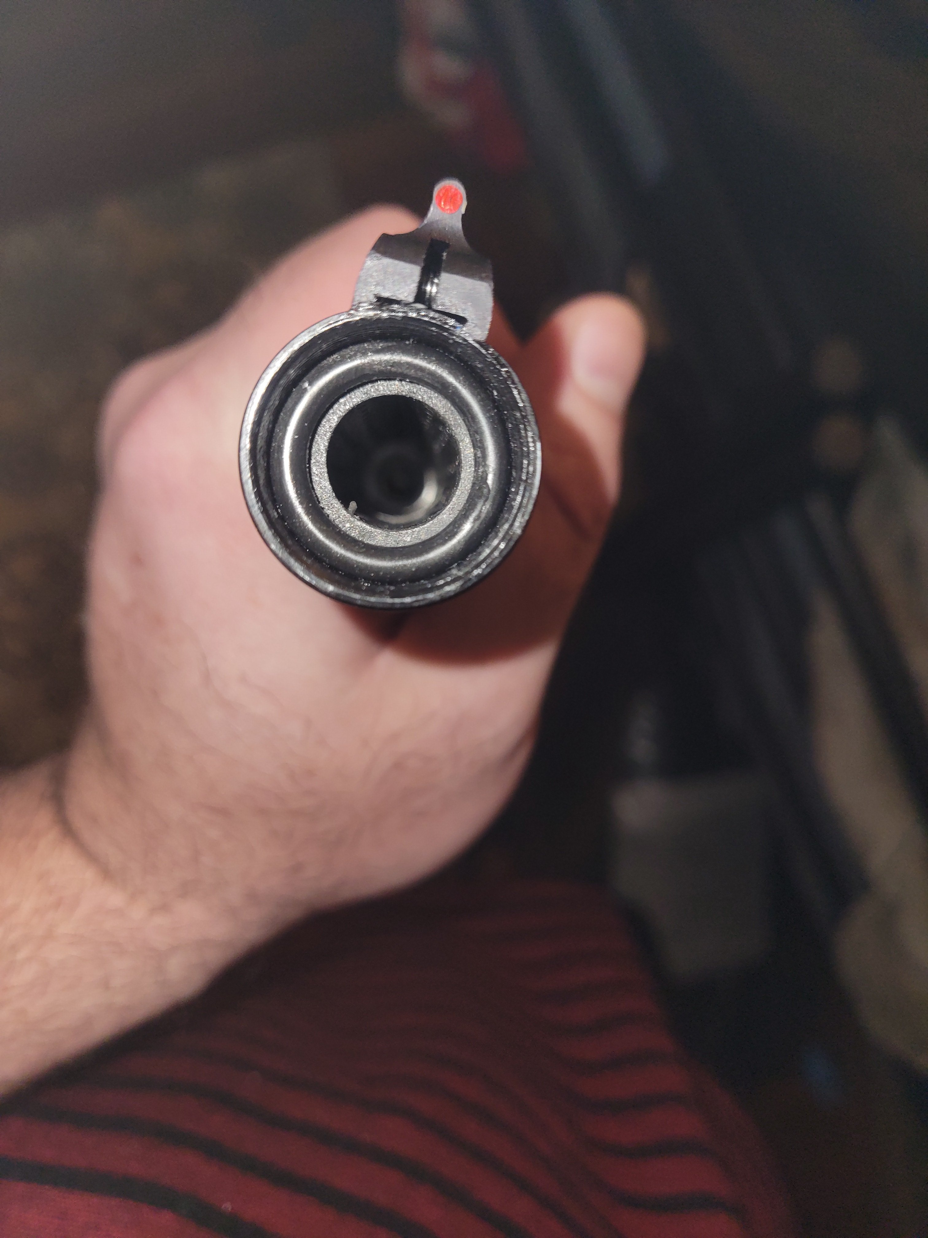

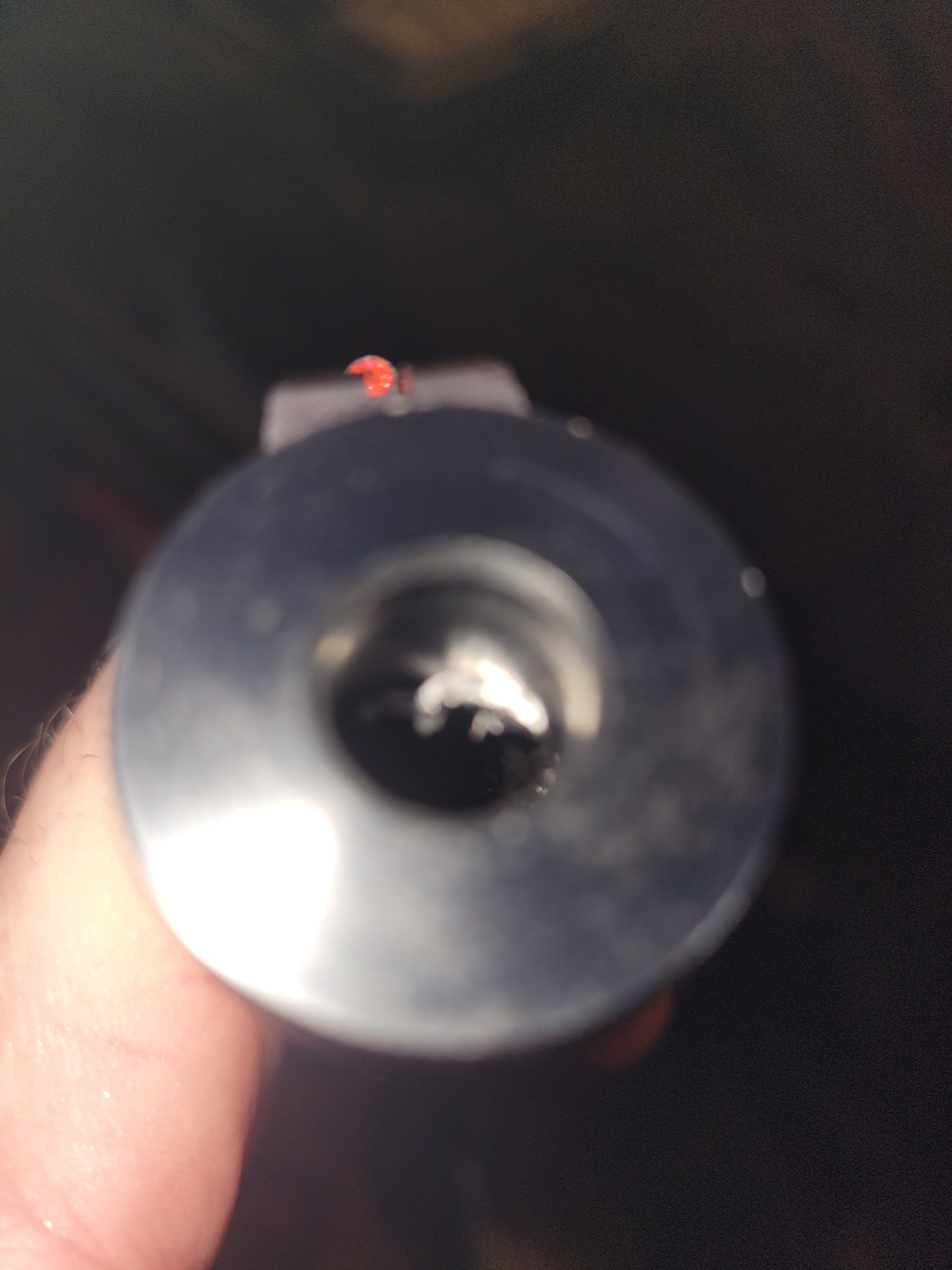

Hey guys thanks for the help. So I was able to remove the cap from the end of the barrel and there was a ton of what I'm guess is lead stuck between the washer and cap. I removed it. Went to fire it and it definitely helped the pellet move but the accuracy is still way off. Fired one more to make sure and now what happened at the end is happening it looks like at the beginning of the baffle further down the barrel. I bought a 30 cal barrel cleaning rod from Amazon should be here in a couple days. Do you think that will help or is something just wrong with this gun? Still no response from Hatsan btw.
