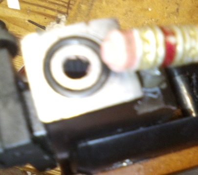

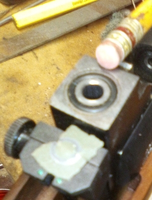

How do you get the shroud off?
The shroud is held on by a 14mm hex head nut. The nut is made of aluminum, and very brittle. I would not suggest trying to remove it. I built an extension for my crowning tool that allowed me to re-crown without removing the barrel shroud. This Hatsan 95QE went from a poor shooter to one of the best I’ve ever owned after this simple procedure.
Reactions: Hateful McNasty

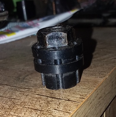

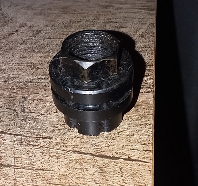

This is the shroud nut Bear mentioned.
Not made of the best quality metal and not hard to round off if you're not careful. If you still want to try it, Get a 14mm socket, an extension and a ratchet. Unscrew the end cap of the shroud and be careful because it has an o-ring on it. Remove the spacers, baffles and felt. Suggest you lay them out exactly how they came out so you can put them back in in the right order.
Now just be very careful about sliding the socket/extension in there and don't try to force things to take that nut off. Your results might well vary, but the ones I've done while tight, didn't need a lot of muscle to break loose.

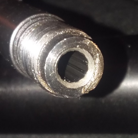

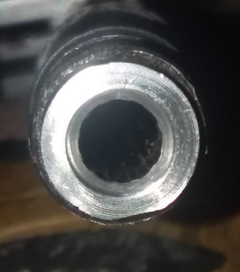

Hatsan does a lousy crown job on their barrels (although they're not the only company that does), what mine looked like before and after and as Bear mentioned, makes a world of difference when you're done:
View attachment 440425View attachment 440426
View attachment 440428View attachment 440429
I used every socket I had including 14-16mm nothing even tried to fit i wonder if it’s female and not male?
Flashlight should answer that if you haven't already taken a look with one, but it should look like the one in my picture.
New and Hatsan changed what they use? Used and someone else already rounded it off? @Bear-of-Grayling any thoughts??
The new nuts are made of aluminum. I tried to remove one and the hex portion easily snapped off. It wasn’t even making contact with the male threaded portion. If I now wanted to remove the nut, I would need the tool Hatsan has that would include the rods to engage the holes on the nut. Or send the barrel to Hatsan for removal of the nut. There really is no reason to remove the shroud. Just make an extension rod to hold a Dremel gringing bit and re-crown with the shroud left on. It sounds like this is what is going on here as well.
