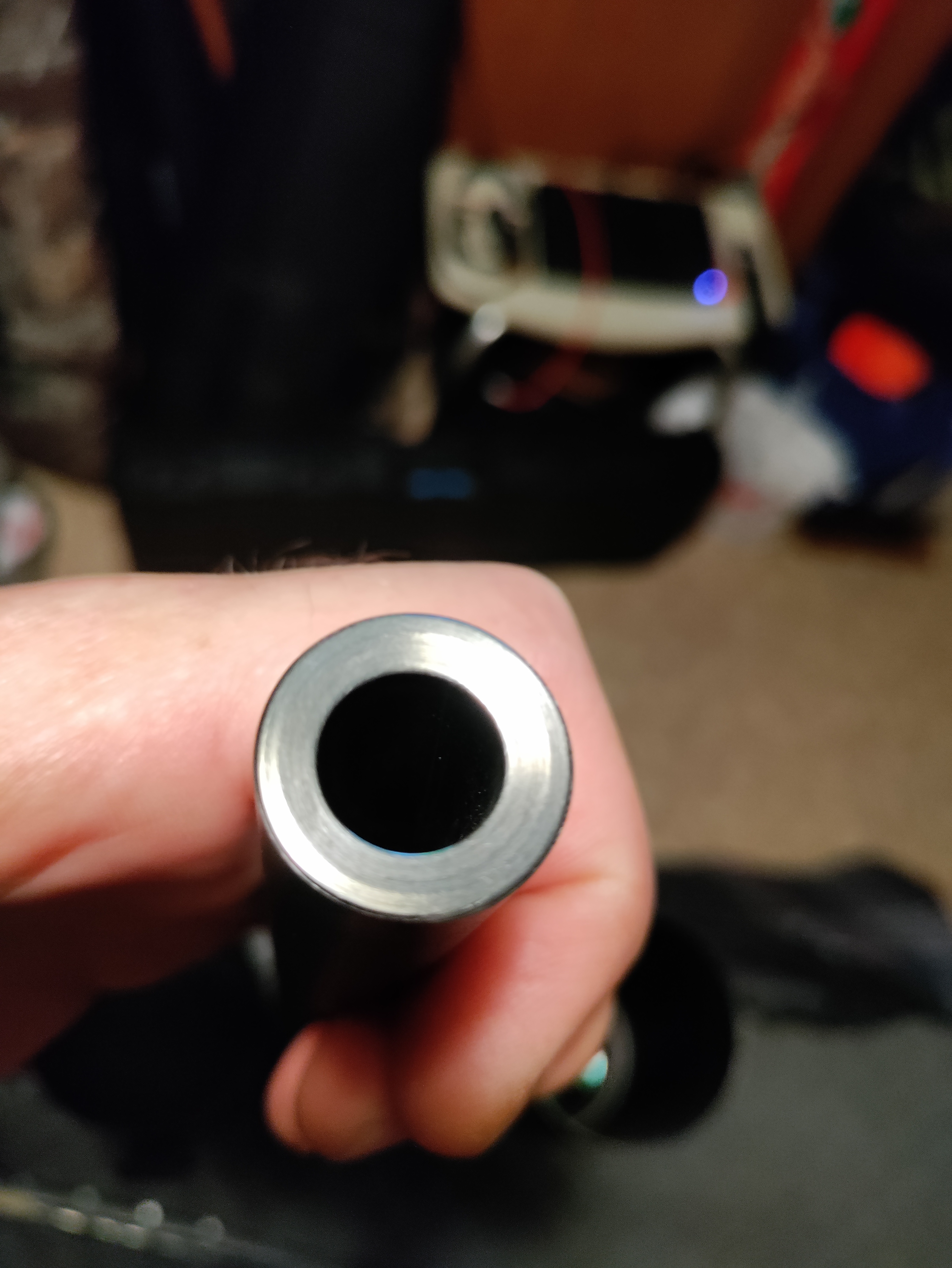

Made mine into a carbine!!
Cut 10 inches from the barrel and it's still doing 450fpe with 280 grain Mr hollow points! Didn't loose any accuracy!
Cut 10 inches from the barrel and it's still doing 450fpe with 280 grain Mr hollow points! Didn't loose any accuracy!View attachment 278174
Awsome! Forgot you were doing that, i remember your post. Braver soul than I. So no other issues with yours either?
Looks beautiful (y) Not surprised at no accuracy loss. As long as the projectile spin is stabilized and you did a good crown job on the muzzle. How much velocity loss did you have with the 10 inch chop?

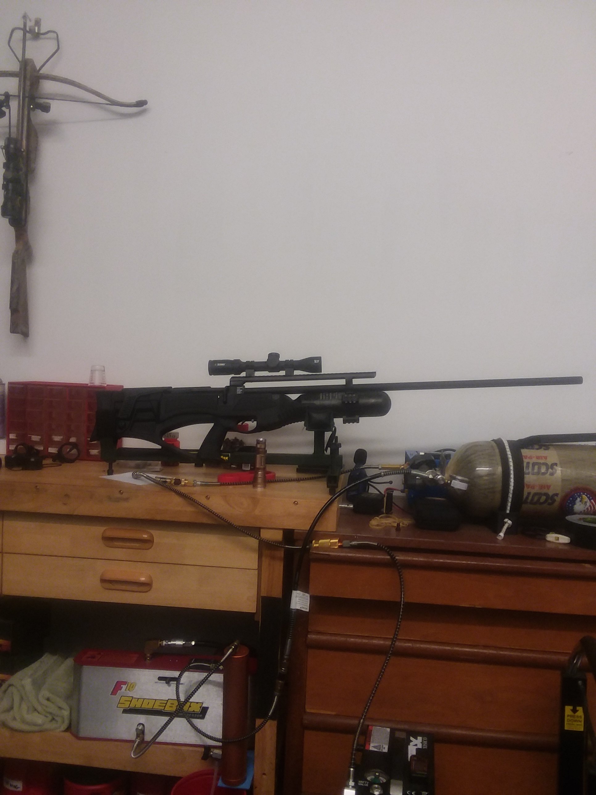

Bought 2 .50 cal Pile drivers 2 weeks ago. 1 works fine but one losses air over night. Bought a Benjamine .357 Bulldog. Calling CS tomorrow to see what they recommend on the Piledriver that loses air.The Bulldog came with a scope. Put Talos first focal planes on the Piledrivers. Bought 2 pumps, one is a ToAuto and the other is a Hill. Bought 2 reserve air tanks also. 1 is a minie and the other is the large. Both of them Pyramid Air. Had to get a double male air fitting and a .36” whip to make things easier. Running a double oil/water separator. This is my first pcp endeavor. I hunt every year with pistols, shotguns and rifles and in my old age wanted to try something different.

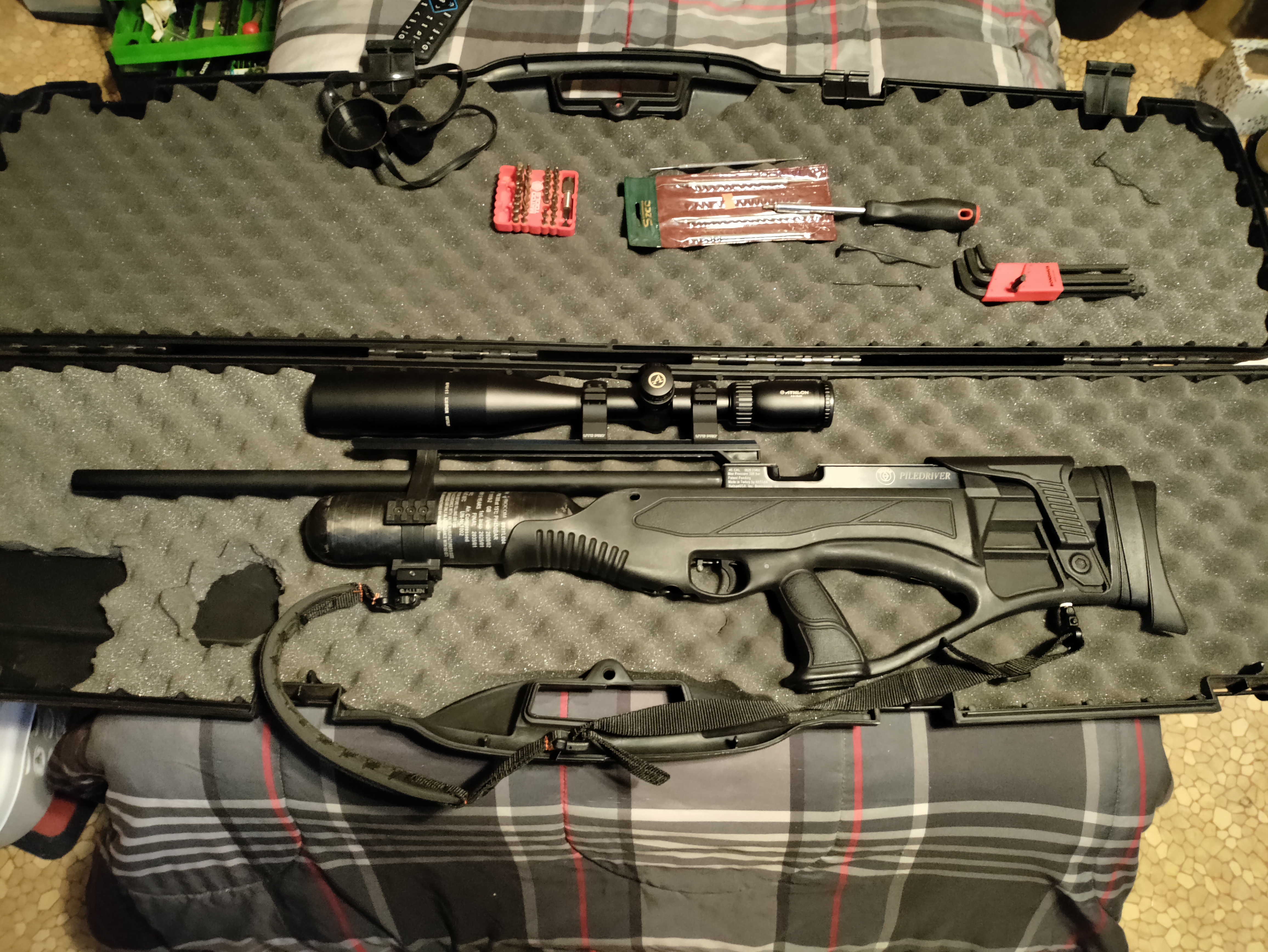

i got the piledriver yesterday and got to test it out today..
50yrds is my max distance, and my most productive distance is between 17 & 30yrds.
this piledriver is just what Rick Rehm says it is.....a tackdriver !!
i have had 2 texans, 2 quackenbush, 2 badgers and a hammer.
none of them put 3 big slugs basically in the same hole @ 30yrds as the Piledriver !!
it took 11 patches to clean the gunk out of the barrel and it really shoots about every slug i have very well except the light weight stuff below 300gr.
i'm shooting my cast and sized .457 RNFP 405gr lyman slugs at around 885 FPS = 704 FPE
i like it !! and i'm going to hunt with it come our november ML/AG special season
and probably the remainder of deer season right on to hog wild season.
i will try and get some more pictures soon while i'm testing further. 👨‍🌾

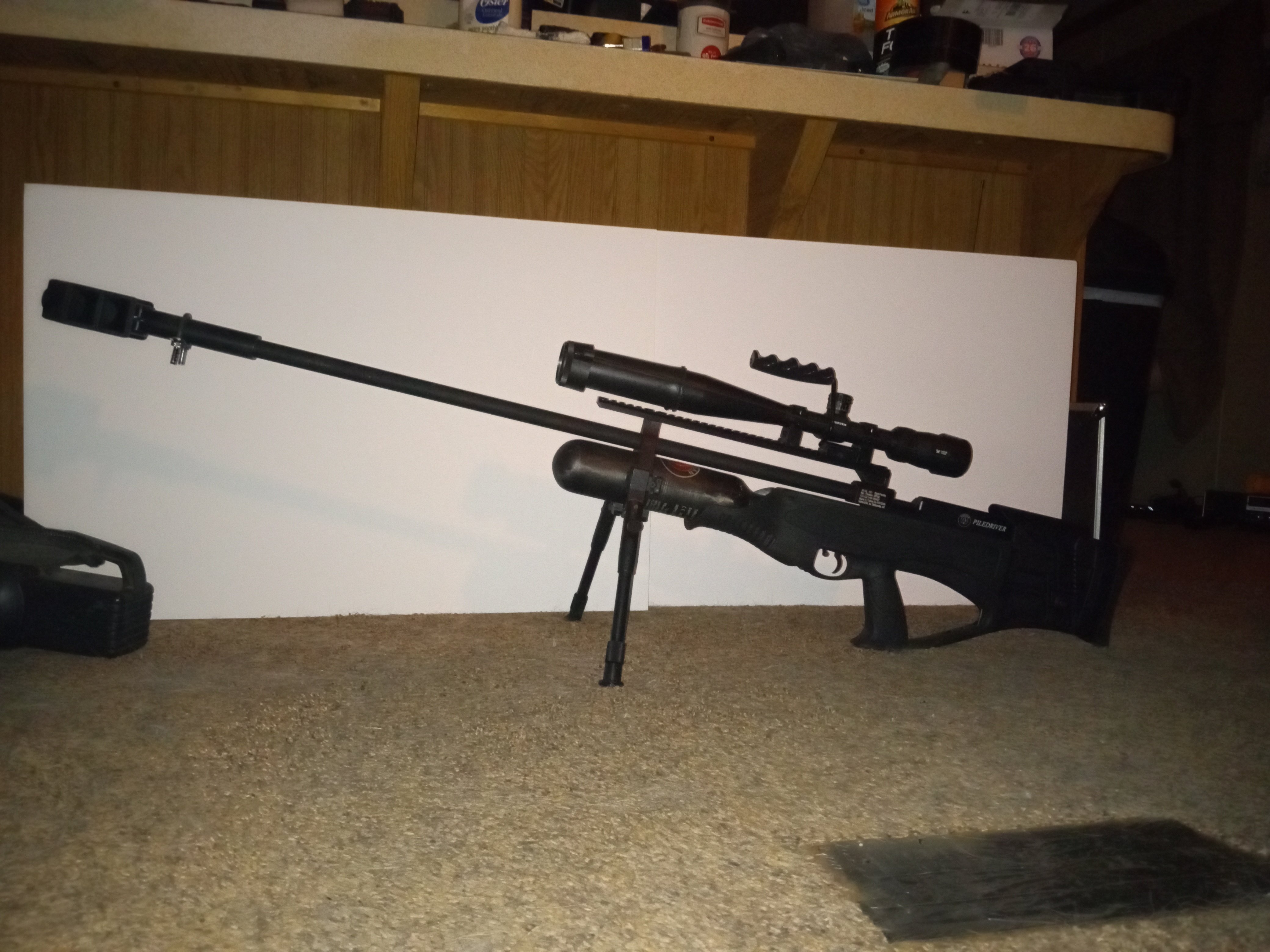

My Piledriver in .457
Very nice tac driver for an air rifle this big and this powerful.
It does basically put the round in the same hole at 50 yards but since I'm not a hunter yet, when I find someone with a big enough property, I'll be going for 500 yards just to satisfy my curiosity

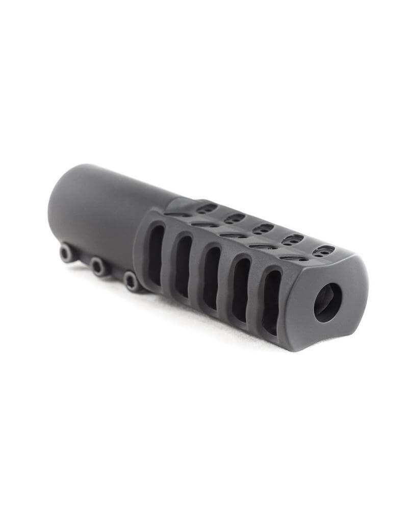

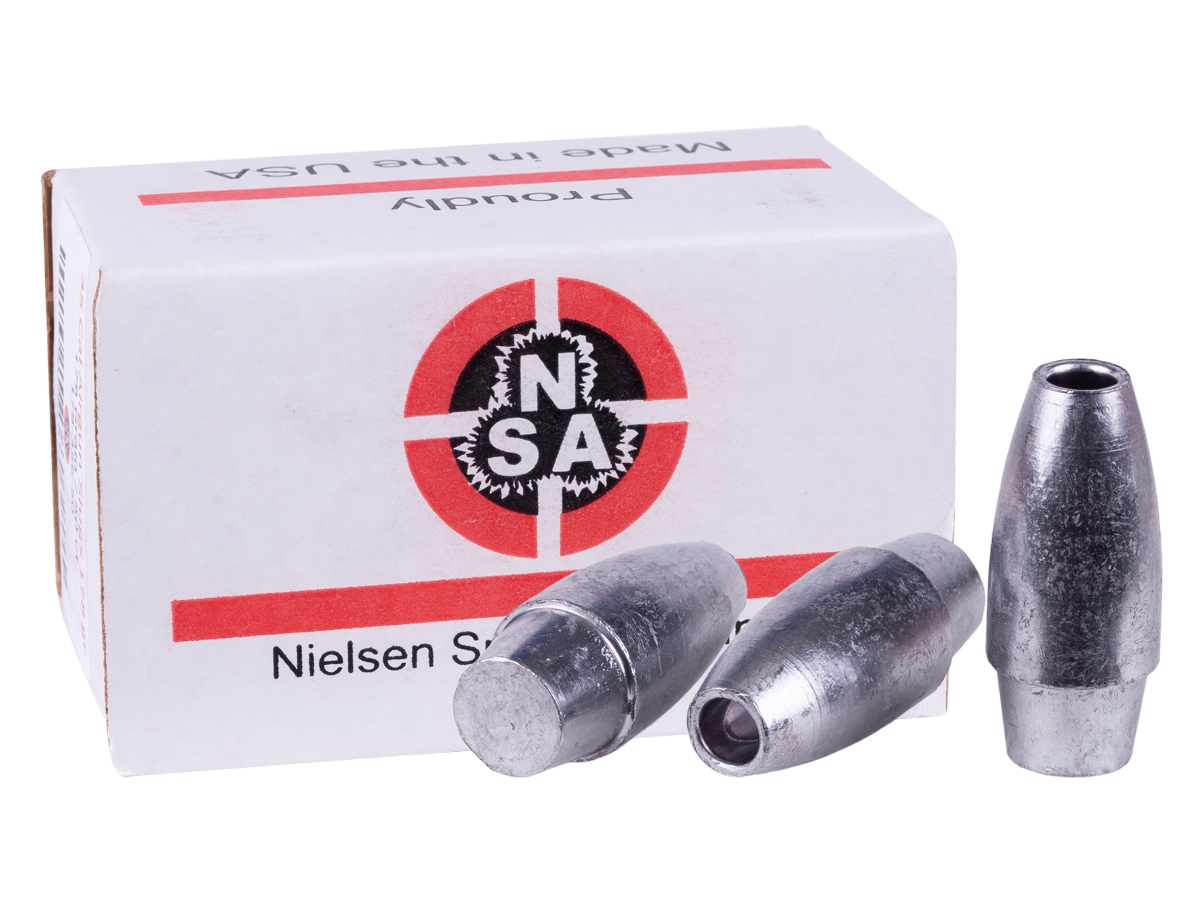

Extra ancillary equipment includes an add on butt pad with integral mono-pod, Witt Machine muzzle brake, on order and Vortex Diamondback tactical 4 - 12 X 40 scope shooting the NSA 350 gr boat tail hollow points and carry handle
As it sits in the pic, weight is about 16 pounds
