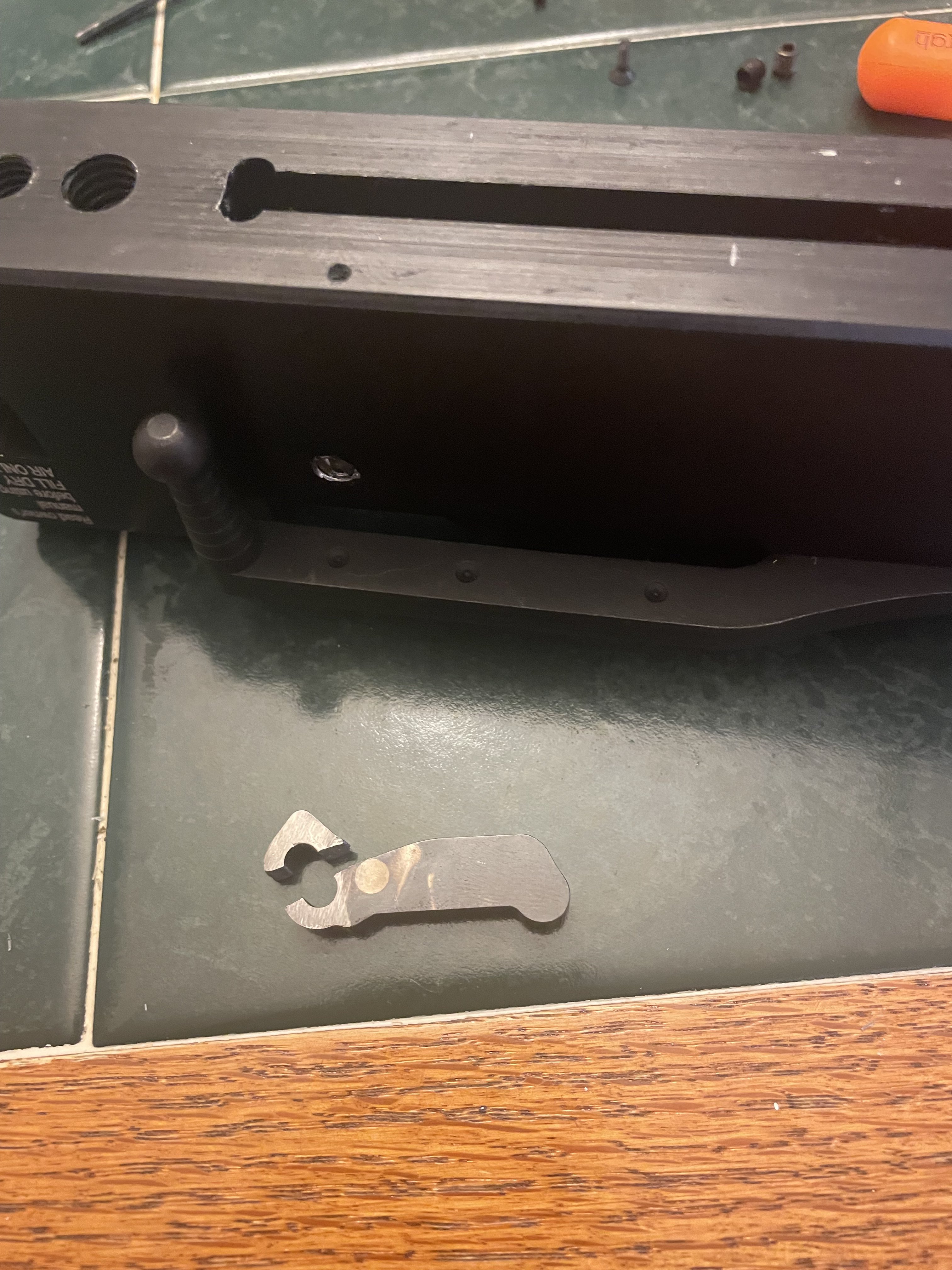

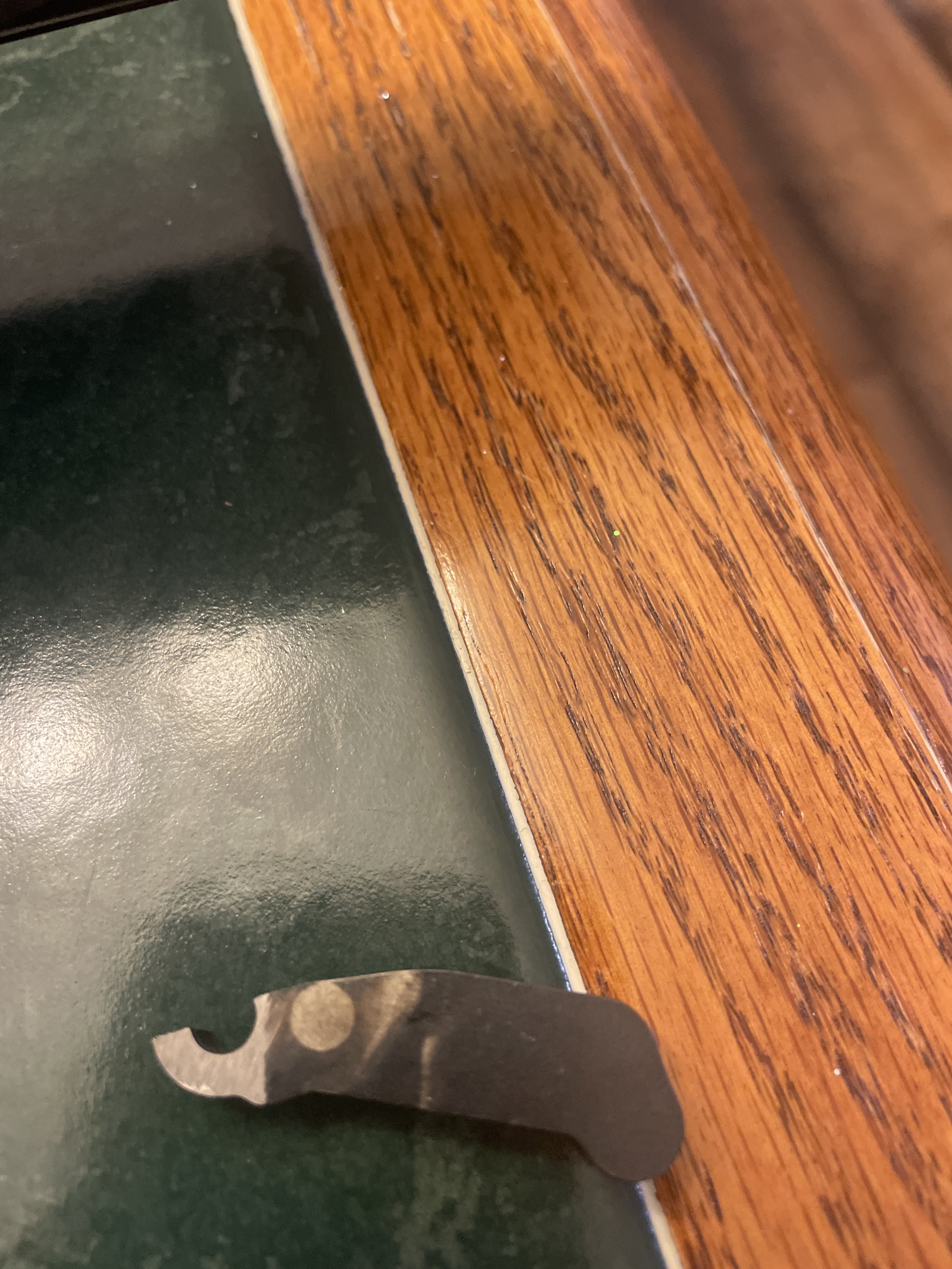

You’re right, just took the stock off and I see the gas piston. And a chunk of metal fell out
