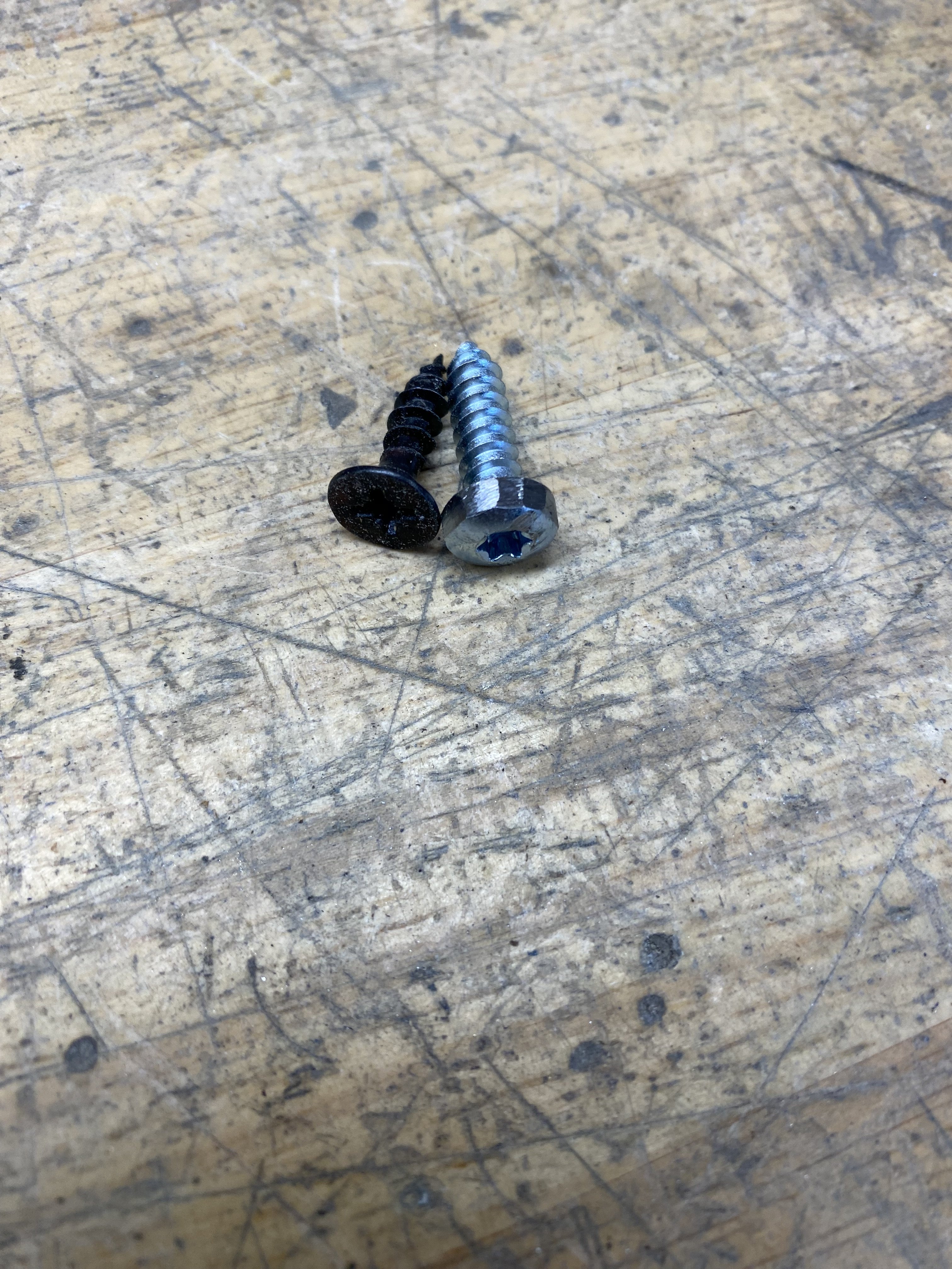

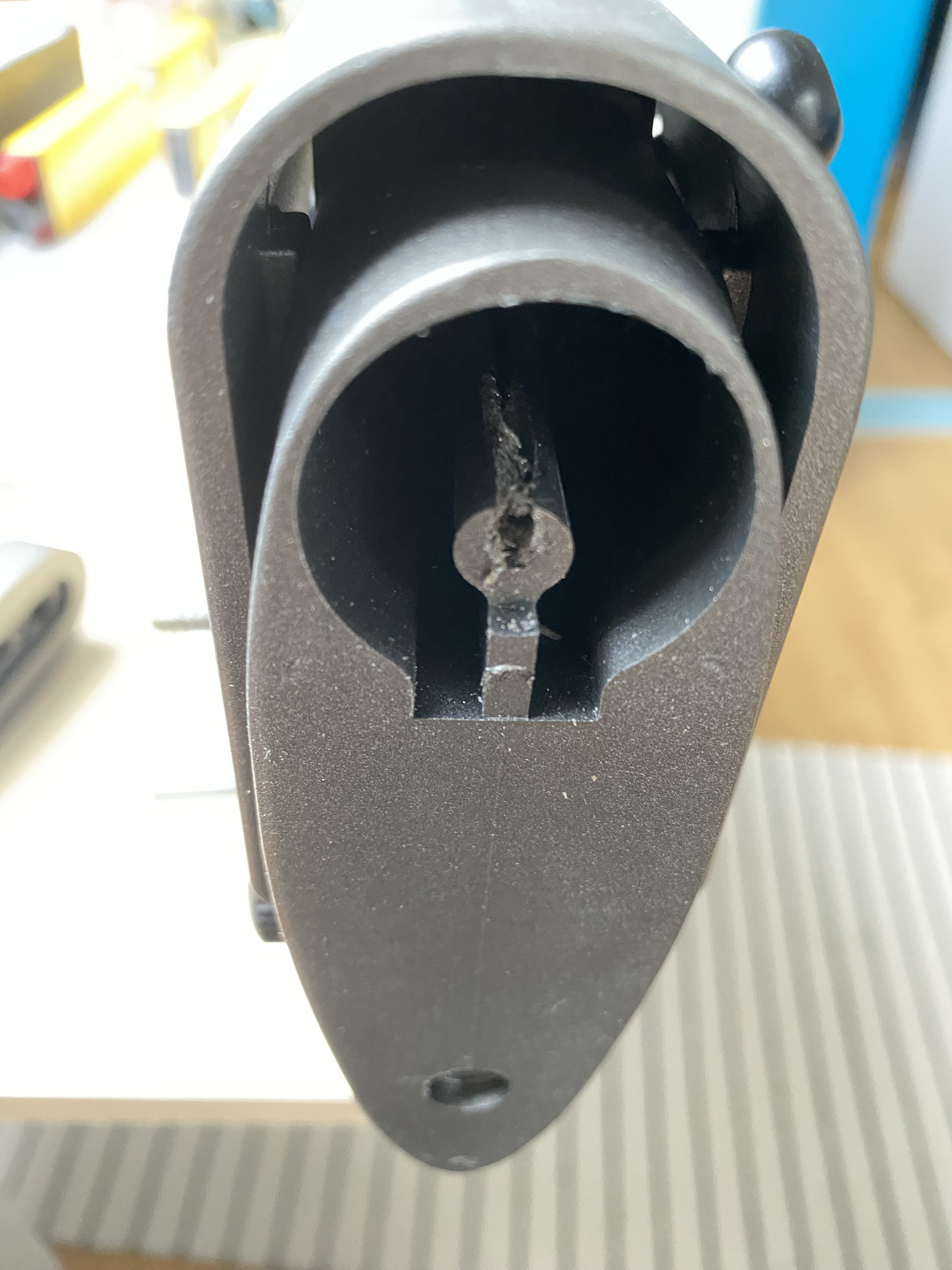

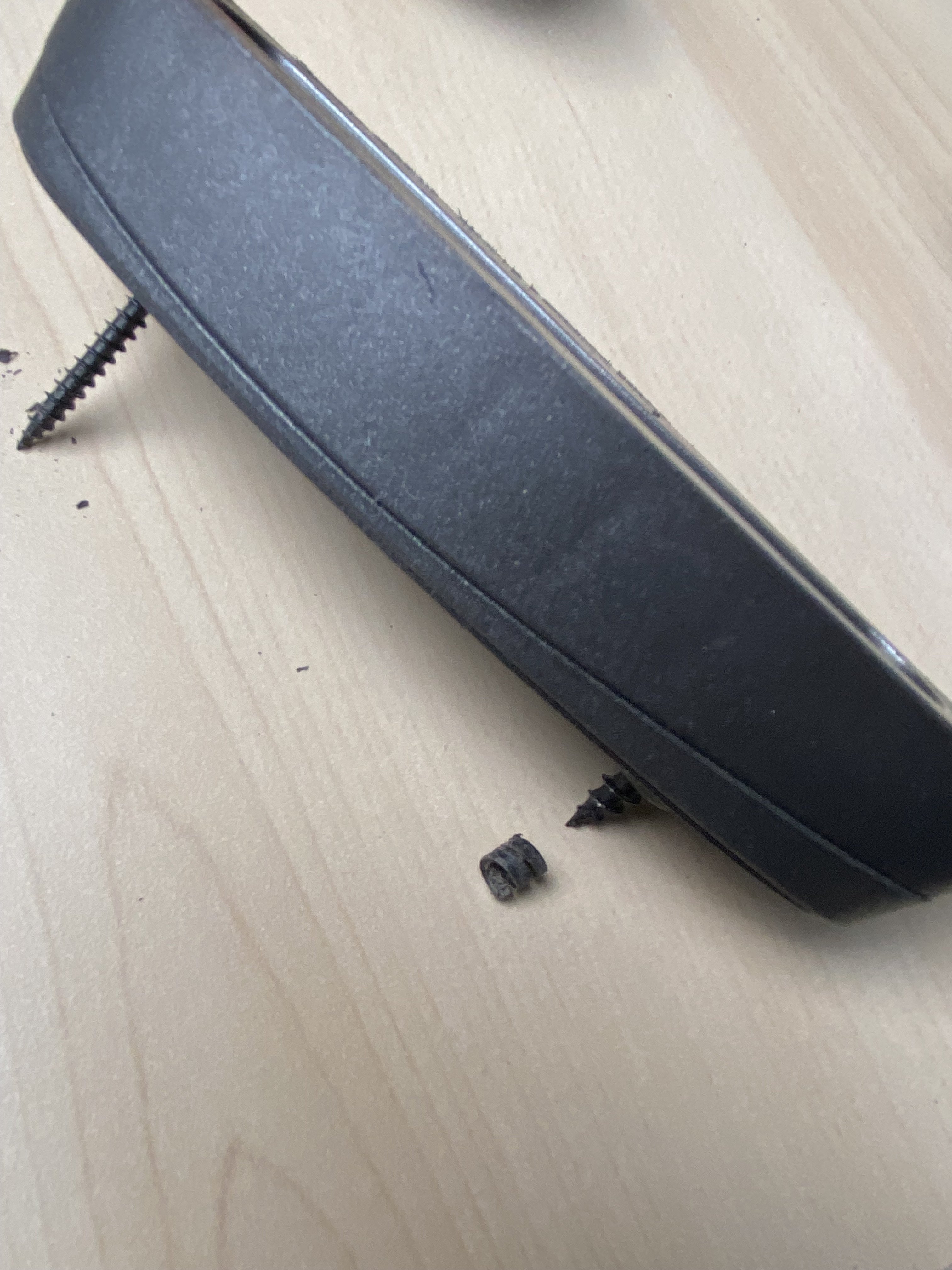

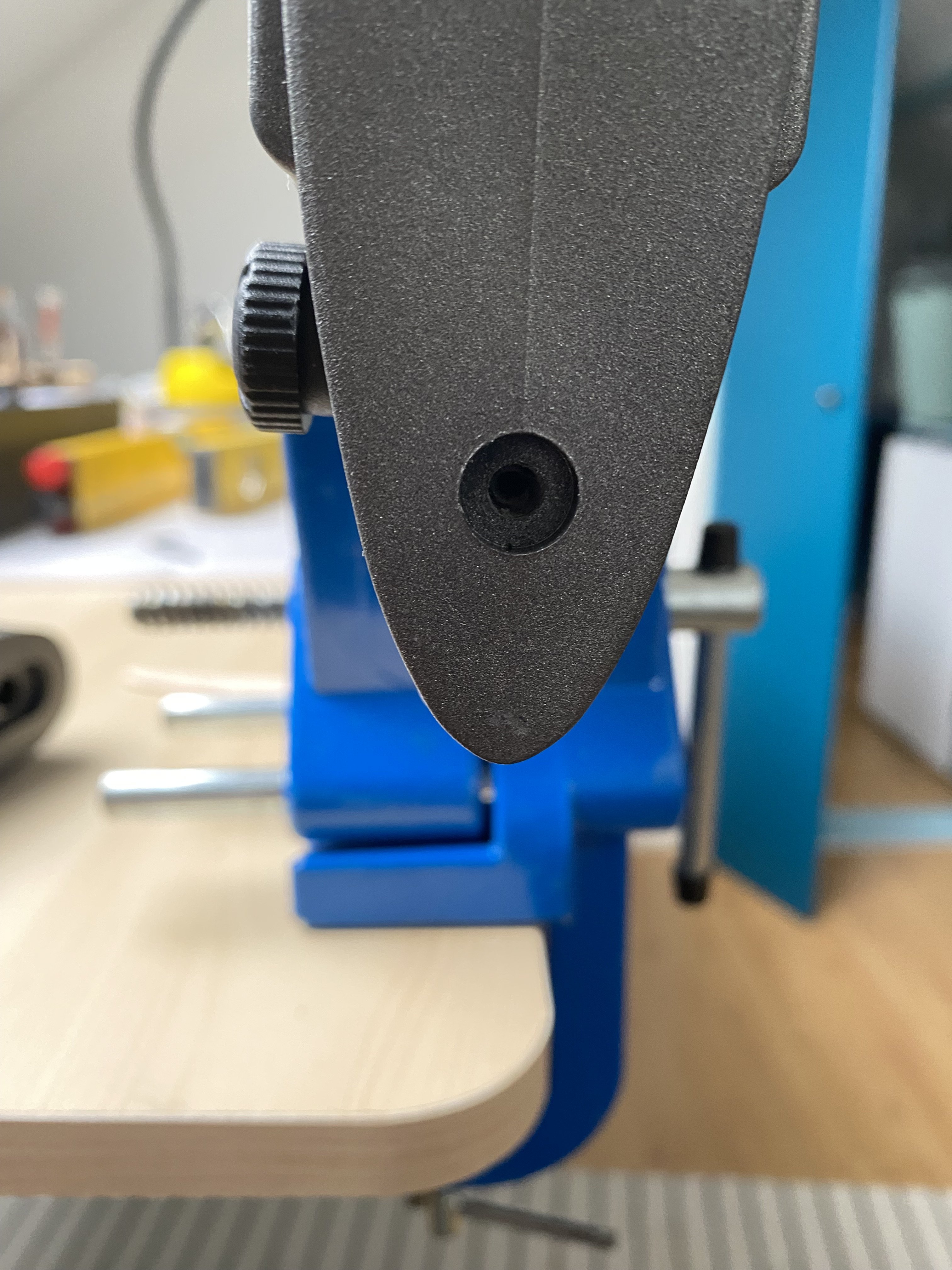

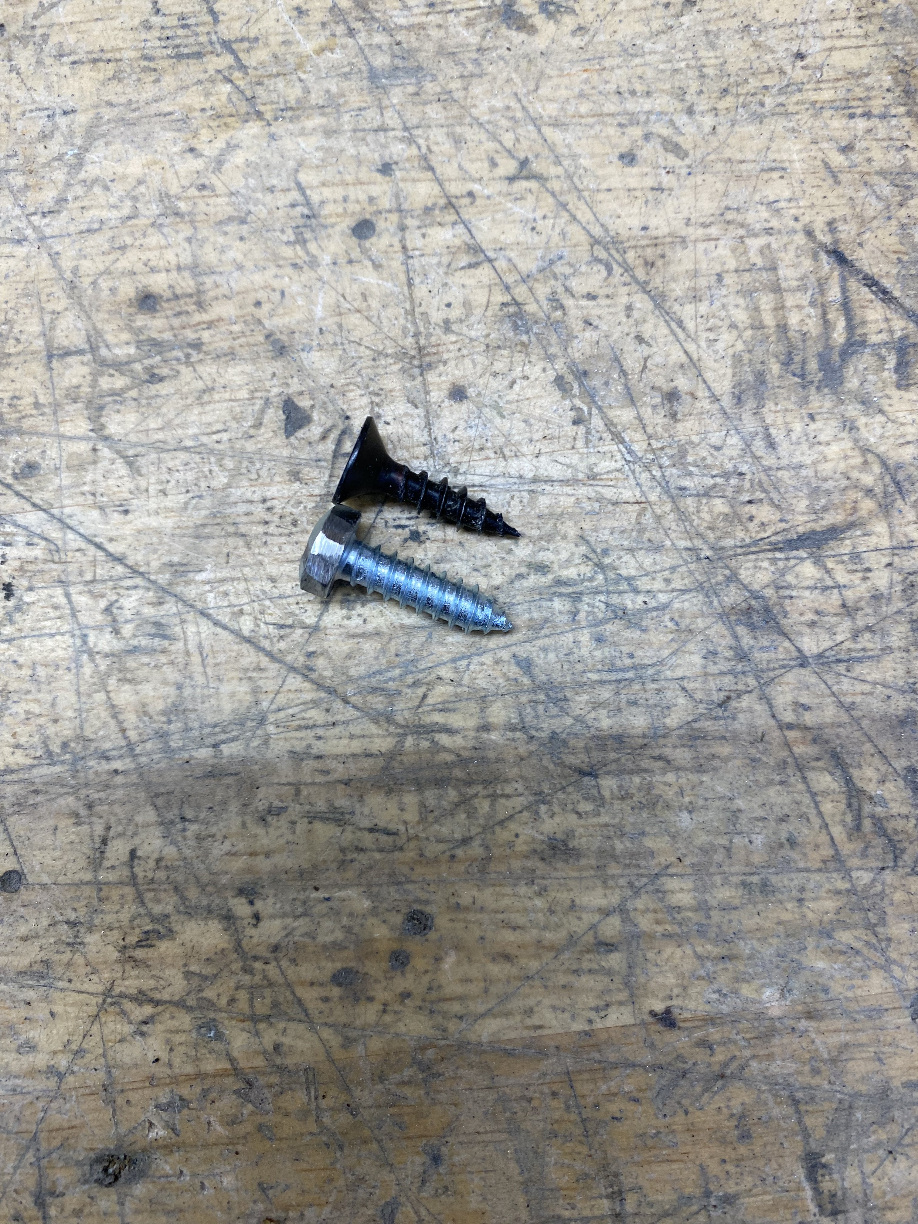

At the dismantling of the headstock, it appeared to me that Hatsan factory has to monitor their assembly line on
overtightening and alignment of the plastic screws.
To solve the misaligned screw, i drilled a new hole in the opposite direction (downwards) and to fix the smaller screw, i fit in a bigger one after fist
trimmed the head-diameter
