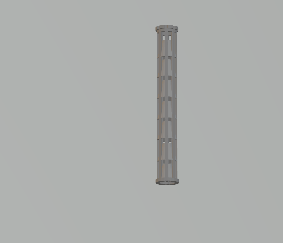

A Heads up for you guy's, my 3D printed Baffle had a failure on my .25 Flashpup, the Pathway hole is to small ( to close of Tolerance) for .25 pellet, Clipping will Occur and destroy the Baffle, I will be working on resolving the issue, the Pathway hole needs to be 9mm for proper clearance,
So Please Do Not use on .25 QE rifles or any .25 rifle
Thanks
Kevin
All Fixed, now Improved and works great. still 8mm hole but made the Baffle with centering rings on the ends and beefed up the whole thing.
5/17/2021 New Improved Baffle Upgraded, .25 tested and approved
new version ver 6
View attachment Flash Baffle ver.6.1621303290.stl
this one is ok for .177 to .25
