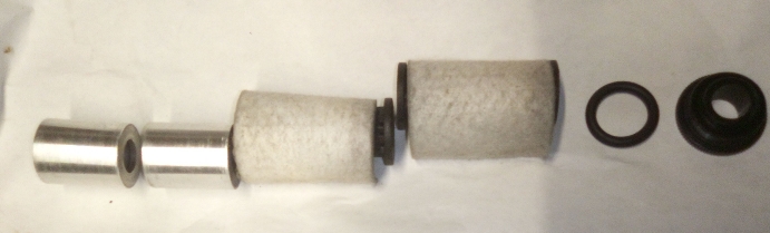

So I bought the flash pup, freaking awesome rifle for the money. Took it to the woods and the screw cap for the baffle fell off while shooting some squirrels. Needless to say the squirrel lived and I saw some white in the scope 😂 with that being said what baffle works best for both accuracy and quitness? I shoot in the woods behind my neighborhood so I’m looking for the best of both worlds if there’s an answer!
That cotton pad looking stuff you probly can use something similar . Some hobby shops got stuff like it
Easyest would just contact hatsan for direct replacement parts
Ya, there's alternative drop in stuff out there

I think as long as it fits and works correctly it good..

The qe uses felt as well. I have three of them and the system wasn’t worth a💩on any of them. Donny’s must work decent with felt because a lot of guys swear by them, but the 13 stage baffle I got off of eBay works WAY better than stock. The 10 stage eBay unit as well as Hajimodo’s stack are about equal and work really well too.
