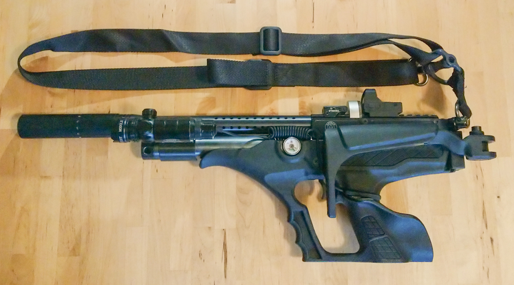

I did polish my action, and got a stronger gas piston from Hatsan (they improved the material quality) piston rides below the probe/bolt, and above the hammer in the receiver. It cocks the hammer. (old one broke) There is another piston in the shroud that cycles the probe/bolt. The rod it rides on kept bending, but I made some mods to run a moderator, which introduces a lot of backpressure, likely causing the rod to bend, so I made a new one from 304 ss
First hand experience, I own one in .177 and have modified it quite a bit and agree with Dallas that .22 is the goldilocks caliber. It doesn't jam, most common failure is to not chamber the next pellet, requiring manual cycling like a conventional repeater.
Keeping it lubed, tightened, as little back pressure as possible and it cycles great. Add an LDC and you've got some work ahead.
