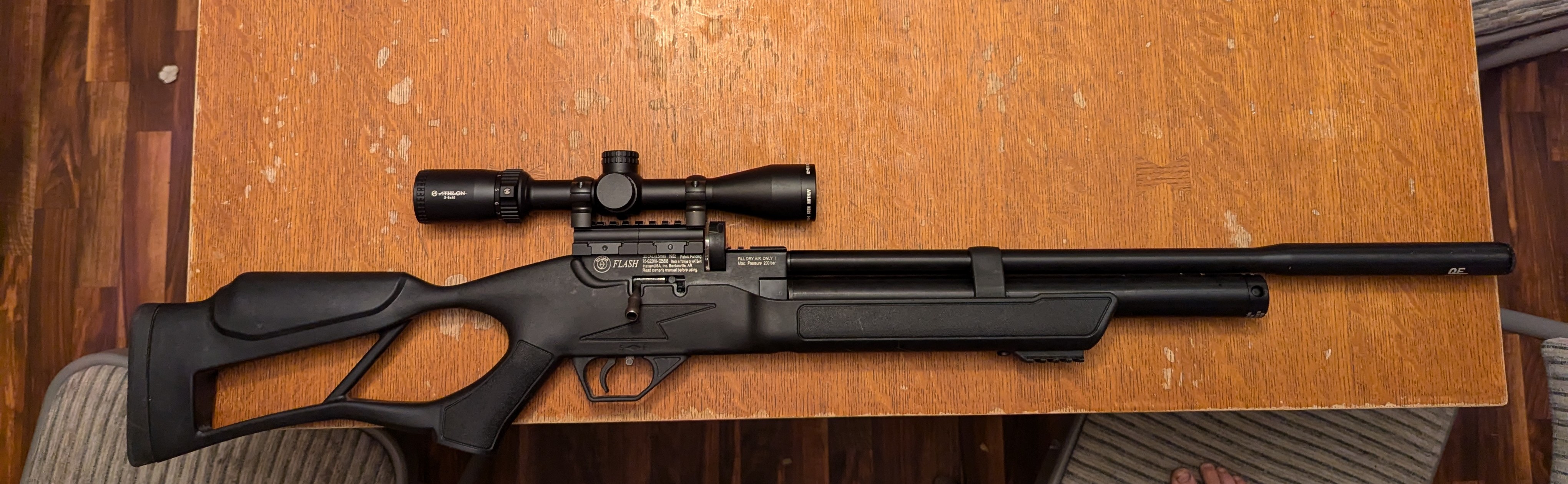

New here and new to PCP but not new to guns at all. Having an accuracy problem with a PCP.
I bought my son a Hatsen Flash QE in .22 and can't seem to make it shoot well. I purchased a number of different brands of pellets initially. Sighted it in with the included scope (Cabela's purchase) and I thought it was doing well. I could consistently hit a popcan at 40+ yards.
He shot it a bunch over the next 6 months but I noticed he stopped shooting it and asked why. He wasn't hitting anything. I believe the scope may have got bumped and so I took the opportunity to buy a nicer scope, Athlon 3-9x40 .22 rimfire scope, and put it on. I pumped the gun up to 200 bar and got it sited in, at 15 yards I was grouping around a 1/2 inch so I went out to 40 yards. Couldn't keep it on an 8.5x11 even. After running the air down without finding anything I pumped it back up to 200 bar, moved the target back to 15 yards and put maybe 5 rounds through 1/2" again.
I thought maybe I was just losing it at 40 yards for some reason so I put the target back out there and same thing. A dozen shots, several of them completely missing the paper. I moved it back to 15 yards and it was off the same amount.
I cannot remember the pellet weights, but I was shooting Crosman mid weight for all of that. I found 10 pellets that were lighter and shot them, with <200 bar and it did not help.
I am waiting for a JSB Diable Exact 18.13 gr and some Haendler & Natermann 21.14 gr pellets to ship so I can try those out.
The only thing I have found that is stable and I'm not 100% convinced on this yet, is it seems the first half dozen shots off of a full 200 bar charge seem to be accurate. Then it goes crazy. But I wouldn't die on that hill, not enough data collected.
The problem presenting has followed through 2 scopes with different mounting completely, and several pellet weights and brands. I cleaned the barrel but it was almost spotless before so no change there.
Any suggestions would be great. I really enjoy the PCP tech, got an electric pump that my son can run (no more heart attacks when I get off work hand pumping that sucker). And I really like that it's more safe than a powder burner for shooting around the yard. We only have one neighbor in PCP range but quite a few in .17 HMR range.
