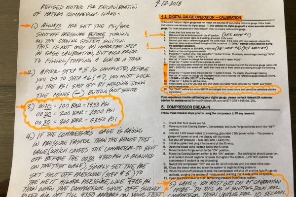

Back to the cooling fan plate- loosen the attachment nuts and raise that plate up at minimum 3/4”, and if you can get a bit more, do so. All that will do is allow more air to freely move, and aid in the cooling process. Set your auto purge to come on every 5 minutes, and, yes, you will need to re calibrate the digital gage to a known good gage to see if the digital gage is spot on. Mine and others have been off anywhere from 150-200 psi.

Heres a copy of my notes I took, that goes into more detail than what the manual provides. Basically, my findings. When you all need to calibrate your digital gage, it gets tricky, so I touched on that part for sure. Lastly, the importance of that coolant on switch. That switch plays double duty and is an important switch other than turning on the coolant fan motor and coolant pump. It pretty much sets the stage on the calibration process, let’s you know if it’s okay to turn the compressor on(the lady’s voice comes on) so make sure and check my notes on that.
