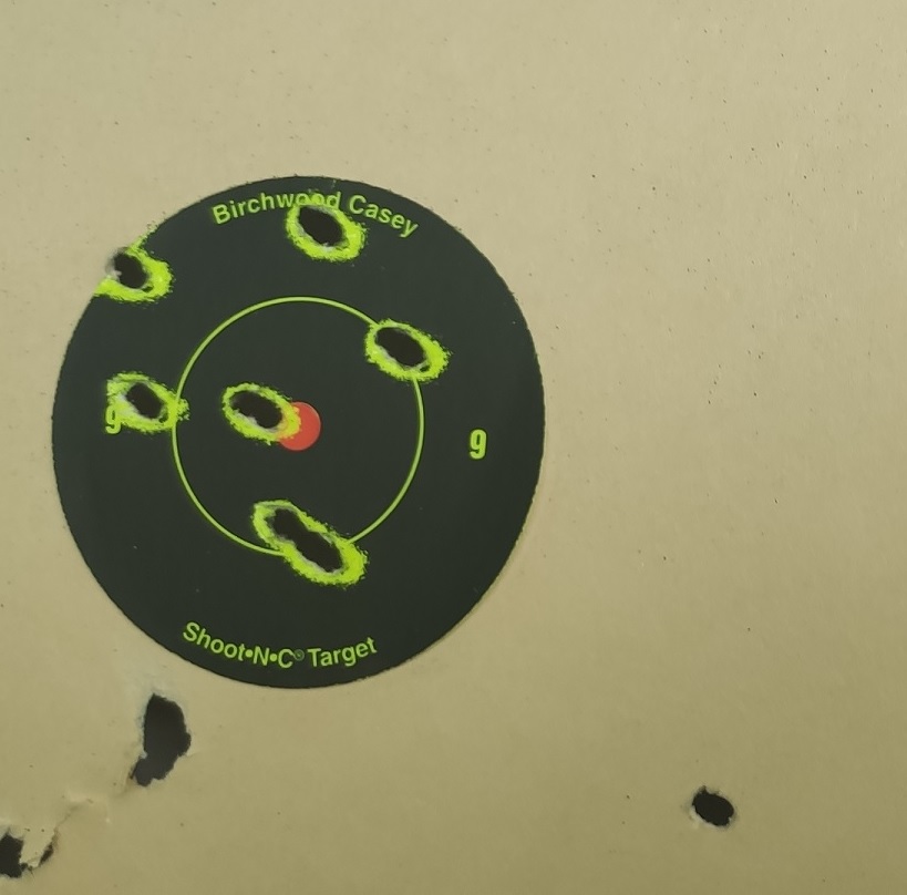

Anyway my Vulcan 3 did not shoot the 20 grainers well, and it is also the same with my new Two rifle with the unchoked CZub barrel
When my 20 grainers ( shjot by Two rifle ) arrive at 86 M they are keyholing.
13 and 16 grain slugs make nice round holes as they should be
When the slugs make target holes like that it just means they haven’t had time to stabilize yet. Around 500 meters you should see them straighten out and your groups will shrink to 1/2 MOA. 😉😂

So today i have been shooting 93 and 123 M with the Maverick and 20 grain Zan slugs, and it was quite wholesome, so the 1 tin i had of 20 grain was soon gone. ( im ordering 20 - 22 and 24 grainers real soon )
Also fed the Maverick some 16 grain Zans, and those too it like in its sawed off condition, at least a helluv a lot better than it have been before.
I have not inspected targets close up, but both 93 and 123 M with the 20 grainers the landing holes look nice and round.
