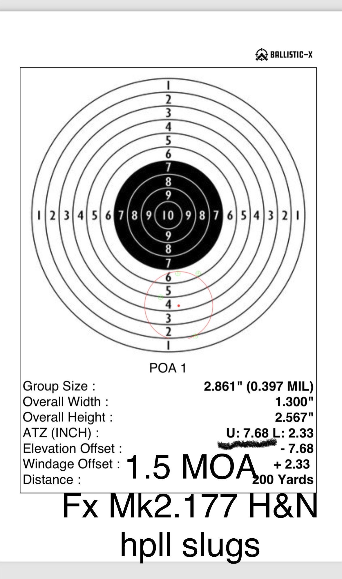

My crown shoots the 20 grain at 870fps and shoots 1.5moa at 200yards
