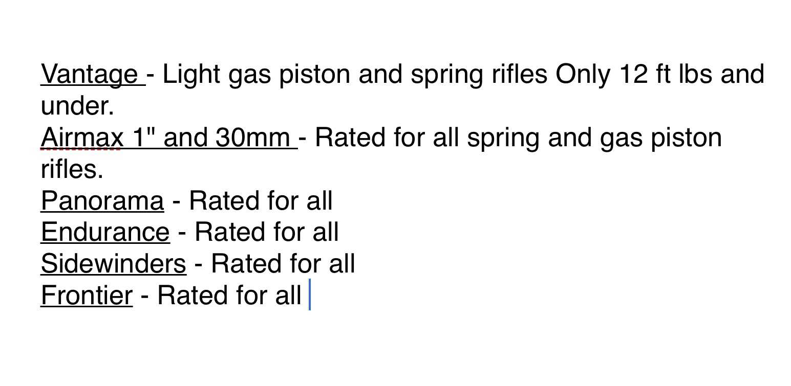

Where I read that Hawke scopes are airgun rated:
Here:
Specifically in post #6 there is a list with specific series and their springer rating:
