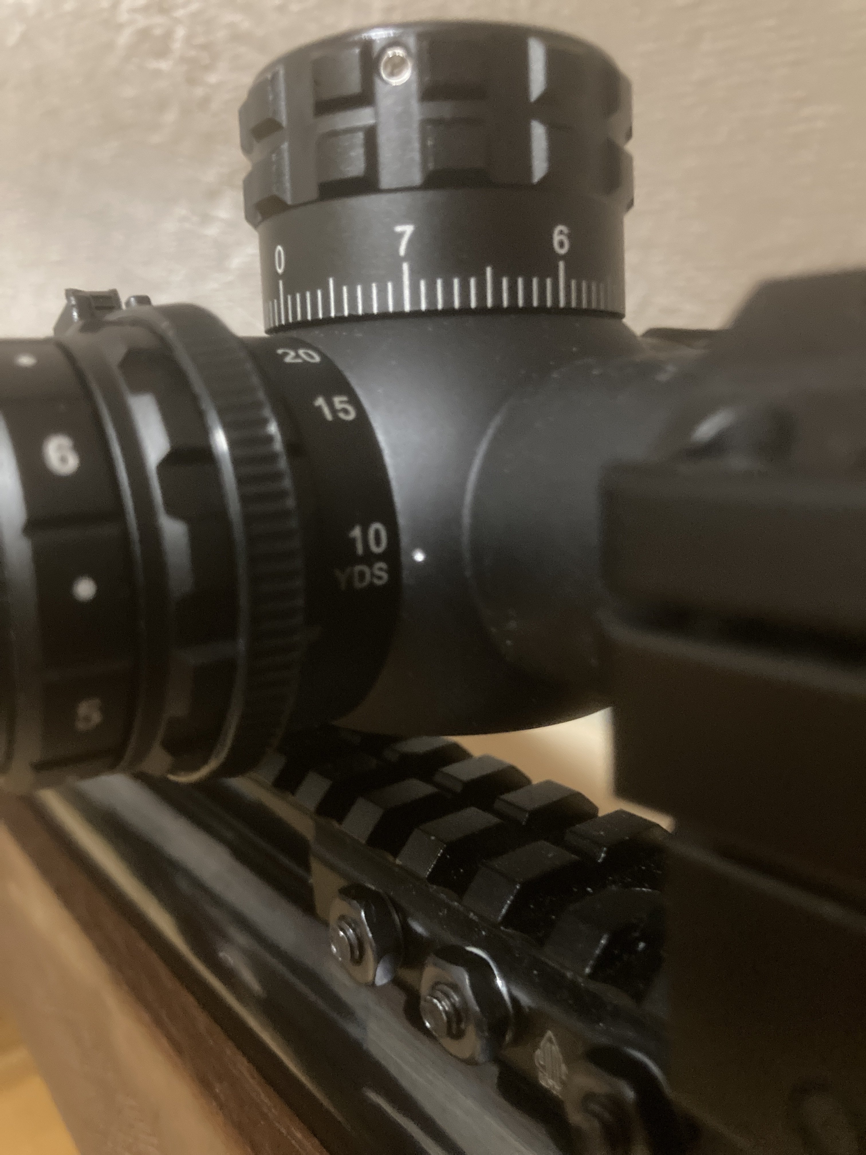

I have this scope. It does indeed focus to 10 yards. Some online retailers wrongly list it at 15 yards. Hawke website lists it at 10.
Don’t shoot field target so cannot comment on that. Pleased with the scope for my purposes.
