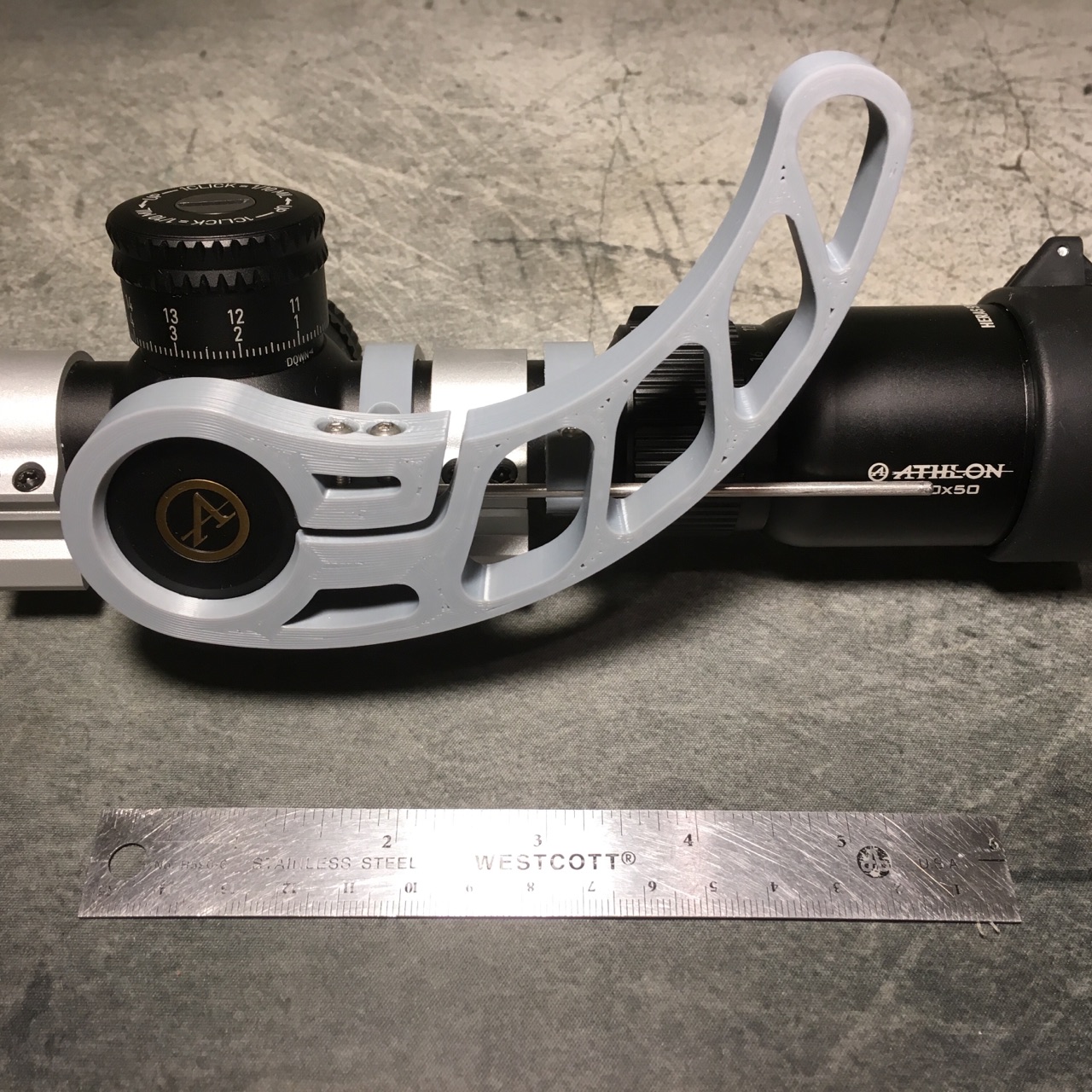

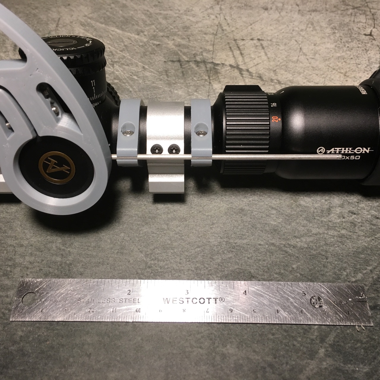

Is Wayne selling these or just for his personal use? I need one for an Athlon Argos HMR. I texted JD, but he must be busy with life.I've been producing some for Wayne at Oregon Airguns for the Athlon line of scopes (I also have some Sightron and Nikko), I think they are selling with two different pointer mounting options/and stainless steel rod pointer for around $50 (depends on if it is a pistol or rifle wheel).
They are slip over clamping style and made as long as needed/scope allows. The images are from a pistol scope set up and the double pointer mount. The wheel comes with a single (wider) cantilever mounting option for the stainless rod (if you want to have a level or just don't have the room for the two pointer mounts).
While I could make you one fairly easily/cheaply, coordinating the dimensions would be the biggest challenge (I do not have that particular scope). I'm game if you are...
I switched to the textured build plate from the smooth plate after this test print, the holes fill in fully and the face of the wheel looks a lot better. These are printed with ASA filament and are done with solid fill.
